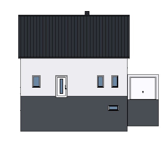

Front view of a two-storey detached house with entrance and windows, drawing

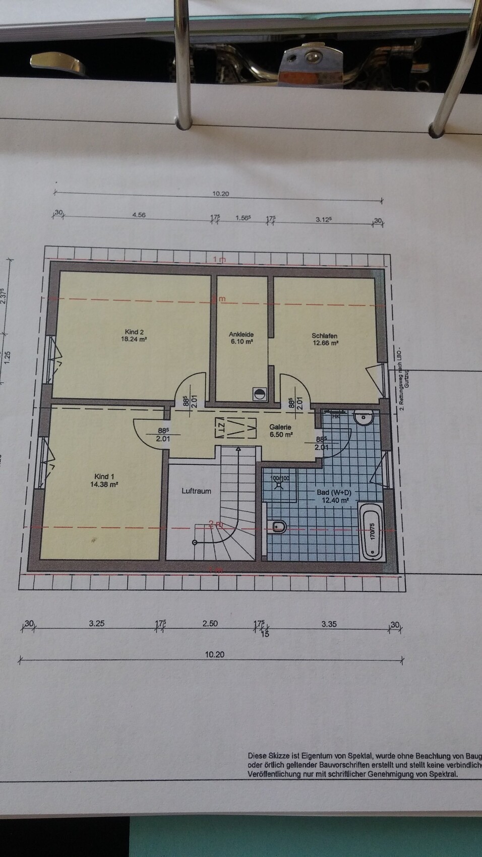

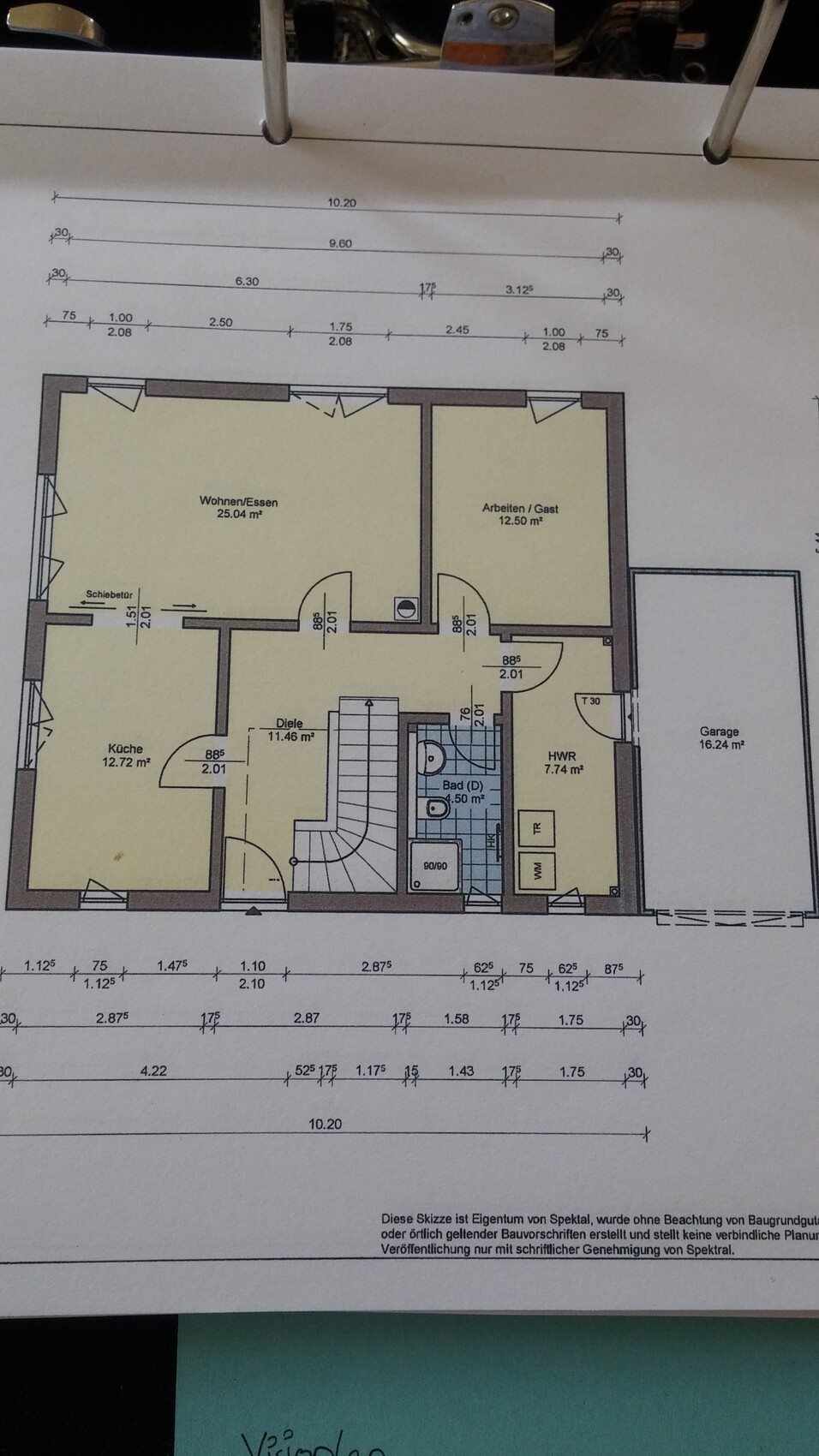

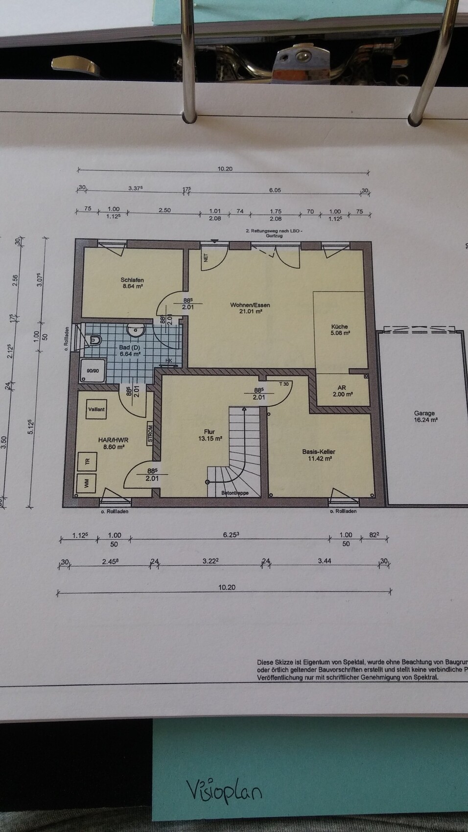

Currently, we have narrowed down our choice to two providers. A general contractor (hereafter called “S”) from Saarland building about 100 houses per year, and a small regional provider (hereafter called “G”) with about 5 houses per year.
Our gut feeling currently leans towards the smaller provider because he would also coordinate the earthworks and could start faster. Price-wise and regarding the scope of work description, they are very similar, which doesn’t make the decision any easier for us. Next week, we will visit a current construction site with provider “S.” For provider “G,” we have contact details of previous clients who built similar houses to our plan, for exchange and inspection. Maybe that will help with the decision.
I will simply post both floor plans, explain our pros and cons, and then I’m curious about your feedback. =D

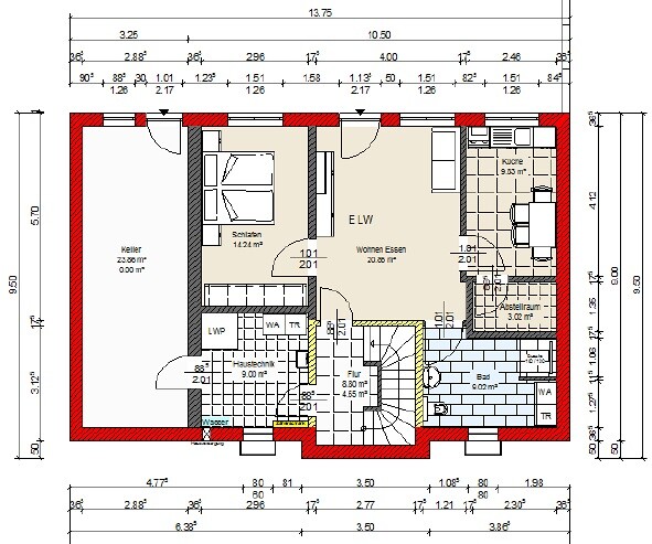

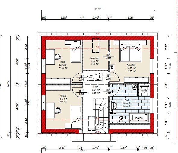

Let’s start with provider S:
+ We would have a cellar room
- This makes the granny flat very small. We imagine it might be difficult to rent out
+ L-shaped staircase instead of U-shaped staircase
+ Larger children’s rooms
+ Size of the kitchen
- Bathroom on the upper floor has an awkward shape with the corner
In the stairwell on the ground floor, we would add a narrow vertical window strip to let in more light and to avoid the wall looking so “empty” from the outside.
We’re not sure if an open stairwell has any sense or impact here...

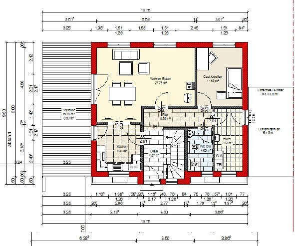

For clarity, I will post the second provider in a new post

21 Apr 2018 13:36
White detached house with dark pitched roof, terrace with furniture, garage and garden
White two-story house with terrace and glass railing; red car parked next to it.
Floor plan of a house: open living and dining area, kitchen, hallway, bathroom, entrance hall, terrace.
Floor plan of a house (upper floor): bedroom, two children’s rooms, bathroom, hallway, stairs.
Floor plan of a house with basement, bedroom, open living/dining area, kitchen and bathroom.
So, now I’m looking forward to your feedback =)
11ant21 Apr 2018 14:57
I would say: in this case, it was worth comparing apples and oranges instead of just asking G. for his price on the same design as S.
G.’s designer didn’t just put in minimal effort; I also find his design more aesthetically convincing. I’ll boldly speculate that G. employs an architect, while S. works with a draftsman.
I’ll add one more point: G. is owner-operated by a master mason. The owner himself knows how to build properly. Take that one, it feels as reliable as the one from Nordlys.
And that also applies to the planned layout here — with the single garage only on the upper level, and the storage room under the terrace. But forget the intermediate door; it’s no fun in a building-integrated garage.
