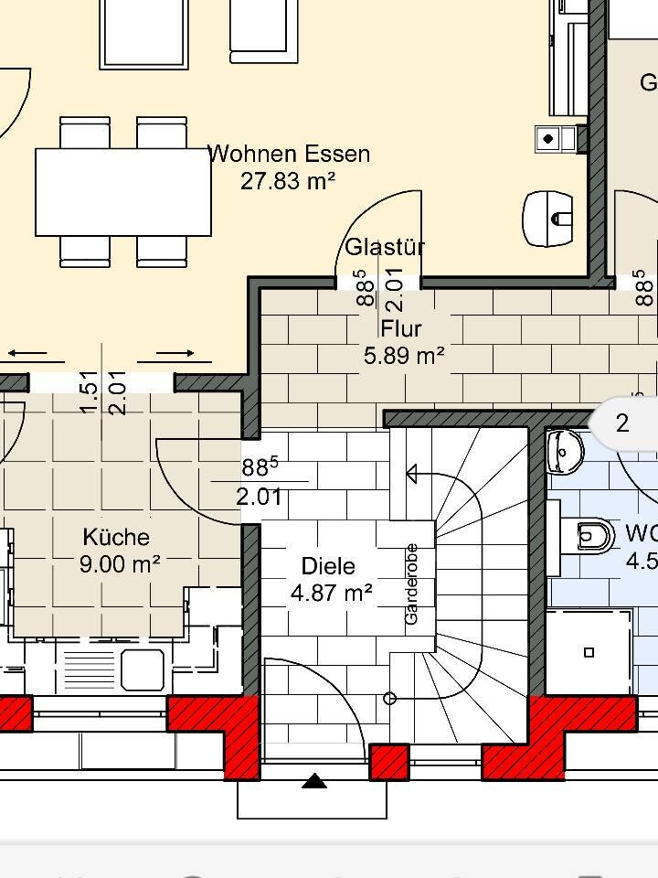

We really like the layout of the upper floor, especially that the children’s rooms are the same size; on the ground floor, we prefer the location of the kitchen and guest room compared to our own sketch (which I will also attach).
What do you dislike? Why?
Basement: That we hardly have usable basement, as the granny flat occupies the whole floor (except for the technical room); in the apartment’s living room, furniture placement is very difficult due to many doors; bathtub has to go, shower would be hard to access in this layout;
Ground floor: The large utility room (unfortunately necessary since no basement room is available, and actually a good solution for the door into the house); we would prefer an open kitchen, but it is probably not feasible with this floor plan?
For us, the biggest problem is the stairwell. On the one hand, I am not sure if the cloakroom will work for a family with children later. On the other hand, the idea of possibly having to share the stairwell with strangers (e.g., stumbling downstairs half asleep in the morning and meeting visitors to the granny flat?) is terrible for me - definitely not an option!
Cost estimate according to architect/planner: 391,000€ (KfW 55 standard, air-to-water heat pump, excluding groundwork estimated at 18,000€, painting, garage)
Personal budget limit for the house: approx. 300,000€
Preferred heating technology: geothermal (our building area requires case-by-case decision), otherwise air-to-water heat pump
If you had to give up on some details or extras
- You could do without: some square meters, especially the upper floor seems quite generous; door from garage into house is not a must, same as pantry; fireplace; granny flat
- You cannot do without: closed kitchen, very reluctant to give up the ground floor office/guest room, separate entrance for granny flat

Which wishes were implemented by the architect: door from garage into house, closed kitchen, walk-in closet, granny flat in basement (though different than expected)
Do you see any other critical points? Are we worrying about problems that aren’t really problems?
I fear we may want too much for our budget, where do you see potential savings?
I hope I haven’t forgotten any important points; feel free to ask.
Thanks in advance for reading this long post. I look forward to constructive criticism and suggestions of any kind.
PS: The slope is not as steep as it looks in the exterior views; the draftsman’s software couldn’t display it differently.

I prefer design 2.
The basement apartment has the garden. For me, having my own house with children but no direct garden access where I can also keep an eye on them is a no-go.
I don’t like the entrance situation.
You enter the door and immediately face the stairs. It doesn’t look good to me and it’s impractical. Always walking through dirt with slippers and socks.
Where is the wardrobe/coat rack anyway?
@Nordlys: Thank you very much for the quick feedback. We also find option G more visually appealing.
Unfortunately, I can’t convince my boyfriend to change the garage/laundry room door; he’s quite stubborn about it. I personally don’t really see the benefit, especially since it’s just a small single garage. But he’s convinced it adds value. It will only cost us roughly a thousand more. If it makes him happy, he can have it. XD
@haydee:
The wardrobe will probably be located in the U-shape area under the stairs. Originally, there was supposed to be a wall there. It seems to have been left out in the updated drawing. I just noticed that myself.
My brother and I also grew up without our parents having direct access to the garden. Essentially, we lived in a similar way, except that my childhood home is a true two-family house: my grandparents lived downstairs, and my parents, brother, and I lived upstairs. Later on, the downstairs apartment was rented out to others, but we still used the garden for barbecues and such. It was only recently that my parents moved downstairs themselves.
I understand your concern but, based on my own experience, it’s not really an issue for me.
The granny flat will also have its own terrace area, but not access to the entire garden.
@haydee:
haydee schrieb:
Always walking through the dirt in house shoes and socks. I don’t understand where this obsession with a mud and crumb puddle behind the front door comes from in this forum. I have a mat and a shoe scraper there, and it has worked for almost 50 years.
Julia.86 schrieb:
The coat rack will probably find its place in the U-shape of the staircase. In my opinion, that’s enough. My winter jacket is already hanging one cabinet further, it doesn’t need to take up space there in summer.
Julia.86 schrieb:
but he is convinced of the added value.. It only costs us roughly a thousand more.. No way, otherwise it would be a top-quality burglar door. And with a garage width where you can only walk beside the car without carrying anything, it’s absolutely pointless. No wolves will attack him on the eight meters (about 26 feet) outside. Men.
haydee schrieb:
Under the bottom step of the stairs, the staircase leads down to the basement.
It’s your decision. From my experience with a toddler, it’s doable but really impractical.The space for the wardrobe is planned as shown in this excerpt. Above it, on the wall between the kitchen and living room, I could also imagine a chest of drawers for shoes or similar items.I’m currently recreating the floor plan in a computer program to try furnishing it.
Hmm, I probably wouldn’t let a toddler outside alone even if the garden was directly accessible from the living room… I’d most likely still go outside with them XD
Having the stairs so close to the entrance door certainly has disadvantages, especially in winter, but I’m afraid it’s difficult to arrange it differently given the floor area.
