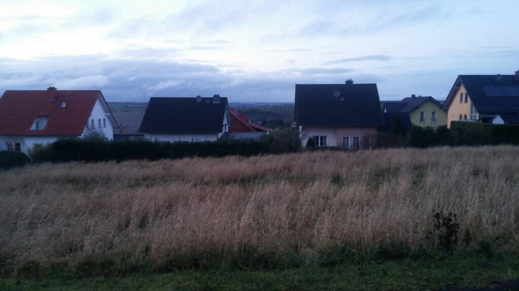

Oh dear, you’re really confusing me and making me unsure about the slope. The draftsman simply mentioned 3m (10 feet)... I assumed that referred to the entire property.
However, on two neighboring plots, there is also a house with a (pushed-out) basement.
I’m happy to repeat myself for the third time: as soon as we own the property, the first step will be to commission a soil survey with leveling.
I’m attaching two photos of the property. One taken from the street (where it looks fairly flat) and another from the lower adjacent property looking uphill (where you can clearly see the slope).
Julia.86 schrieb:
Maybe this view will help with better understanding? Certainly. That looks like only about a one-third storey slope within the building depth. I wouldn’t expect a basement living area there voluntarily. But still, a living room at the level of the garden side would be welcome. Perhaps accessible via a main entrance leading to an intermediate stair landing—that is, with the front door at what would be considered a “raised ground floor” from the garden side.
