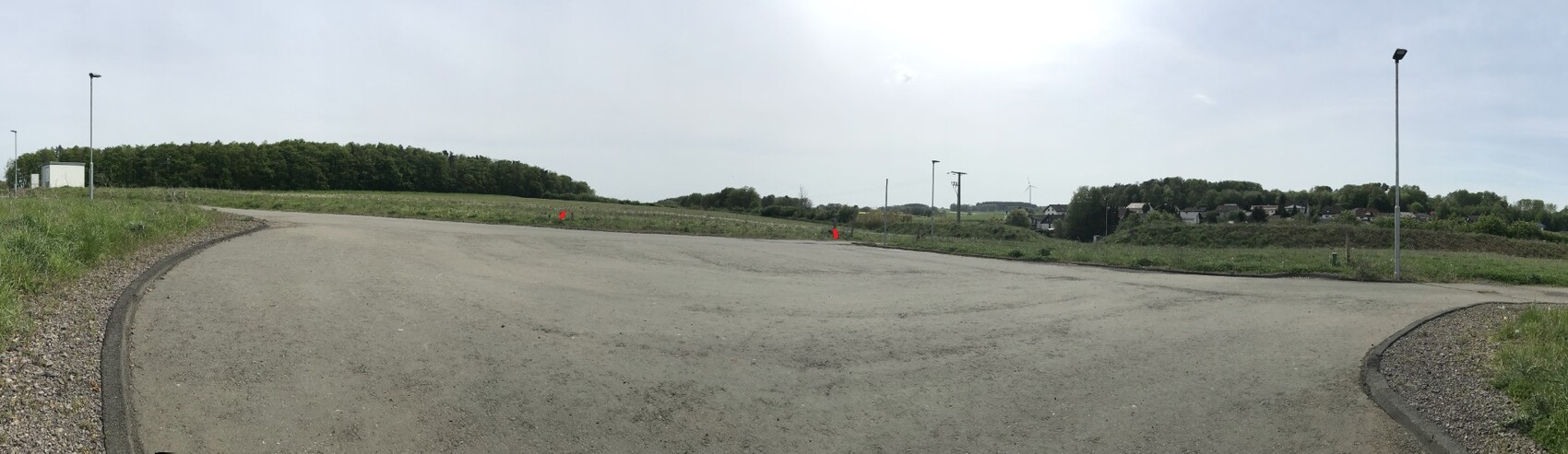

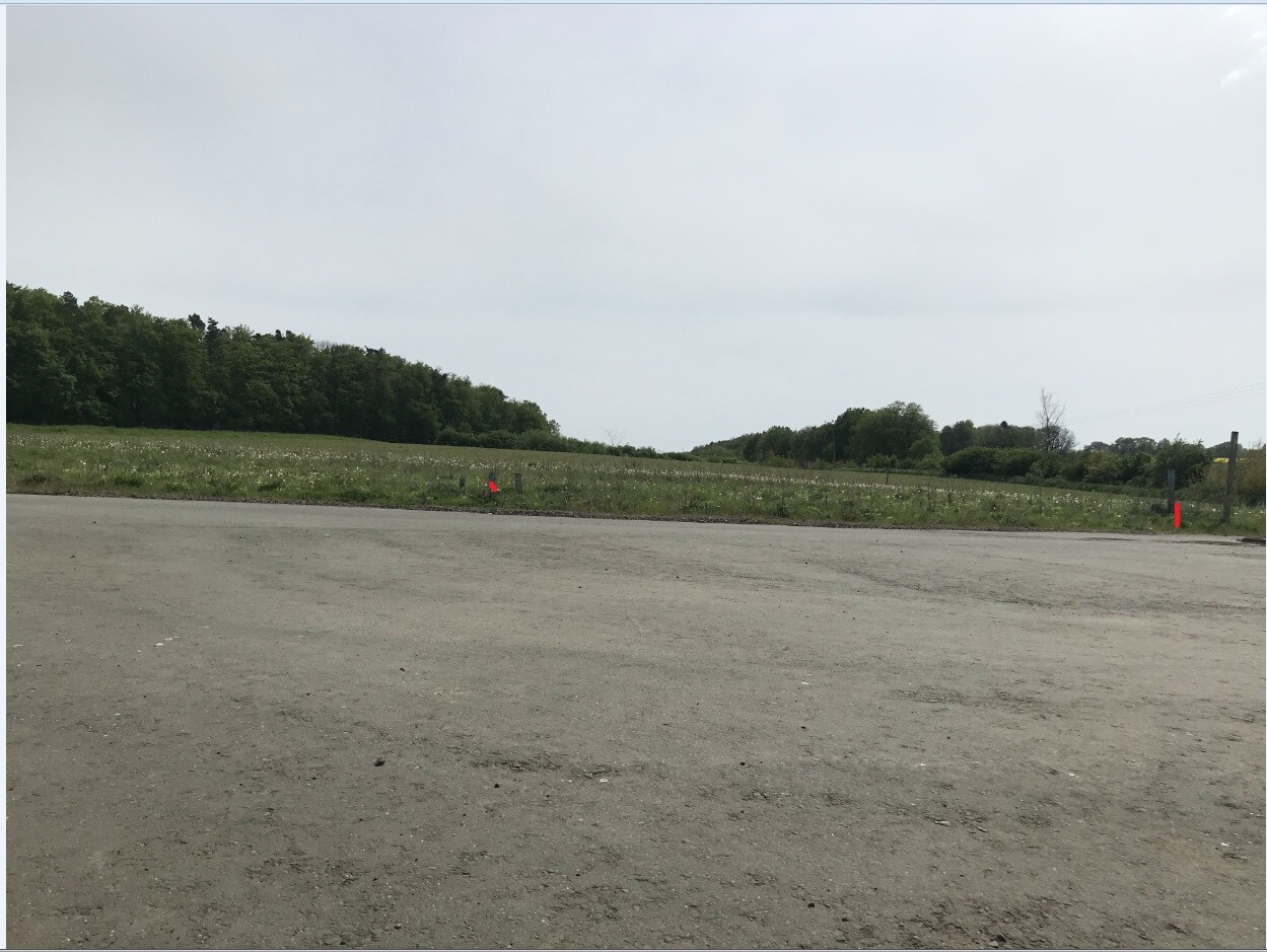

We have found a nice, vacant plot in a new development area on the edge of a forest that we could potentially purchase. However, we are still concerned about the slope. To us, it looks like a gentle slope. The plot still needs to be surveyed.
What do you think when you see the photos of the property? Would you already consider this a steep slope? Should we expect significant additional construction costs, for example for the foundation or possibly some leveling with retaining blocks?
As experts, would you buy the plot with this slope or look for a flat plot instead?
The photos of the property are attached.

I prefer not to make guesses based on photos, since my own photos tend to be taken at awkward angles. However, here’s a suggestion:

With photos, it is easy to be misled. Visually, I don’t find it steep enough for it to be an unaffordable project.
hanghaus20236 Aug 2024 16:52Based on the photos, it doesn’t look very steep. Try placing a straight edge along the property boundaries and use your phone to measure the slope. This method gives a more accurate indication than a photo. Is there no zoning plan with height restrictions?

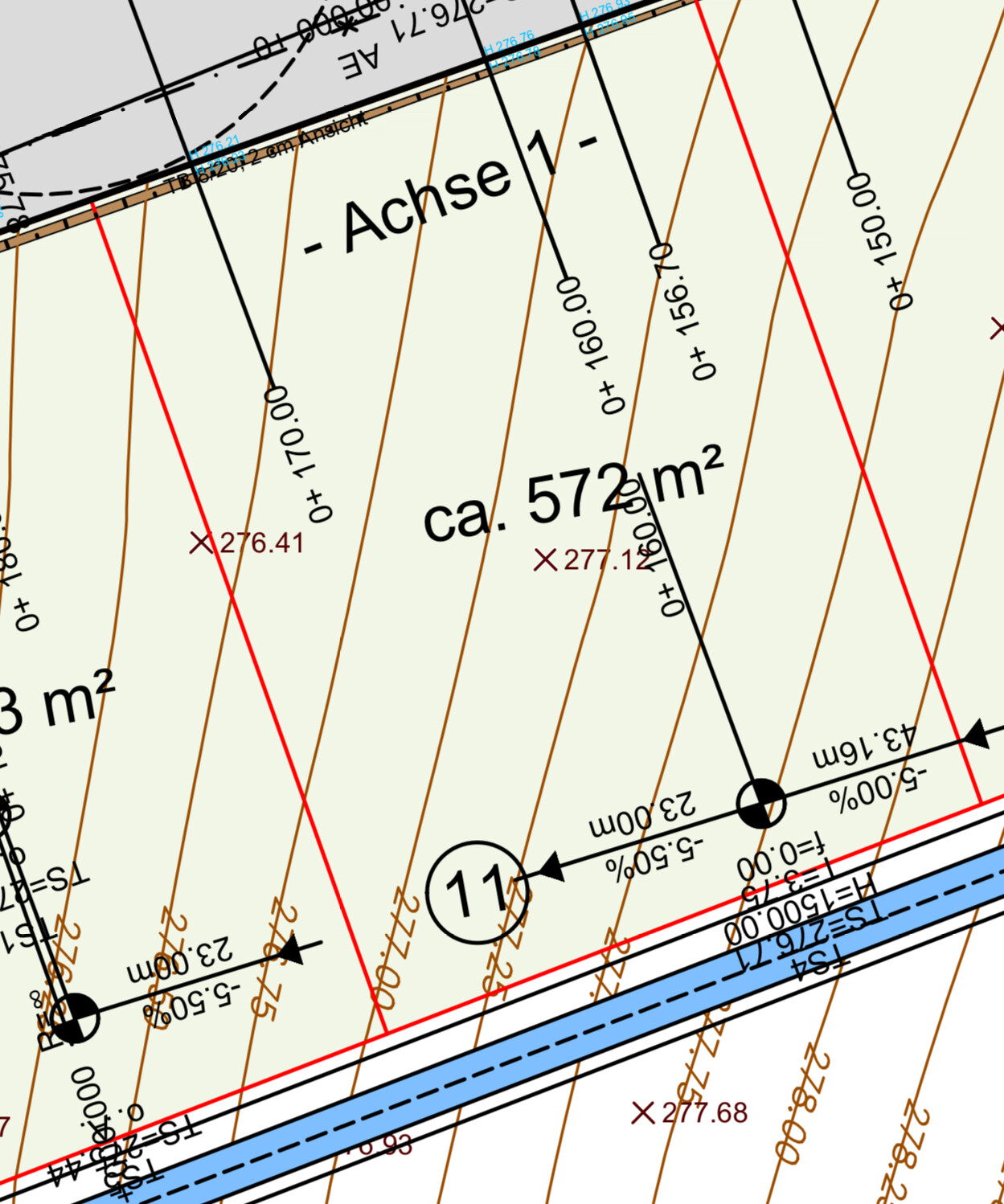

I have now finally found what I was looking for.
I have attached a section of the contour lines. I’m not entirely sure, but it seems steeper than it looks.
Am I correct in seeing that there is about a 2-meter (6.5 feet) slope indicated there?
Is that a lot or still within a "normal range"?
Thank you in advance for your answers.
