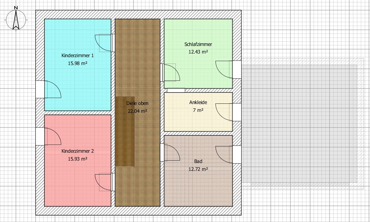

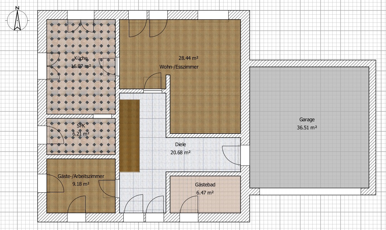

Here are some of our own floor plan experiments (2 variants of the ground floor and one upper floor) and a photo of the plot taken from the street.

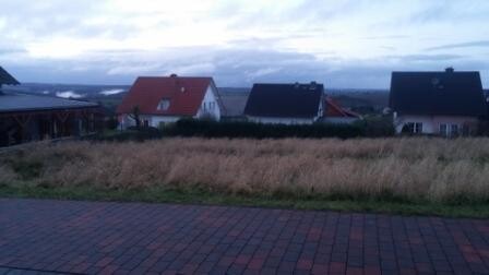

The plot is mostly north-facing, so the granny flat would get very little natural light if I’m reading this correctly. Your terrace faces west to southwest, but there doesn’t seem to be much space left between it and the fence, right? Access to the garden would essentially be through the granny flat.

The idea of the granny flat came up because of the slope of the site. A basement makes sense in this case, and we thought we might be able to create some additional living space. In our opinion, it wouldn’t necessarily need to be fully finished right away, but the utility connections should be planned and installed from the start.
At the moment, the mother-in-law is quite fit but lives in a very old house without central heating. She wants to stay there for now. However, we could imagine that she might change her mind if she can no longer manage the stairs carrying oil cans for the stove. Of course, we could only provide limited care ourselves since my partner and I both work full time.
Otherwise, renting out the space is also something we could consider. In that case, however, using the main staircase would be impossible for us.
The orientation is indeed mainly toward the north. For that reason, the planner designed the terrace on the side, which we still find hard to visualize. We need to go onto the property with a tape measure and check how it relates to the neighboring lot.
We are also still figuring out the garden access...

The plans suggest that the street is located to the south or southeast. This orientation is rather unfavorable for bright rooms given your hillside location. Additionally, on the south side, you have a hallway, WC, utility room, and kitchen—basically rooms where sunlight is not essential or where privacy is a priority.

The ground floor wouldn’t work for me either. The utility room is too far from the kitchen, and the kitchen itself is too small to fit everything. We have the exact same size, and I store many items in the dining hallway because otherwise, there is no room to work in the kitchen (baking supplies, microwave, storage cabinets for electrical appliances like a deep fryer, pantry items, etc.). The floor-to-ceiling window in the kitchen is nice for access to the terrace but takes up a lot of usable space. The path through the dining area is only about half a meter farther, so I would carefully consider whether it’s worth it. Your living room also offers little space to arrange furniture, and the seating distance from the TV is far too large for me (4 meters maximum). Furthermore, the table actually obstructs the flow, as it must be placed somewhere near the doors to the terrace, the hallway, or the kitchen. I don’t know if that’s an issue for you, but hosting a longer dining table for birthdays is very difficult in this layout. The recess towards the study or utility room is wasted space and creates an awkward corner in the central room.
Using the utility room as a passageway to the garage isn’t bad because groceries can be easily unloaded there, but of course, that also reduces usable space. If it’s also meant for vacuum cleaner storage and general storage, it will be tight. Moreover, you won’t always get out of the car with dry feet. Without dedicated space for shoes there, dirt will be carried into the utility room and even into the living room since you don’t enter directly into the hallway.
Upstairs: For me, the bedroom is too large, especially with an additional walk-in closet of 7m² (about 75 sq ft), which is rather generous—bigger than the guest bathroom. Why do you need so much closet space in the bedroom? I would carefully plan the bathroom to see if it really meets your needs. The shower will probably be larger, but a double sink is unlikely to fit. Storage space and cabinets will be difficult, too. You may need this because although you have plenty of hallway space, there is no opportunity to place a wardrobe or dresser there. The children’s rooms are a good size, but the doors prevent placing a 3m (10 ft) wardrobe in either room. I would design the staircase so that the stairs rise along the exterior wall, not in the center. This would give you more space in the upstairs hallway, shorten the route from the ground floor upstairs (even if only by a few steps), and create the possibility of a closet or storage room in the basement at that location.
Your own drafts don’t appeal to me either. The upstairs hallway has a lot of unused space. The entrances to the children’s rooms will not work well. On the ground floor, you have planned two awful living rooms and squeezed in a narrow stylish wall, including a fireplace. Where does the chimney actually go upstairs? In one draft, the pantry is very far from the garage, and the only terrace access is through the kitchen (which would be inconvenient with guests); plus the living room is in the northeast, so it gets no sun, while the hallway takes up a large amount of space. In the other draft, the pantry is quite small because it has three doors, leaving almost no storage space. The hallway requires a lot of space, and the access to the guest bathroom is blocked by the shoe cabinet/wardrobe? You are also not yet decided on the design of your open-plan kitchen/living area, so you have initially allocated a large number of square meters. You can poorly design 20m² (215 sq ft) or create a functional open kitchen/living space on only 13m² (140 sq ft). Think carefully about this, as well as the bathroom, what your priorities are. A 9m² (97 sq ft) room for an office or guest room is too small. You can make an office work if you don’t use it daily. A guest room can be squeezed in somehow, but a space that serves both functions is not possible. Even a double air mattress requires 4m² (43 sq ft). If a desk and a small shelf are also in there, no walking space remains, nor could the door be opened properly.
