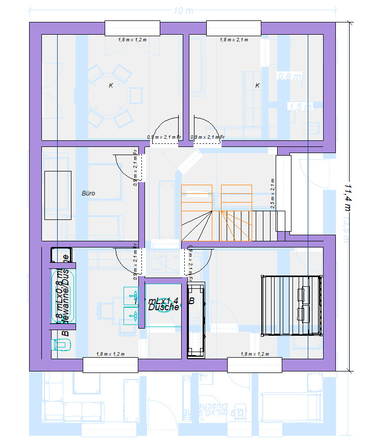

Here is one more option. It includes a setback, but slightly smaller. I haven’t yet calculated how this will work with the single-story design. That’s for the planner to figure out. In any case, there will be a knee wall of 1.50 m (5 feet) and another setback in the staircase area to create a spectacular play of light. Plus the cozy nook at the top, which seems to be a heartfelt wish. The carport issue, however, remains tricky.
The house is completely inaccessible with an occupied carport because the car blocks the entrance door. I'll take that as an answer to my question: so it wasn’t an architect without quotation marks after all.

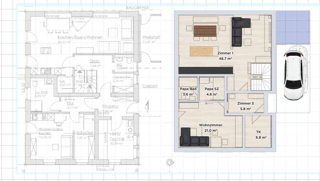

hanghaus2023 schrieb:
Even though my design is much smaller [...], the usable rooms are larger. The masons will probably get less corner premium this time ;-)
Maybe a quick floor plan quality check for all self-planners: as a first indicator, simply mark in red all places where a wall changes direction after less than 2m (6.5 feet).
@ypg even though my design is much smaller (135m2/112.5m2), the usable rooms are larger.I don’t know what measurements your software shows you, but for me it looks close to 90sqm (970 sq ft). Could it be that the workshop/carport was included in your calculation? As a reference, I used the 13.5 (meters) from the original plan on the left.
But putting that aside: everyone here has their own experiences and opinions, which some share openly. In many areas we often see eye to eye, especially when it comes to criticism. Mistakes are quickly spotted. However, they are rarely fully resolved without creating another bottleneck elsewhere.
Compromises usually have to be made in any house design. Different priorities play a big role for each person. Those with three children will at least prioritize a second shower, others have hobbies they want to continue at home. Wellness enthusiasts will emphasize a bathroom, while others prefer a dressing room just for themselves.
Many want to move downstairs when they get older and think they’ll be happy with a 4sqm (43 sq ft) shower-WC plus an 8sqm (86 sq ft) office. That is often rightly criticized. Personally, I don’t believe it’s wise to base all compromises on priorities for old age when just starting a family. There are often 40 or 50 years in between, possibly a job change, two divorces, three illnesses, four weddings, and five grandchildren 😉
In this case, there is a granny flat, which is not only due to funding but also necessary because of the family’s situation. Without it, this house project wouldn’t happen. But when I see something like a barrier-reduced design with rooms where you can lean on almost all walls at once so you don’t need a walking stick anymore, I have to criticize that. I don’t think the original poster resents his dad enough to build these sleeping and washing holes for him. A small alcove bed might be nice for children or on holiday—or in a pinch for students—but it has nothing to do with age-appropriate living.
I bet if someone else brings a plan with those dimensions soon, it will rightly be criticized here.
The same applies, by the way, to the direct view of the sofa when entering the main apartment and the view of the stairs from the living room. Or the sofa’s proximity to the cloakroom, which—even for disciplined adults—is often used more quickly as a place to drop scarves and such before even opening the closet door. The toilet under the stairs is more a makeshift solution in an existing building than a smart new-build idea. However, the idea to also use the connecting hallway makes sense.

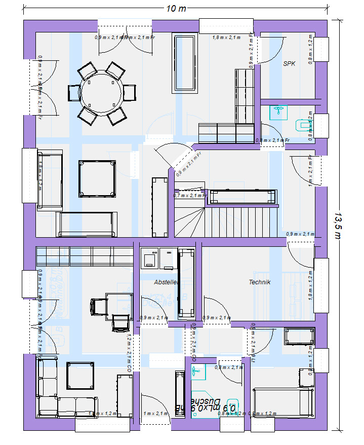

BucheOnBoard schrieb:
Space needs in the attic: 2x “retreats” for adults; if necessary, we’ll just store a rocking chair with reading lamp and a sewing machine on one side and a gaming PC on the other.Now about the finished attic: I also believe by now (unless someone comes up with a truly innovative design) that it’s better to skip the attic expansion instead of using the entire ground floor area in the attic. This is because you @BucheOnBoard want to create a retreat in the loft. Think again. Your child is one year old, maybe a second one is coming. How do you imagine having a retreat when you actually need to be close to your child? Eventually, the child goes to bed in the evening and then you can chill. You probably won’t want to go all the way upstairs but stay down with a drink before heading to your own bedroom. And yes, the bedroom is also a retreat—but a much more comfortable one. Alternatively, you could make the office/guest room also a cozy space for yourself.
If that’s not enough, you can still create another room by using the attic’s floor area. Maybe a nice dormer on the south side is still affordable, where you can place your armchair with a floor lamp and a wardrobe to store the sewing machine?
Ultimately, you wanted a basement. It turned out too expensive.
Let’s see:
Space needs in the basement (access via a shared hallway + additional external entrance): technical room/mechanical room with heat pump, ventilation, electrical distribution, inverter, server; wood workshop; laundry room; 2 hobby cellars for large collections—Lego and beer cans, no kink-shaming please 😉, 1 “storage” for decorations, suitcases, camping gear, etc. So it needs to be heated (and ventilated), but simple tiled flooring and surface mounted installations are fine.I see the attic more as a basement replacement room. Initially as storage and then for your collections. But I warn you, for that, you'll hardly have any time left 😉
Carport/roof overhang right at the building would be good, but mostly for bicycles and (in the medium term) for an electric car.…BucheOnBoard schrieb:
with the wish for both parents (me + wife) to have their own room, which is neither the kitchen nor the home office—a room you don’t have to tidy, and whose door you can slam when needed.Your own room would be the bedroom—with a door to slam.
I think it’s clear roughly where this is going: a clear layout for the granny flat, at least 30sqm (320 sq ft) for funding, no hallway needed but some space to move around furniture without tripping over. Shared hallway, also serving as a shared cloakroom. Small additional coat storage for the main apartment in case it is rented out later. (I still advise keeping the technical equipment in the north side, including the granny flat bathroom.) One stairway leading firmly to the attic, which should provide at least storage space. On the upper floor, a multipurpose room separated from the children’s rooms, so the good Singer sewing machine can dance late into the evening. And anyone building in Iserbrook should get used to a roof pitch of at least 48 degrees 🙂

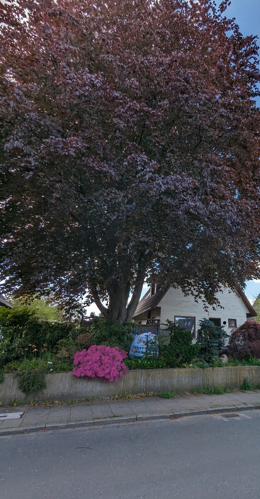

The beech tree is actually the main reason for the setback: otherwise, the crown would be very close and annual pruning would be necessary since there is hardly any space for the yearly growth. We had suggested that a bay window (or at least a projection not spanning the entire width of the house) would be quite practical for that. What came out of it, however, was more or less a “clumsy chopping off of the upper floor” – which additionally doesn’t work because the southeast corner ends up too close to the trunk. We discussed this again yesterday with “our” arborist, who assumes that it wouldn’t be approved like this or that the tree care requirements would be exorbitantly demanding. He advised us to leave the existing basement walls standing in that corner (the existing house has a basement in the front half, although very damp and low) and to build no more than 11 meters (36 feet) on the south side, while also considering the workspace needed to protect the roots. The north side could then of course be longer, but that would make the building more complex and thus tend to increase the cost. I attached a photo showing the beech tree’s size as seen from the street.

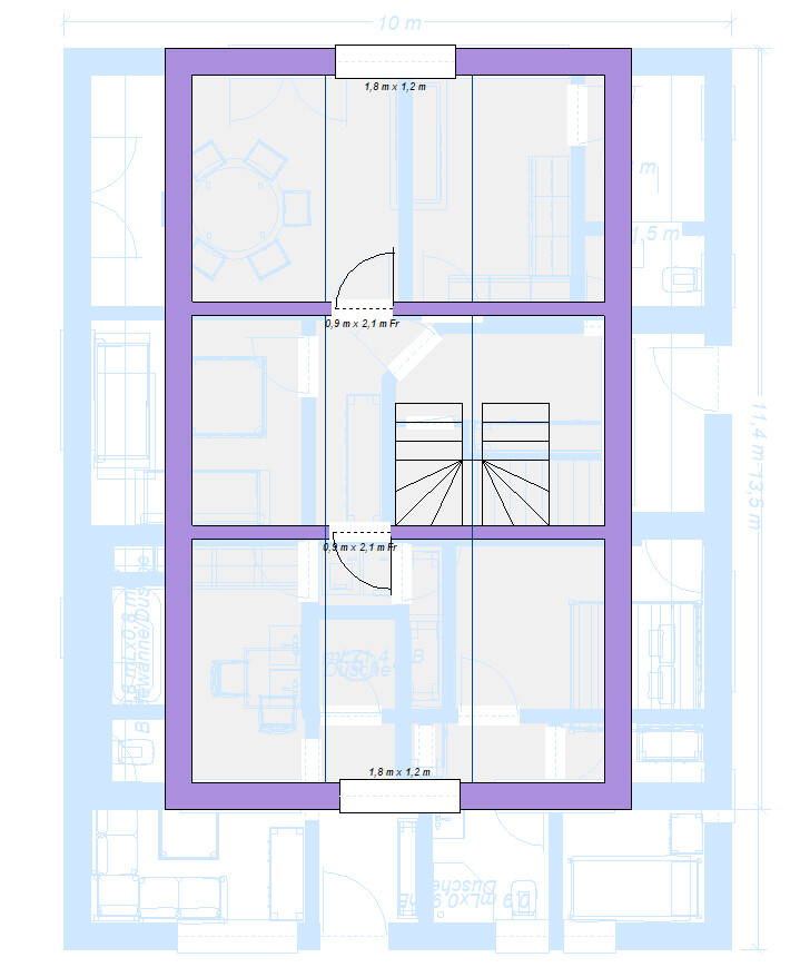

Apart from that, @ypg wrote very nicely in her last post: The granny flat / secondary unit is not just for funding purposes; someone should actually live there. Unfortunately, people mostly want peace and don’t want to get involved in the construction process, but space in the bathroom and around the bed is important, while there will be no sofa in the granny flat. We would also very much like to avoid a staircase in the open living area...
Resulting from the necessary “bay window” / “extension,” we then thought that the additional square meters counted for the floor area ratio could be well invested in increasing the knee wall height – which would benefit both the upper floor and the attic as a cellar replacement. And an attic with 3.20 meters (10.5 feet) from floor to ceiling (yes, of course only exactly in the middle) is definitely a nice room. I think so. I stand by that. So it will be developed; in both of the preferred builders’ plans, the whole roof would be insulated anyway, and from the inside, it would be closed off with electricity and a (simple) floor installed. My heart is not attached to a huge staircase leading up there but it should be more than just a space-saving staircase with alternating steps. How much time we will actually have to use it, I don’t know, and maybe it will remain a place of longing and just be used for storage. But without a basement, we do need that space somehow.

So, it’s an architect without quotation marks, and yes, we’re not happy with that either and have the same “quotation marks” feeling – all the rooms we want are there, but somehow they’re just lined up next to each other, resulting in large hallway areas or similar. That the living room part of the open space ends up narrower than it is now, is obviously not what you dream of when building a new house, especially when the architect has already sat in that very living room. For example, the front terrace being drawn into the beech tree is actually a minor issue, but it doesn’t exactly boost the mood either. We did communicate that no car is supposed to be parked in the carport but maybe one day an electric car would be charged there, so I definitely wouldn’t base the “quotation marks” on that.
And the plan for the demolition/new build phase is actually a temporary rental solution, either a house or an apartment. It’s budgeted (relatively) generously for construction, because, well, Hamburg...
And I hope to somehow get all of this into a sketch tomorrow...
but this is just the first draft after all … and you shouldn’t choose the first one.
Tell the architect what you don’t like. In their fee estimate, they will usually include several revisions.
Maybe a better design will be proposed later?!

The beech: I already thought that the recess has something to do with it.
