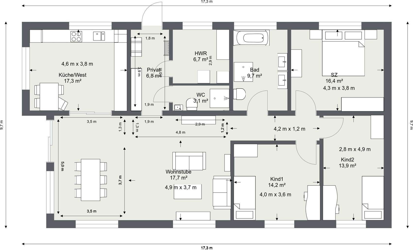

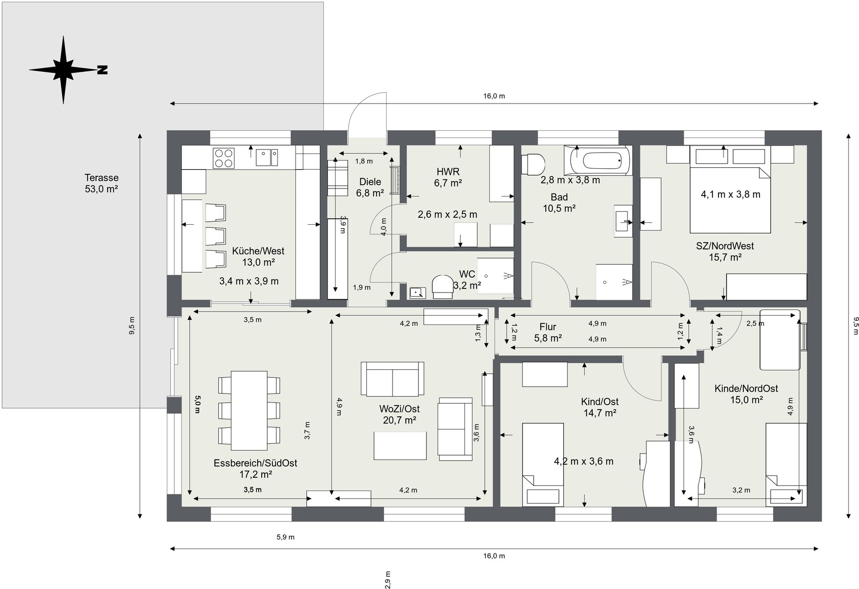

we have finalized the floor plan for our project and tried to incorporate feedback/criticism from the previous thread. A new thread was also necessary to include relevant information in the initial post.

A third mistake to avoid, which you are making here, is having straight exterior edges. On one hand, it’s reasonable to skip decorative indirect cores as unnecessary frills. On the other hand, rigidly having straight exterior walls is equally unfavorable and, just like the “square by principle,” it forces rooms into individually unfavorable width-to-depth ratios solely to achieve an overall “clean rectangle.” Try sizing all rooms “optimally” regardless of whether their exterior walls line up perfectly.We simply have certain requirements (location of the single-family house on the plot and budget) that guide us. Or am I being too critical about the additional costs? Ultimately, the roof will probably be the deciding factor for the extra price.
We can likely agree on the following floor plan.
This is about the layout only for now:
- Entrance/utility room/wet rooms facing the access path/house connection
- Kitchen closed off but with a large opening (sliding door or similar)
- Kitchen on the west side but with a view of the access path; there should be enough natural light
- Optimal room sizes
- Hallway/foyer sized efficiently
- Living area allows for lots of design options
@micric3
Although I'm not a specialist in floor plans or interior design, the toilet in the guest bathroom might look better placed on the wall to the left, facing the kitchen. Sitting there, the wall is very close to your head.
In the master bathroom, the shower could be placed behind the door, the toilet next to the bathtub, depending on the available space in the alcove, and the two washbasins on the left side of the plan.
