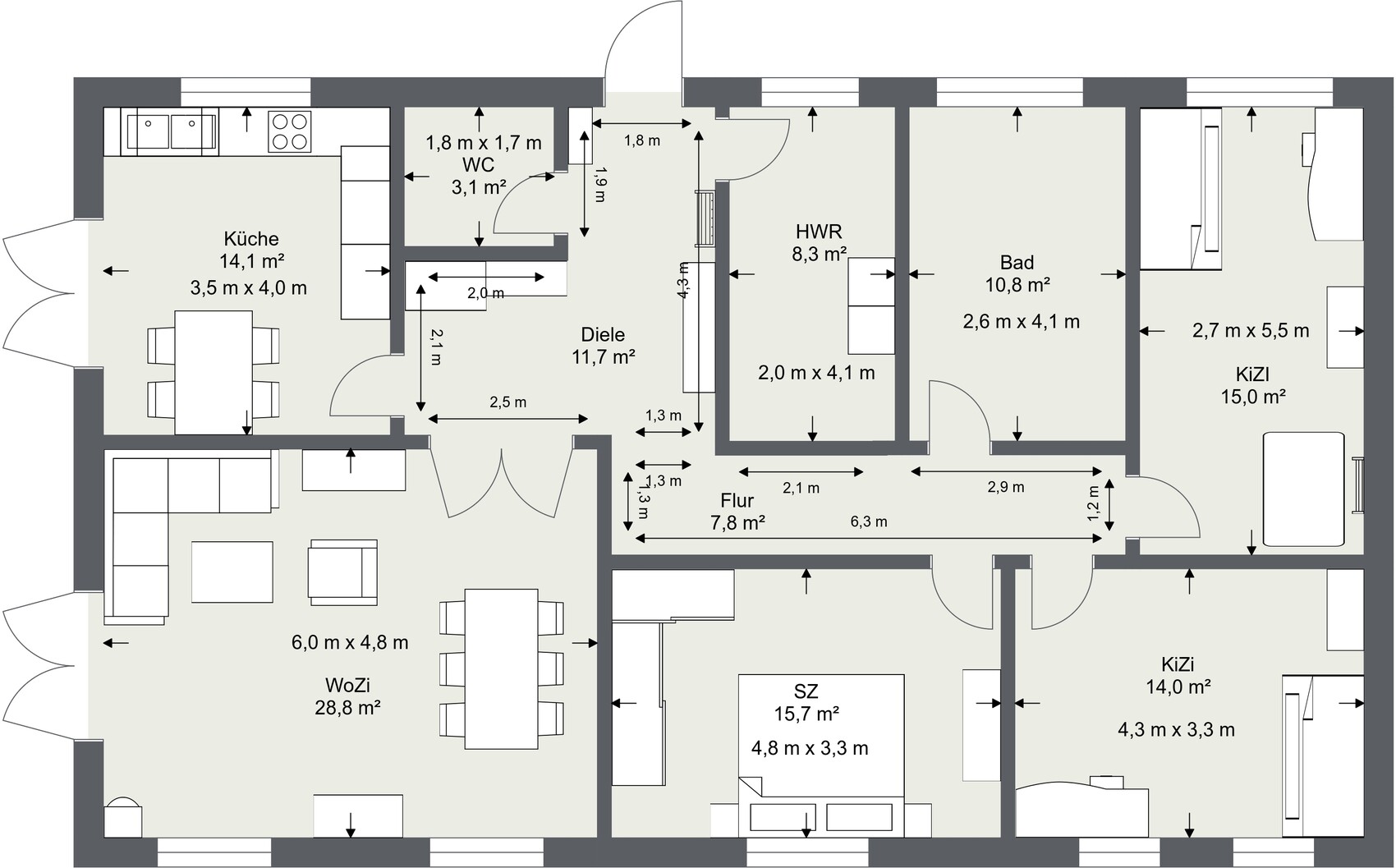

After consulting with the general contractor and my wife about practicality and potential costs, we will not implement the original plan as is. In other words, a redesign is needed.
- Since the site access over 40m (130 feet) is already expensive, we plan to place the entrance (shown in the upper plan) on the west side, where the access is also located.
- My wife would prefer a (closed) kitchen to cook in peace.
- The fireplace planned as a room divider will be replaced with a wood-burning stove.

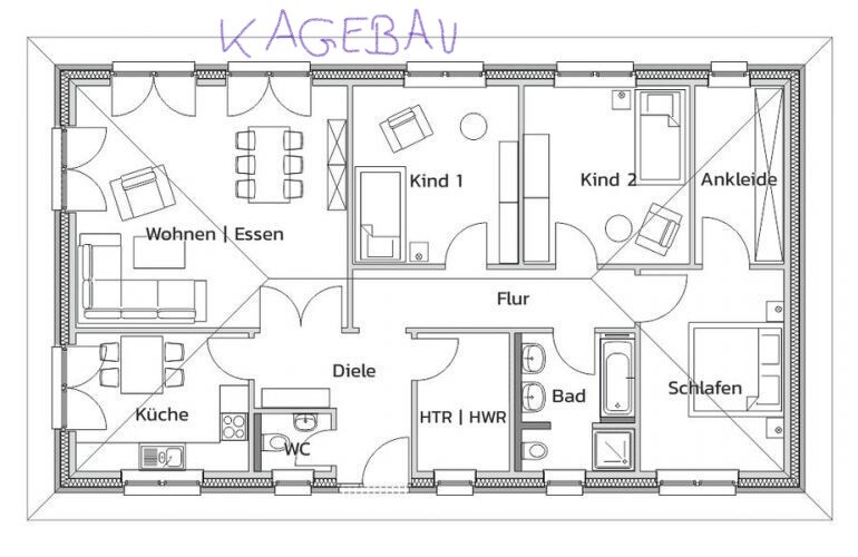

Ultimately, the template from "Kagenbau Lifetime" served as the basis for the current floor plan draft.
Current furniture in original size. Arrangement partially random.
I would even consider increasing the length from 16m (52.5 feet) to 17m (55.8 feet) if that seems beneficial.
Please provide feedback.
Attachment 1: Kagebau Lifetime template
Attachment 2: current floor plan RoomSketcher

Ultimately, I used the “Kagenbau Lifetime” plan as a basis for the current floor plan draft.I thought you wanted to build with Town & Country, so you took their floor plan as a reference??? ops:

@ypg: We still want to build with Town & Country. My preliminary meeting on Monday was very pleasant. I only used the floor plan from Kagebau as a basis; the exterior dimensions of the Town & Country bungalow will remain unchanged.

Unfortunately, the dimensions are not provided, but visually, I would say that both dining tables and their seating arrangements are spaced too closely and, with the indicated chair distances, are only suitable for residents up to size 36 (clothing size).
micric3 schrieb:No, it does not. Two extremes should be avoided in floor plans: the square shape and the linear form. In this sense, more depth would probably be better here than more width. A third mistake to avoid, which you are making here, is straight exterior walls. On the one hand, it is good to save on decorative details as unnecessary embellishments. On the other hand, strictly straight outer walls are equally disadvantageous and, just like a “square by default,” force rooms into individually unfavorable width-depth proportions simply to achieve a “clean rectangle” overall. Try dimensioning all rooms “optimally” regardless of whether their exterior walls would then align perfectly.
I would even be inclined to increase the length from 16m to 17m if that seemed advantageous.
micric3 schrieb:Ordering an Opel specifically at Ford – I have not yet understood the reasoning behind that.
We still want to build with Town & Country. [...] I just based the layout on the plan from Kagebau,
