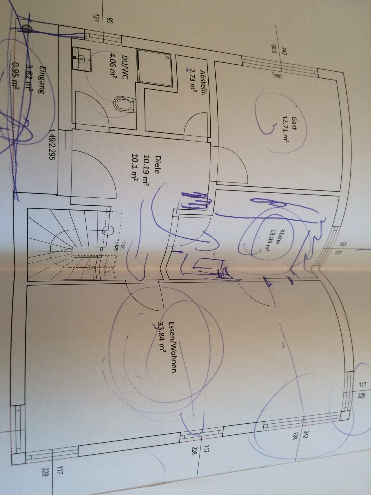

We have now also received a potential floor plan from the second provider we are in talks with. In terms of living area, there is practically no difference, and financially we are in a comparable range overall.
We would now like to hear your opinions.
This option definitely includes a basement, with the utility room and technical installations planned for the basement level.
What we really like about this design is that the kitchen is larger, and I think we could realize my dream of having a table there. It is also worth considering that the guest room is just under 13 m² (140 sq ft), but since we do not have guests very often, it might be possible to allocate 2 m² (22 sq ft) from this room to the kitchen if the building structure allows.
A storage room of about 3 m² (32 sq ft) on the ground floor is certainly practical, but we are not sure if we necessarily need it on the main level if there is a basement. This also raises the question of whether this space could be better organized in another way, for example by enlarging the entrance hallway.
The hallway is measured at 10 m² (108 sq ft), which seems quite small to us.
Regarding the upper floor: the room sizes and the bathroom size are basically acceptable. However, the office seems very small to me, with knee wall height (kniestock) at 1.40 m (4.6 ft) in this option. As a teacher, I spend a considerable amount of time in the office and have quite a bit of equipment that needs space. A floor-to-ceiling shelf, a large desk, and a proper chair are essential. I wonder if this is feasible in this size?

16 May 2016 16:39
Mizit schrieb:
A storage room of just under 3 m² (32 ft²) on the ground floor is certainly practical, but we are not sure whether we really need it on the ground floor if there is a basement.
It is not very practical to have no storage space on the ground floor or the upper floor.
A broom is needed several times a day, laundry should be done where it occurs, and beverage crates are rarely carried down to the basement since people drink liquids regularly throughout the day.
I don’t see a space for a coat rack at all.
I don’t find the floor plan bad, but if I were you, I would think more about your other habits instead of planning everything just around the kitchen table. Often, extra rooms—such as guest rooms and offices—end up being converted into storage rooms, and then only miscellaneous items are stored in the basement, unless it is also used for hobbies or similar purposes.
