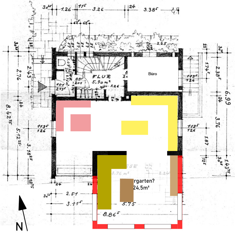

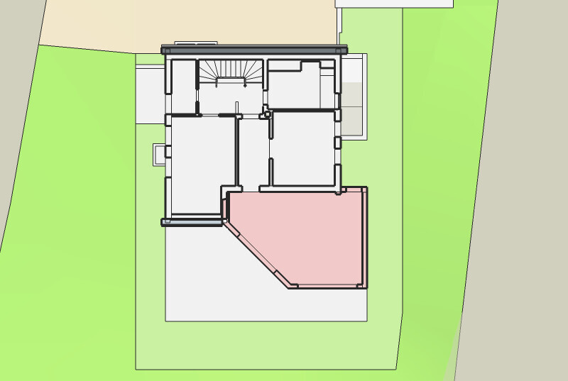

we are planning to replace the existing conservatory at our house with a new extension in the medium term. We already have some ideas but still have some time. However, we want to keep the goal in mind in order to complete necessary preliminary work or avoid blocking future options.
For the introduction, I am using the questionnaire for standard floor plan planning as far as possible, although many answers naturally reflect the current situation:
Order: basement, ground floor, upper floor, cross-section

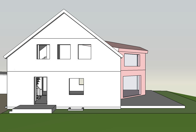

Exterior views:

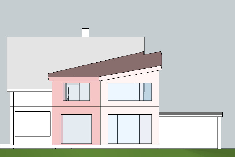

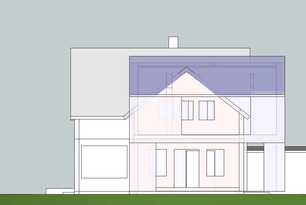

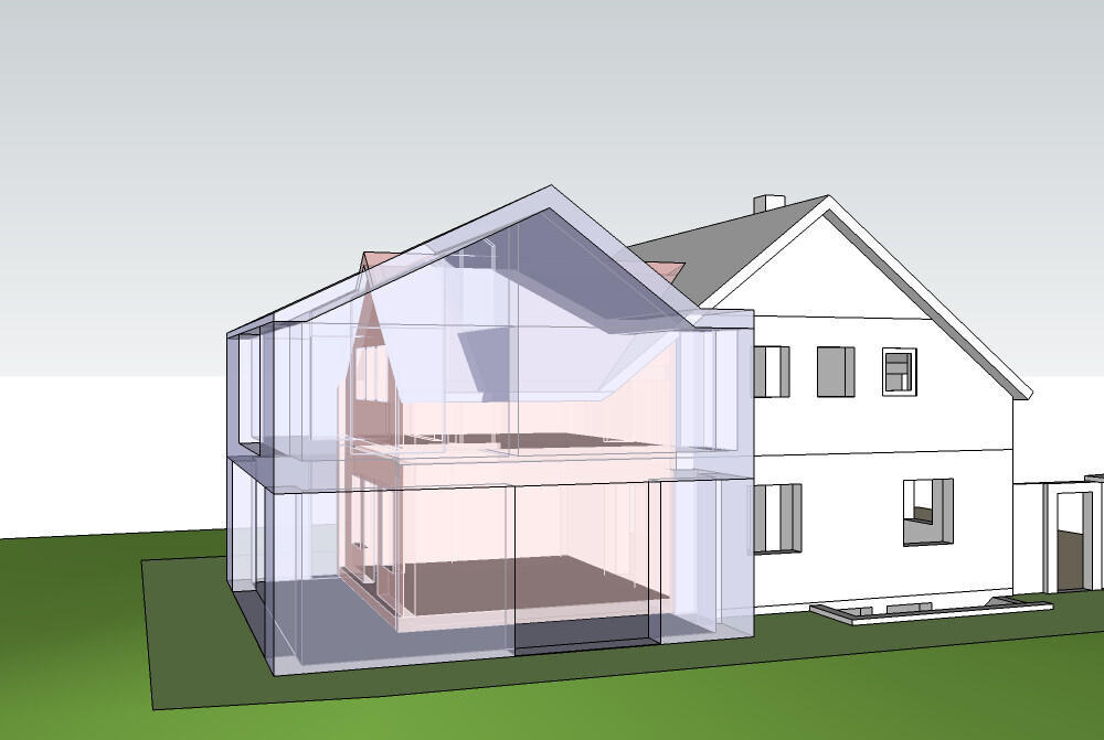

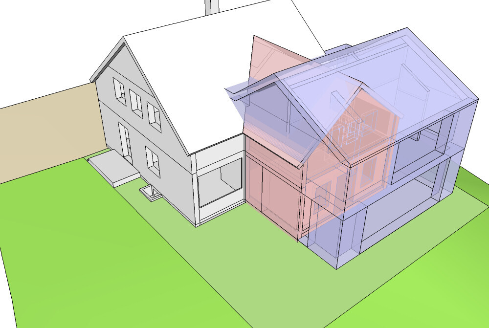

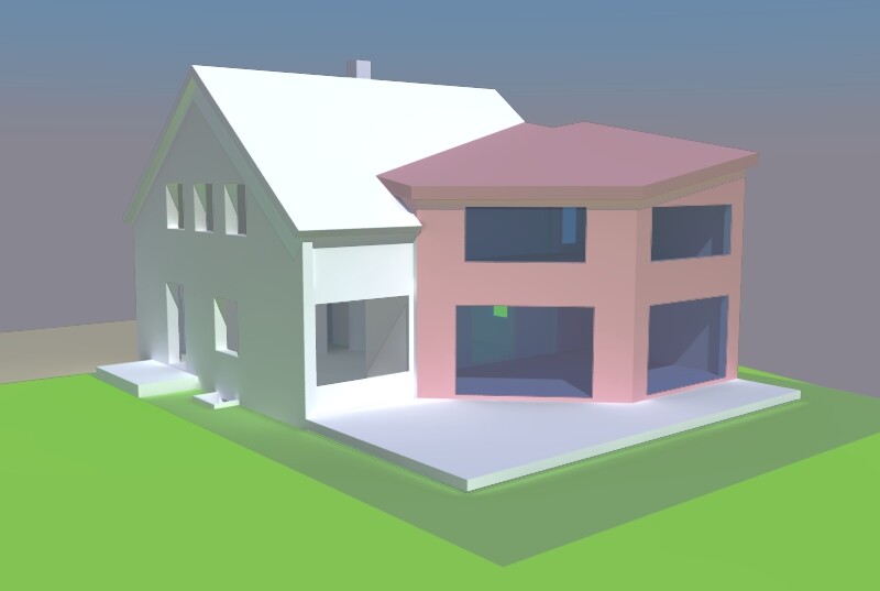

3D drawing comparing original (with old terrace) and conservatory extension (including new terrace):
(dark green lawn = building window)
As mentioned at the beginning, we are planning to replace the conservatory with a better solution in the medium term.
The goal is to have a room serving a similar function: a bright room with a nice view of the garden, for example through large lift-and-slide doors. However, it should also meet the requirements of a living space (proper thermal insulation, solid walls instead of aluminum frames, adequate heating, tight roof).
We are still uncertain about some fundamental aspects:
Option 1:
Option 2:
(Image in next post)
Option 3:

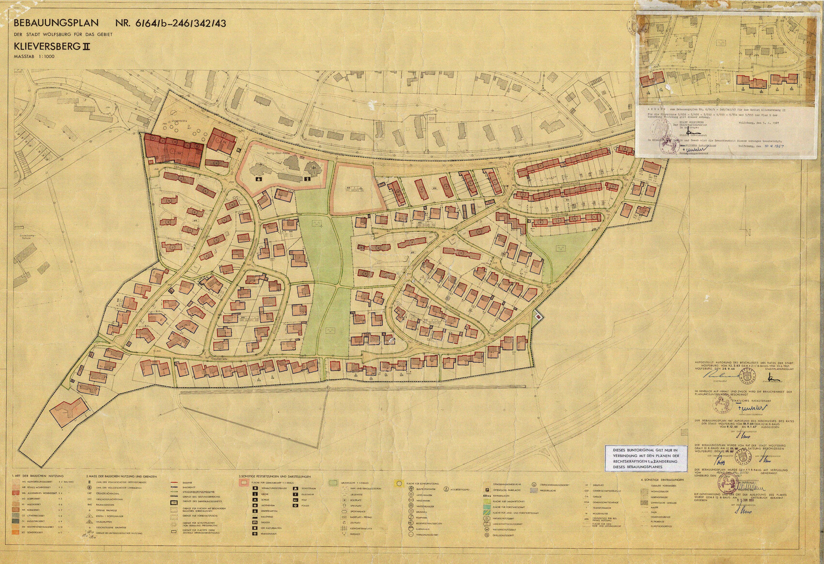

According to the development plan, this plot is the only one where the garage area belongs to the building window. This means that residential development may apparently be possible here as well. However, the corner is somewhat shaded by neighbouring buildings, so the ground floor would hardly be suitable for living purposes (but perhaps garage with office/guest room on the upper floor).

- Preferred heating technology: currently district heating for heating (high pressure, direct without heat exchanger), instant water heater/boiler for hot water. Planned: district heating for heating and hot water with buffer storage and connection options for additional alternative energy sources (solar thermal, geothermal [only shallow foundation allowed]). Air source heat pump probably unsuitable due to no underfloor heating, possibly after renovation in bathroom/kitchen.
Exterior views:

Option 1:
- “Separate” extension with its own ridge
- Advantage: depth variable according to space requirements as long as proportions with main house are acceptable
- Disadvantage: bedroom becomes a walk-through room with little light, and what is the purpose of the additional room on the upper floor (consider 2m (6.5 ft) head height line)?
Option 2:
- Separate roof with a shallower pitch
- Advantage: size still variable, light in bedroom (balcony door becomes window)
- Disadvantage: appearance and proportions, roof too flat
Option 3:
- Extension of existing roof,
- Advantage: best visual solution, subtle modern elements possible (e.g., large window), allowing light in bedroom as balcony door remains as floor-to-ceiling window with parapet
- Disadvantage: bedroom window (former balcony door) faces into room, room depth precisely defined by roof intersection

This thread mainly concerns the living room extension, if I understand correctly. Your family planning seems a bit unclear, which makes the need for additional space on the upper floor uncertain.
Normally, the upper floor could stay as is, and you could extend the balcony into a roof terrace – but you don’t want that, right? Why not? That would save quite a bit of cost.

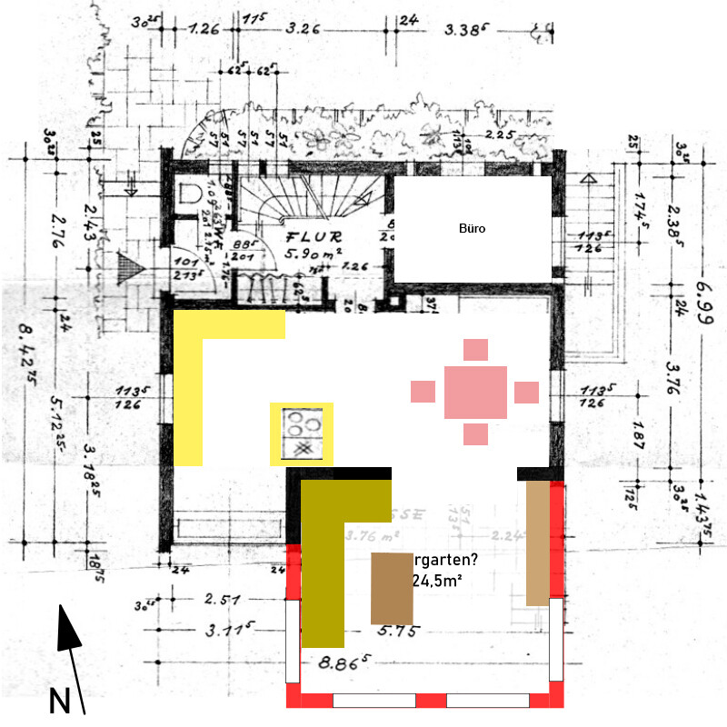

There was a question about the furnishing. Here is a suggestion:
The first question should definitely go to the structural engineer – how large and how far can the opening be? I wouldn’t even consider installing a door there.
This would be my preferred solution if it’s possible to position the water and electrical supply for the kitchen (yellow) on the left side of the plan. The stove connection is always tricky, and I won’t even start on the water supply. Since that is probably unlikely, the kitchen would most likely have to go to the right side of the plan:
It should still be possible to break through the wall there. However, the position of the chimney would be questionable in that case.

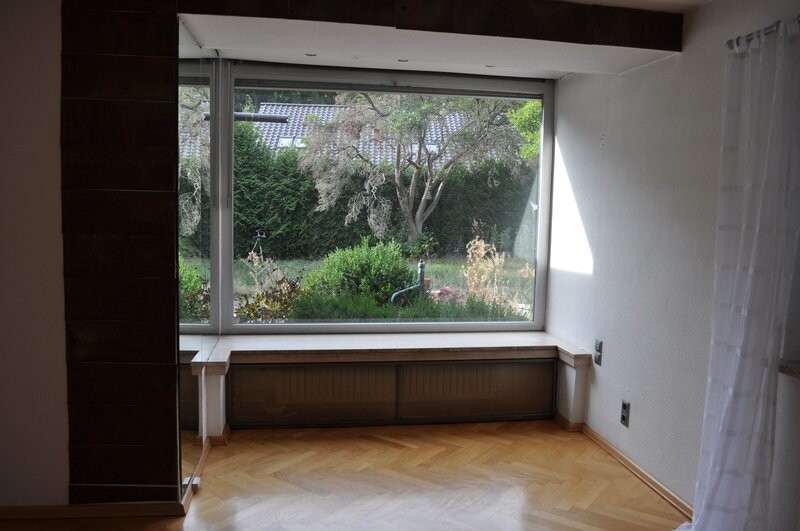

By the way, is that a window seat at the lower left side of the living room on the plan?
At first glance, I don’t see any alternative solution upstairs either, although the sloped ceilings are still a significant question mark. If only one child is planned, you could also leave the room in front of the bedroom completely open and create a kind of play area for the child there.

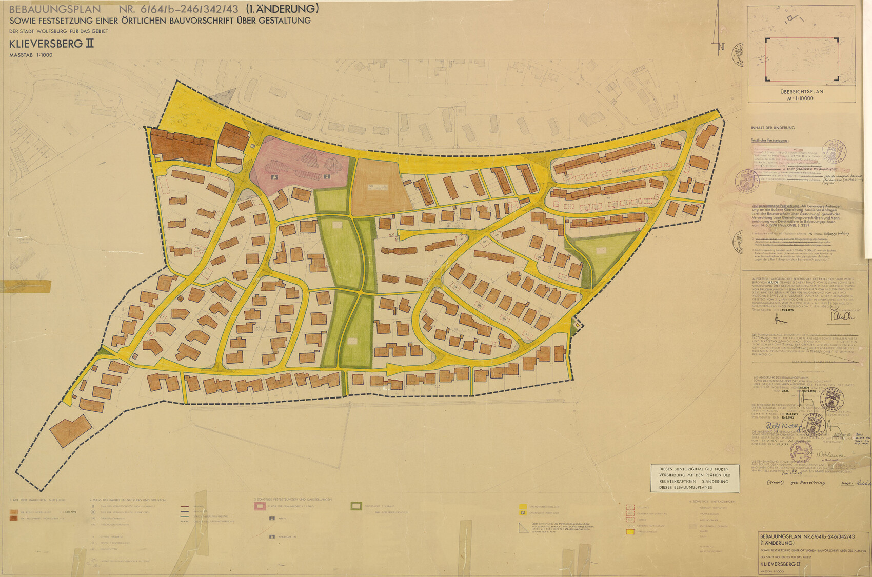

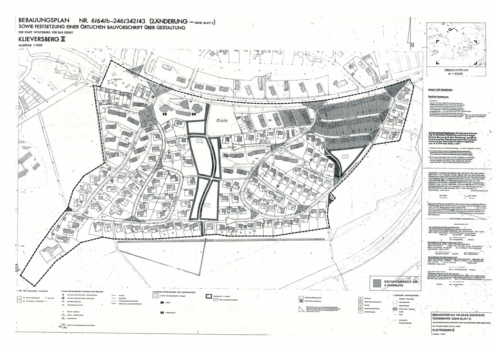

Thank you for the feedback. I will try to organize and comment on some points.
First, a note regarding my own input: there was originally a reference to the development plans here:
Attached are the development plans.
Development Plan from 14.12.1967
Development Plan 1st Amendment from 31.10.1977
Development Plan 2nd Amendment from 13.04.1987

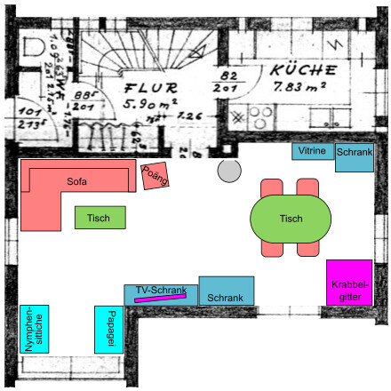

As an initial planning aid, here is the current arrangement of the living room:
We also have two bird cages, and the four feathered friends love to look out into the garden but simultaneously need some visual privacy. As prey animals, they would otherwise become stressed by too much activity outside the window.
You could sit on the windowsill if there weren’t flowers there now. Also, the radiator under the windowsill was temporarily removed, so the stone ledge gets pretty cold:
I can’t say yet, only that this will be a project for 5 to 10 years from now. Regardless, we currently have equity of over €60,000 (about $65,000) available.
I’ll try to clarify:
LordNibbler schrieb:
The plot is not within the scope of the stipulations of the 2nd amendment.
kaho674 schrieb:
Is that actually a window seat there at the lower left in the living room?
kaho674 schrieb:
What budget are you planning to allocate?

I am definitely open to all kinds of creative ideas, including unconventional angled walls or projections:
It would be nice to have the terrace in the lower left of the plan and the walls facing the neighbor on the right side of the plan.
With a pitched roof (2 x 10° slope per axis), it looks like this:
It already feels quite substantial and large.
