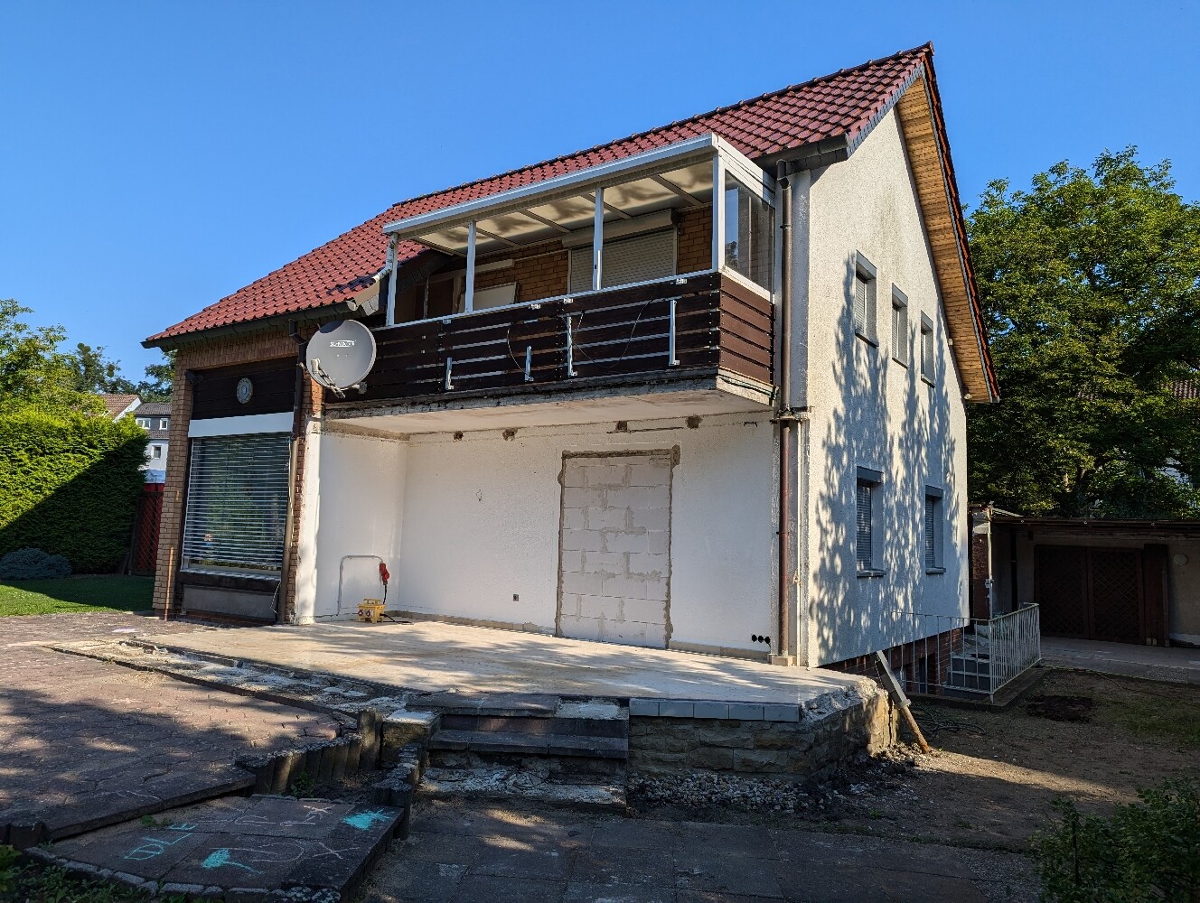

LordNibbler26 Aug 2024 11:37
Progress is being made.
The conservatory and other extensions have been demolished.

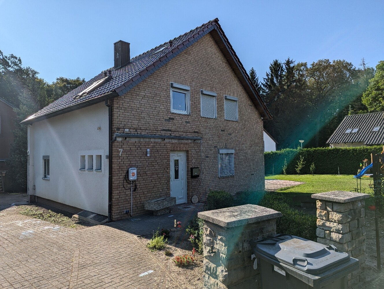

Two-story detached house with red tiled roof, balcony, and satellite dish.
Two-story house with brick facade and white side wall, driveway, and garden.

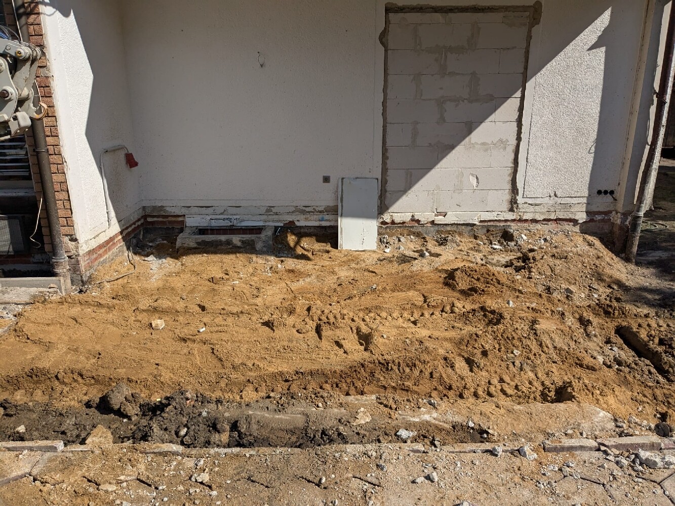

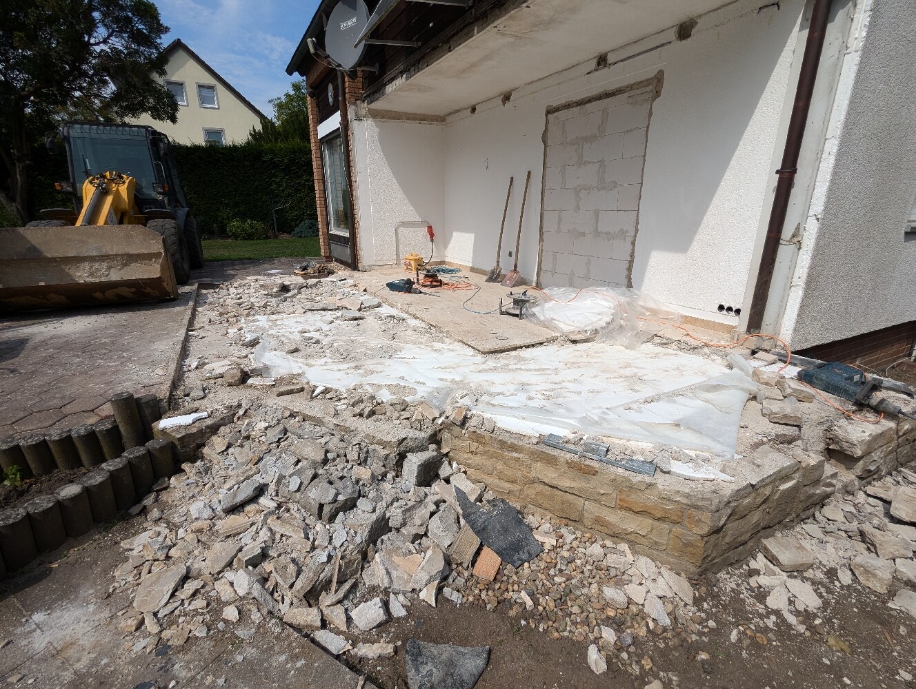

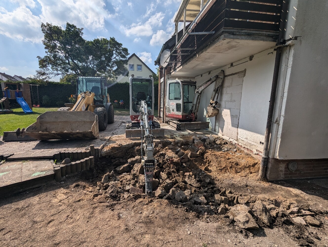

The excavators have arrived and demolished the conservatory’s concrete slab and the external basement stairs.
Construction site in front of the house: rubble, demolished wall, excavator on the left, tools and plastic sheets.
Construction site in front of the house: excavators working, soil and construction debris in front of the building.
Construction site: earth excavation in front of white facade wall, one wall opening bricked up, one panel leaning against the wall.

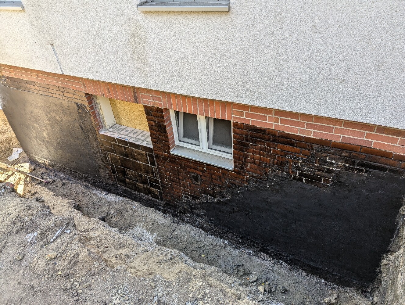

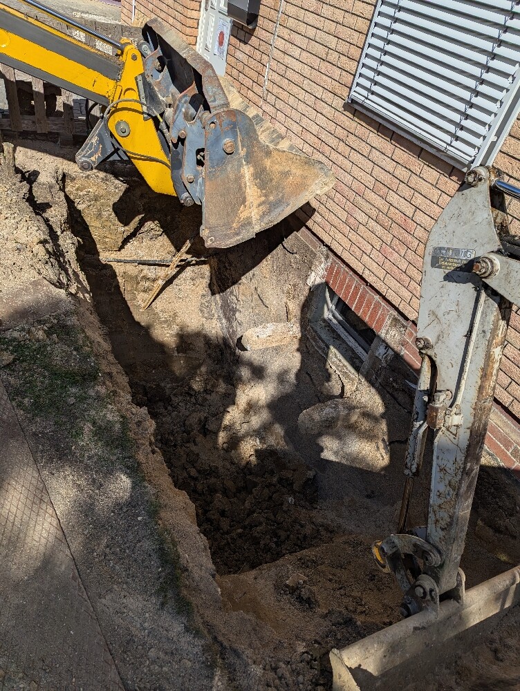

Then excavation began to remove the old drainage system, so a new one can be installed and the basement walls insulated.
Excavated building pit in front of basement wall with window; dark waterproofing on the foundation.
Trench next to the house, foundation exposed; orange drainage pipe being laid, excavator in the background.
Excavator with yellow bucket digging a trench next to a brick house.
