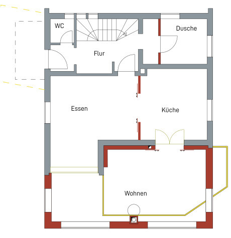

For the introduction, I am using the questionnaire for standard floor plan planning as far as possible, although many answers naturally reflect the current situation:
Order: basement, ground floor, upper floor, cross-section

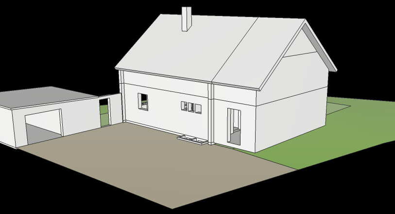

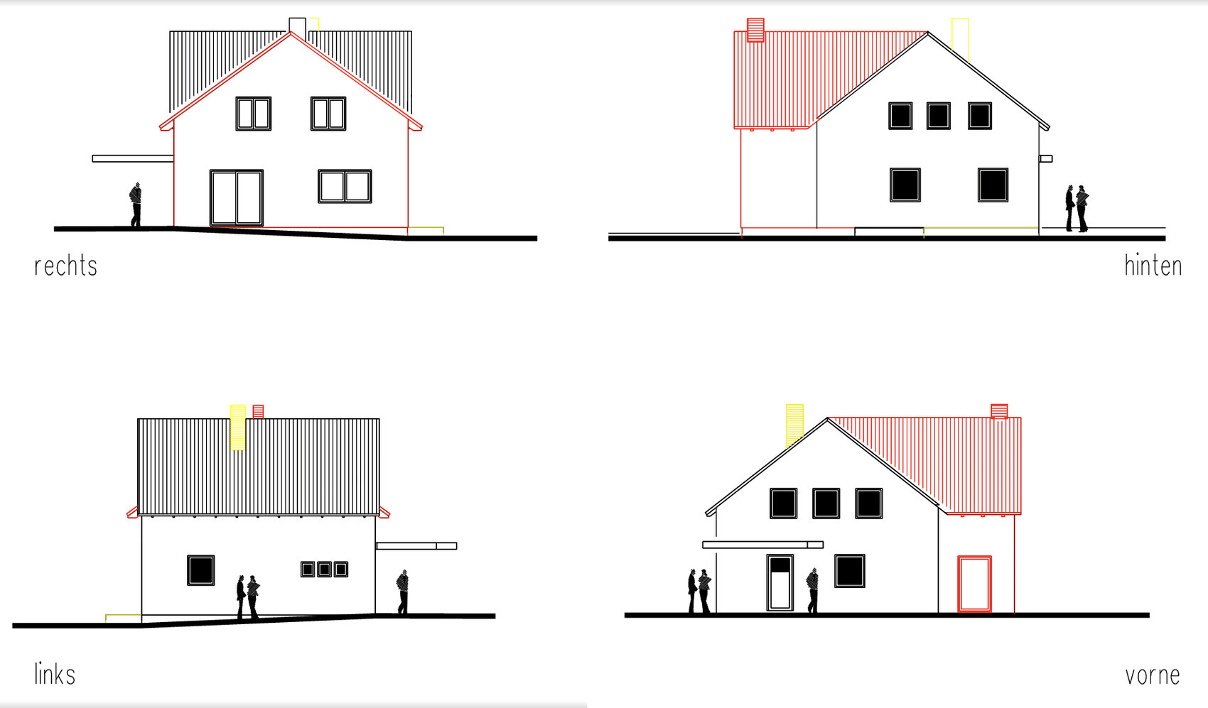

Exterior views:

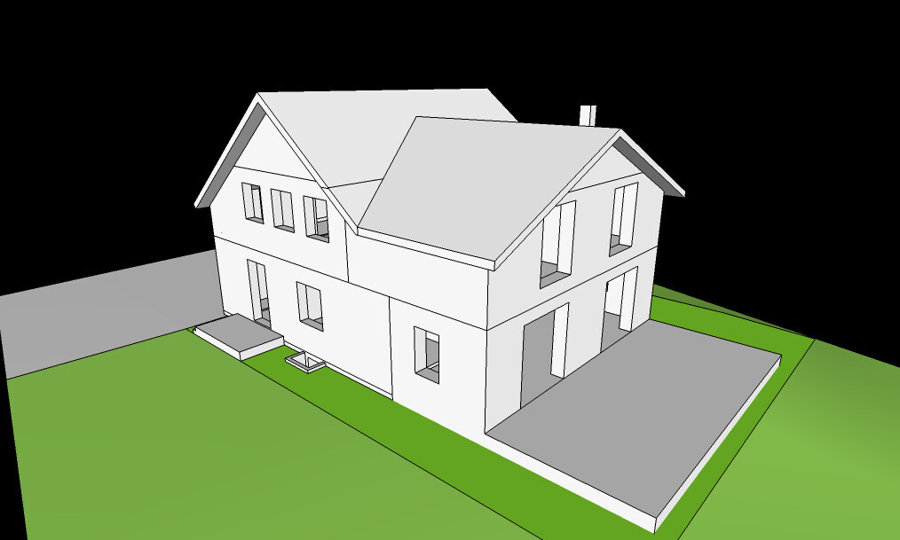

3D drawing comparing original (with old terrace) and conservatory extension (including new terrace):
(dark green lawn = building window)
As mentioned at the beginning, we are planning to replace the conservatory with a better solution in the medium term.
The goal is to have a room serving a similar function: a bright room with a nice view of the garden, for example through large lift-and-slide doors. However, it should also meet the requirements of a living space (proper thermal insulation, solid walls instead of aluminum frames, adequate heating, tight roof).
We are still uncertain about some fundamental aspects:
- Separate room or large opening to living room (and possibly a partition there – essentially a "rotation of the living room")
- What happens with the bedroom (balcony not needed, currently no sloped ceiling; will it become a dead space or a walk-through room?)
- Which roof shape (extend existing, new roof with shallower pitch in front, side wing with its own ridge direction; however, no flat roof or cubic shape)
Option 1:
- “Separate” extension with its own ridge
- Advantage: depth variable according to space requirements as long as proportions with main house are acceptable
- Disadvantage: bedroom becomes a walk-through room with little light, and what is the purpose of the additional room on the upper floor (consider 2m (6.5 ft) head height line)?
Option 2:
- Separate roof with a shallower pitch
- Advantage: size still variable, light in bedroom (balcony door becomes window)
- Disadvantage: appearance and proportions, roof too flat
(Image in next post)
Option 3:
- Extension of existing roof,
- Advantage: best visual solution, subtle modern elements possible (e.g., large window), allowing light in bedroom as balcony door remains as floor-to-ceiling window with parapet
- Disadvantage: bedroom window (former balcony door) faces into room, room depth precisely defined by roof intersection

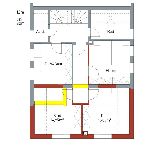

Not everything in life can be planned, and knowing that now there are two children living in the house, we would certainly have done a full renovation with different modification options before moving in. But some change requests and disadvantages only become apparent after living there for a while.

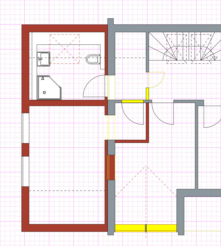

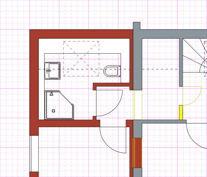

Specifically, I still have the question of whether there is enough space for a children’s shower bathroom on the upper floor for my idea.
The sink and toilet are already close to the 2m (6 ft 7 in) line of the sloped ceiling. The shower has to be a corner solution to still allow entrance through the door. The partition wall by the shower is 20cm (8 inches) thick and 30cm (12 inches) by the toilet.
An alternative room layout on the same floor space is only disadvantageous for the children’s rooms with zigzag circulation routes and unmanageable narrow spaces:

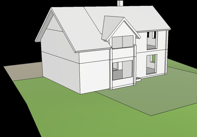

For the old children's room, I am considering a dormer as a replacement for the windows. One option could be the following:
Due to the utility lines, I would plan the extension with a basement. This way, the existing lines can continue to be used, and only the connection point would need to be relocated. This should be more cost-effective than reinstalling all the house connections from the street.
