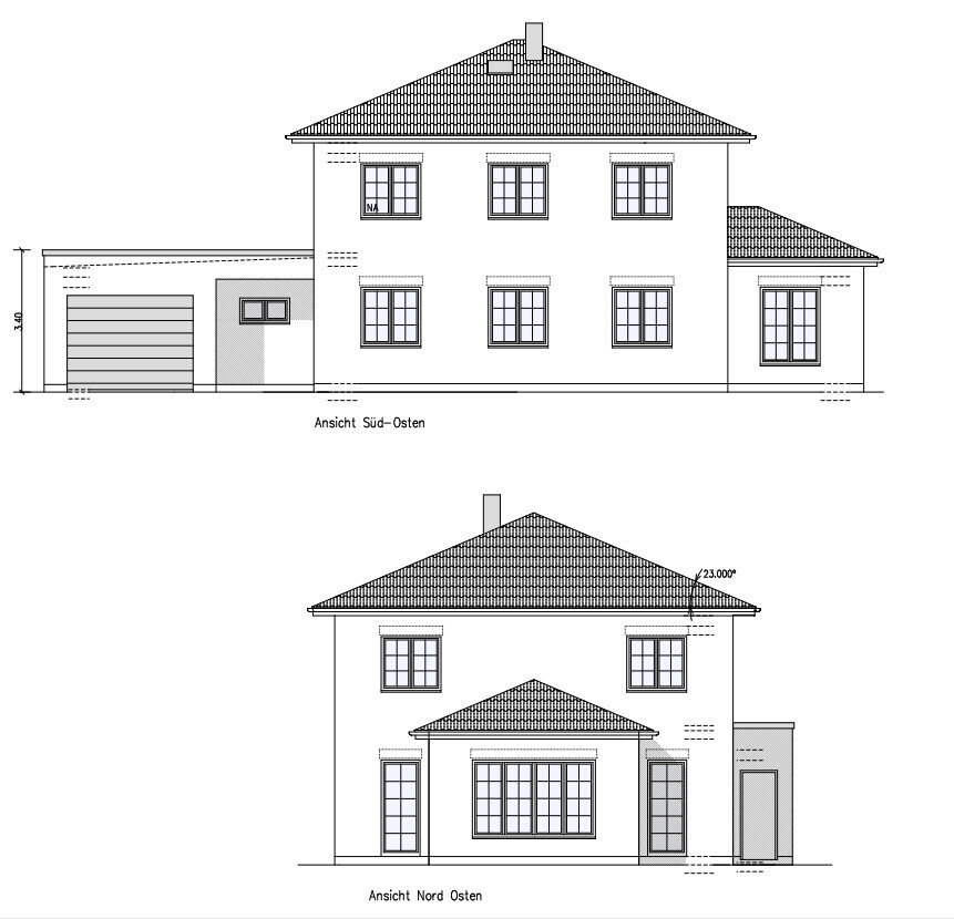

we are planning to build a city villa of about 150 sqm (1,615 sq ft) plus a 12 sqm (130 sq ft) conservatory on an east-west oriented plot. Unfortunately, the purchase of the plot was delayed by a full year, which has caused our construction costs for the same scope of work to increase significantly. I hope you might be able to help us save a few square meters on the floor plan. Another option would be to build a carport instead of a solid garage, but then we would lose a storage room. A further option would be to do without the conservatory entirely, but I would regret that later because, without meaning to offend anyone, I am not a fan of a modern "city villa cube" look and prefer a more classic style. According to the construction company, reducing the size of the conservatory would only lead to higher costs per square meter, so that is not feasible.

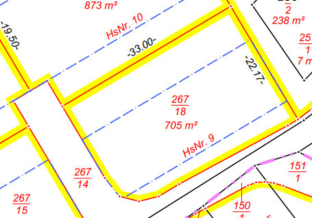

Plot size: 705 sqm (7,590 sq ft)
Slope: no
Floor space ratio: 0.4
Plot ratio: II
Building envelope, building line and boundary: 12 m x 33 m (39 ft x 108 ft)
Edge development: possible on the western street side and eastern neighboring plot

Additional wishes / special features / daily routine, including reasons why certain things are wanted or not: Garden with terrace in the northeast, as better privacy from the two adjoining streets (to the south and west) and to avoid higher connection costs since the house connections are on the west side

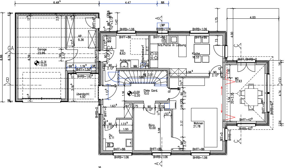

What do you particularly like? Why? Closed kitchen and terrace to the northeast garden (due to privacy), entrance on the west side, overall room layout on the upper floor
What do you not like? Why? Difficult building window with street exposure, so a compromise on the location of the bathroom and office windows on the ground floor to maintain a symmetrical exterior appearance. Also, about 5 sqm (54 sq ft) smaller would help reduce costs, but the architect says smaller is not possible because of the staircase (note the floor height requiring 16 steps). Floor-to-ceiling window in the living room is unnecessary and better replaced by a double terrace door from the kitchen and a double instead of single door between kitchen and living room.

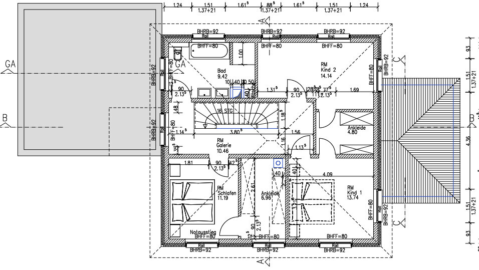

- can you give up: carport instead of solid garage, walk-in closets in bedroom and children’s rooms

Can we save about 5 sqm (54 sq ft) on the floor plan (excluding garage and conservatory) without giving up the conservatory? I know the conservatory is a luxury, but I’ve always dreamed of it and would prefer not to let that dream go. To avoid making the upper floor rooms too small, I would like to remove the walk-in closets.

Two-story house with gable roof, garage on left, window fronts; southeast and northeast.
Floor plan of house with garage, kitchen, living room, office and dining area, dimensions
Upper floor plan: bedroom, two children’s rooms, walk-in closets, bathroom, gallery, stairs.

If you want to save space, remove the second dining area downstairs and the walk-in closets upstairs.
Furnish the rooms with the desired or existing furniture to scale. Especially the dining areas.
On the ground floor, remove the doors between the office and living room, and between the garage and utility room. They waste usable space.
Check the dimensions in the bedroom. How wide is the parents' walk-in closet?
Remove your bedroom from the south side.

May I ask why you planned a city villa cube if you don’t like it? What was the reason against a rectangle with a pitched roof? Rectangles are usually more efficient in terms of space usage. Is the 5 square meters (54 square feet) less enough for you? What is the planned level of equipment? Perhaps there is still room to save there?

- One walk-in closet upstairs is more than enough. Large wardrobes can be placed in the children’s rooms
- The bathroom is a bit small for four people and quite cramped. If the mother-in-law uses the upstairs toilet and doesn’t close the door, the view when entering might be priceless... I wouldn’t necessarily place the toilet there, unless it’s made of gold...
