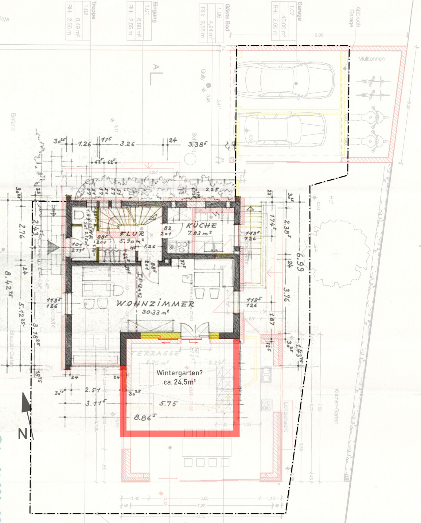

we are planning to replace the existing conservatory at our house with a new extension in the medium term. We already have some ideas but still have some time. However, we want to keep the goal in mind in order to complete necessary preliminary work or avoid blocking future options.
For the introduction, I am using the questionnaire for standard floor plan planning as far as possible, although many answers naturally reflect the current situation:
Order: basement, ground floor, upper floor, cross-section

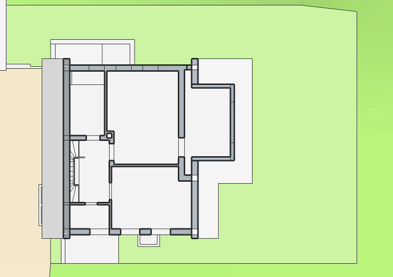

3D drawing comparing original (with old terrace) and conservatory extension (including new terrace):
(dark green lawn = building window)
As mentioned at the beginning, we are planning to replace the conservatory with a better solution in the medium term.
The goal is to have a room serving a similar function: a bright room with a nice view of the garden, for example through large lift-and-slide doors. However, it should also meet the requirements of a living space (proper thermal insulation, solid walls instead of aluminum frames, adequate heating, tight roof).
We are still uncertain about some fundamental aspects:

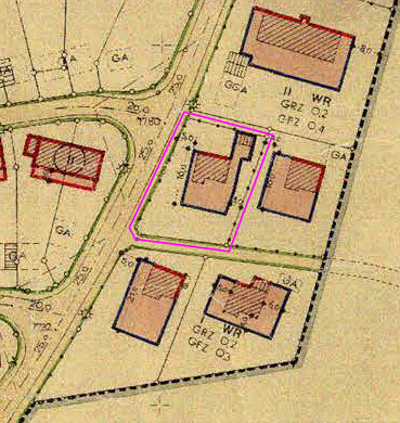

- Development plan (1st amendment) (colored)
- Development plan (2nd amendment) (changes not relevant but more readable, black and white)
- Extract from development plan (oriented north):

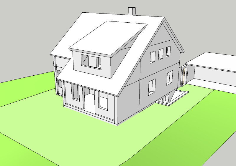

Option 1:
- “Separate” extension with its own ridge
- Advantage: depth variable according to space requirements as long as proportions with main house are acceptable
- Disadvantage: bedroom becomes a walk-through room with little light, and what is the purpose of the additional room on the upper floor (consider 2m (6.5 ft) head height line)?
Option 2:
- Separate roof with a shallower pitch
- Advantage: size still variable, light in bedroom (balcony door becomes window)
- Disadvantage: appearance and proportions, roof too flat
(Image in next post)
Option 3:
- Extension of existing roof,
- Advantage: best visual solution, subtle modern elements possible (e.g., large window), allowing light in bedroom as balcony door remains as floor-to-ceiling window with parapet
- Disadvantage: bedroom window (former balcony door) faces into room, room depth precisely defined by roof intersection

Tobibi schrieb:
Has the permit eligibility been clarified? What obstacles might there be (Lower Saxony)? In this residential area, many renovations, demolitions, and new constructions have taken place in recent years. This has resulted in buildings that do not comply with either the permitted number of full storeys or the site coverage ratio / floor area ratio according to the development plans. Therefore, there must be some scope for individual permits.
The original development plan provides the following information:
- Plot size: 787m² (8470 sq ft)
- Site coverage ratio: 0.2 = 157.4m² (1695 sq ft)
- Floor area ratio: 0.3 = 236.1m² (2541 sq ft)
- I WR (Pure residential area, maximum 1 full storey)
- Red = building line, Blue = building boundary
The first amendment includes the following addition:
Exceptions
According to §31 paragraph 1 of the Federal Building Code (BBauG), single-storey extensions for ancillary rooms (living space, WC, shower, cloakroom) outside the buildable area of the plot may exceptionally be permitted on the building side of the main entrance up to a depth of 2.20m (7.2 ft). For these extensions, either detached building style or a differing style in the case of boundary construction is allowed on the main entrance side.
Included regulation:
As a special requirement for the external design of structures (local building regulation on design) according to the ordinance on design regulations and the marking of monuments in development plans dated 14.6.1974 (Nds. GVBl. p. 333):
1. Extensions are only permitted with a flat roof in front of a full storey. The plot is not within the scope of the provisions of the second amendment.

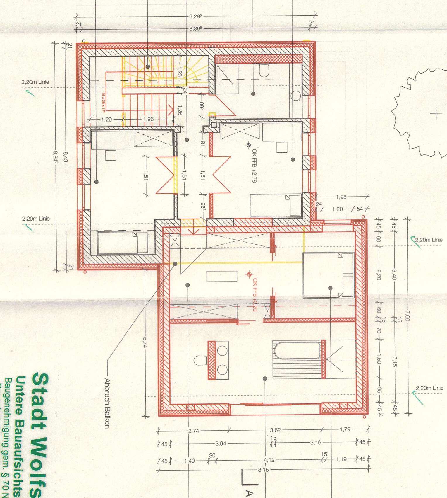

Reudnitzer schrieb:
If the extension is primarily about gaining daylight rather than space It is also about gaining space; the living room layout is not optimal, and in the upper floor, a room will be missing in the medium term.

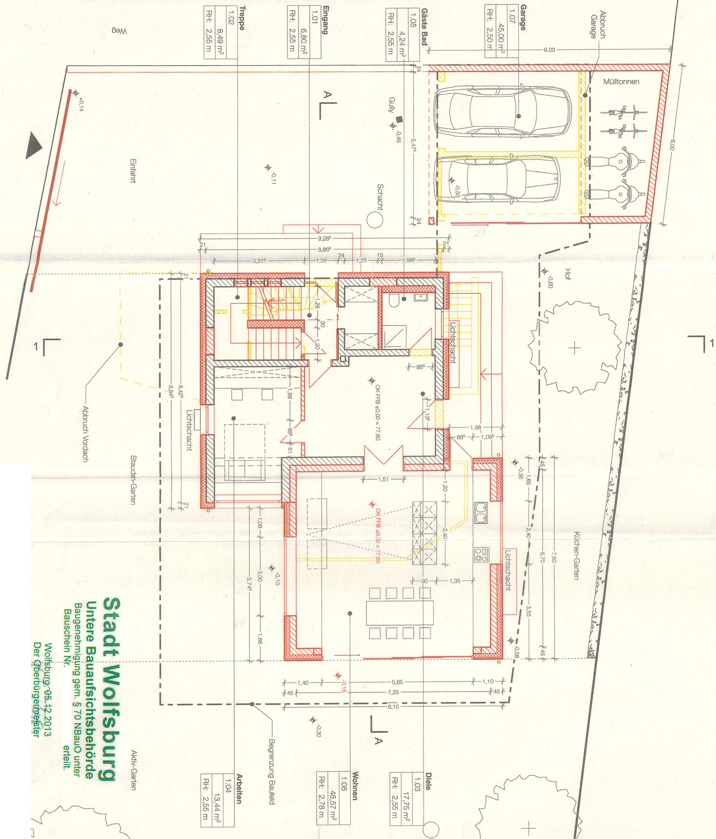

Please mark the "previous owner" option, which I like best, followed by option 2. You can see your building envelope in the drawing for the building permit of the previous owner’s renovation plan, where the building line on the entrance side is exceeded by the ETICS, as well as the building boundary at the front of the carport.
I have attached a neat scan of the previous owners’ version for all floors.
I don’t really need a huge master suite on the upper floor. The stairwell alteration and a roof where I might have to shovel snow to prevent it from getting trapped between the two gables is not my preferred solution.
Unfortunately, the position of the staircase along the building line limits the room-to-hall layout, so an existing room always has to be sacrificed to access the new rooms.

LordNibbler schrieb:
The staircase renovation and a roof where I might have to shovel snow to prevent it from getting between the two gables is also not ideal for me. I actually meant more that it would be helpful to see a comparison, so we can then distill a synthesis from the "previous owner" and "2" options.
