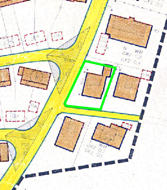

    • Extract from development plan (oriented north):
Site plan: yellow streets, brown buildings; green-bordered plot in the center.

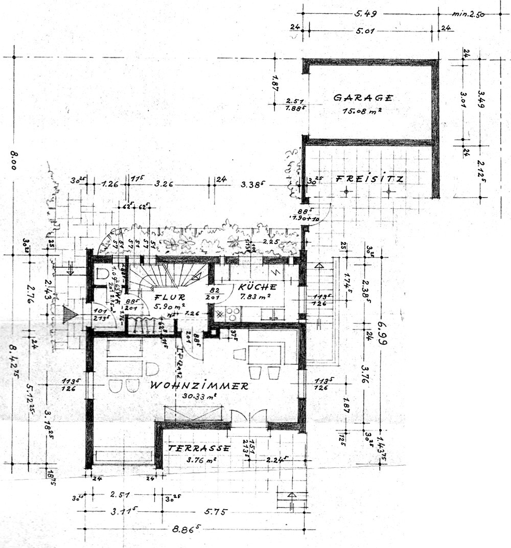

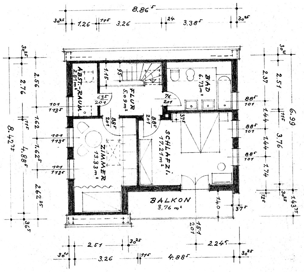

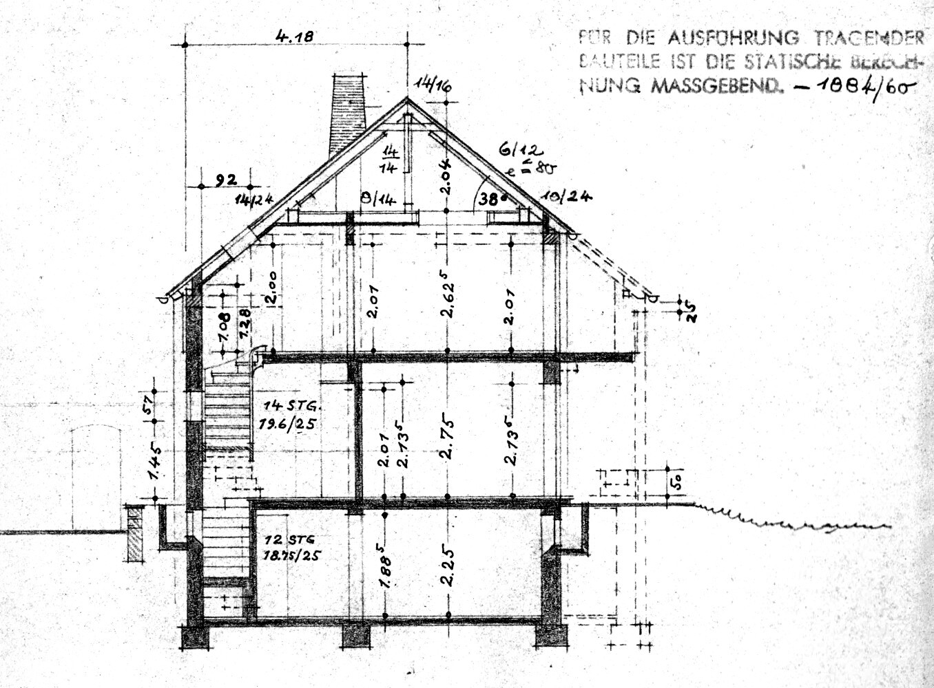

Floor plans (original condition, without conservatory):
Order: basement, ground floor, upper floor, cross-section
Basement floor plan with staircase, walls, doors, dimensions
House floor plan: living room, kitchen, hallway, terrace, garage, outdoor seating.
Upper floor plan with bedroom, hallway, bathroom and balcony.
Cross-section of a two-story house with roof structure, stairs, chimney and dimensions.

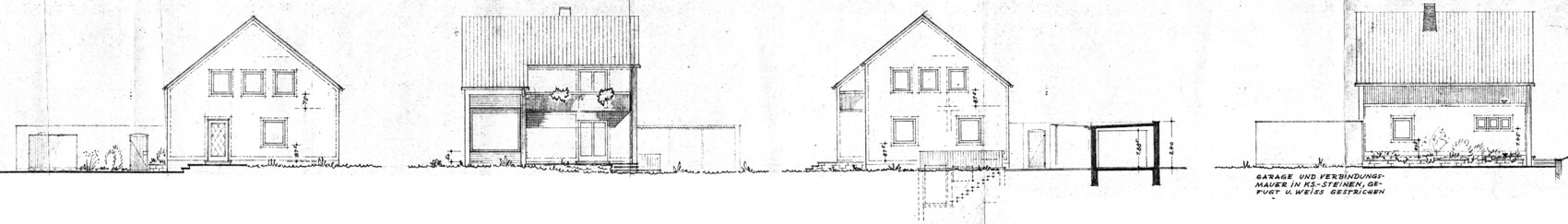

Exterior views:
Street view of several two-story houses with gardens, stairs and garages.

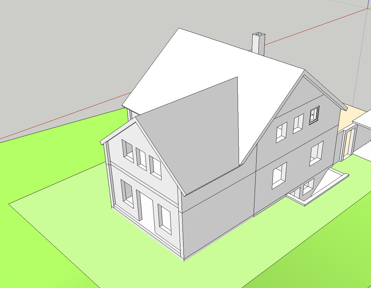

Option 1:
  • “Separate” extension with its own ridge
  • Advantage: depth variable according to space requirements as long as proportions with main house are acceptable
  • Disadvantage: bedroom becomes a walk-through room with little light, and what is the purpose of the additional room on the upper floor (consider 2m (6.5 ft) head height line)?
3D architectural model of a two-story house with gray facade and white roof
3D architectural model of a modern house with several roofs on a green plot

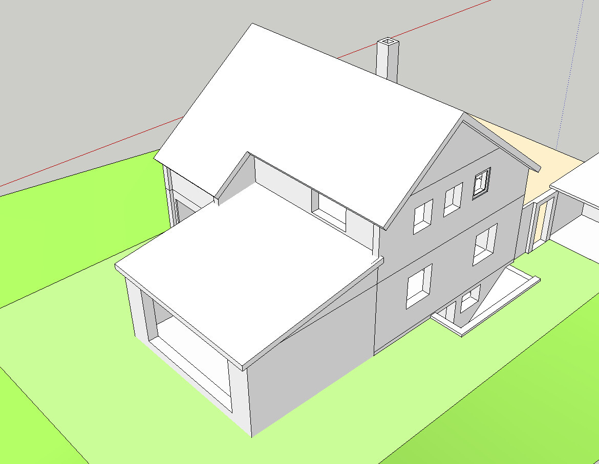

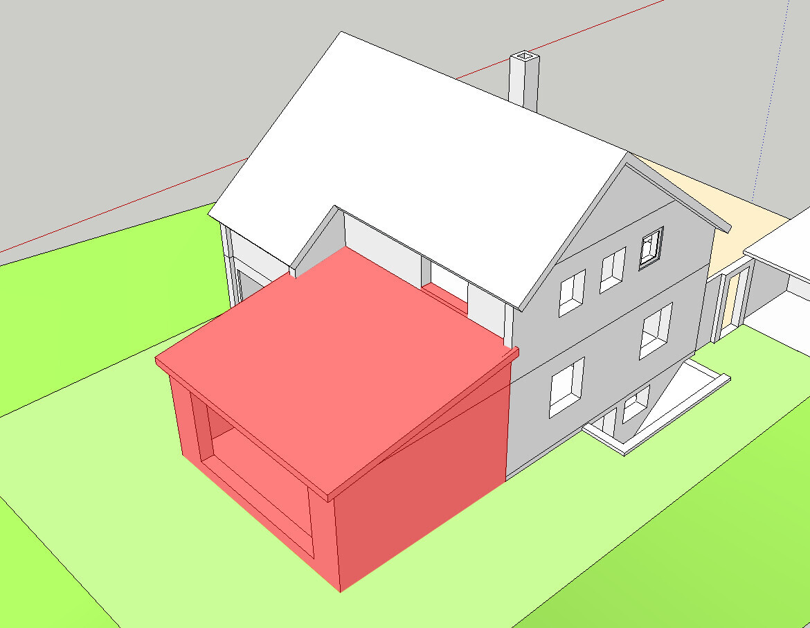

Option 2:
  • Separate roof with a shallower pitch
  • Advantage: size still variable, light in bedroom (balcony door becomes window)
  • Disadvantage: appearance and proportions, roof too flat
(Image in next post)

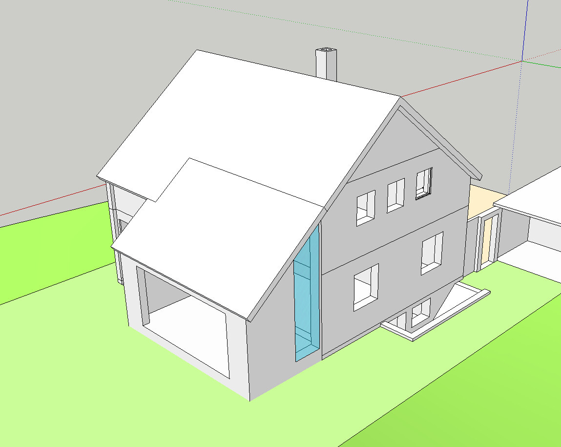

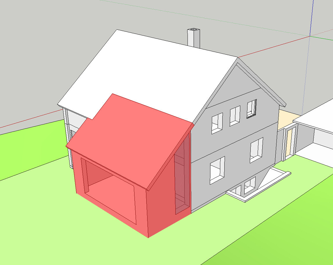

Option 3:
  • Extension of existing roof,
  • Advantage: best visual solution, subtle modern elements possible (e.g., large window), allowing light in bedroom as balcony door remains as floor-to-ceiling window with parapet
  • Disadvantage: bedroom window (former balcony door) faces into room, room depth precisely defined by roof intersection

Addendum: Images of the other options (due to image limits)
Option 2:
Isometric 3D house model of a two-story house with garage, fireplace, and garden.
Option 3:
Modern two-story house structure with carport, gray facade, and blue glass front entrance.

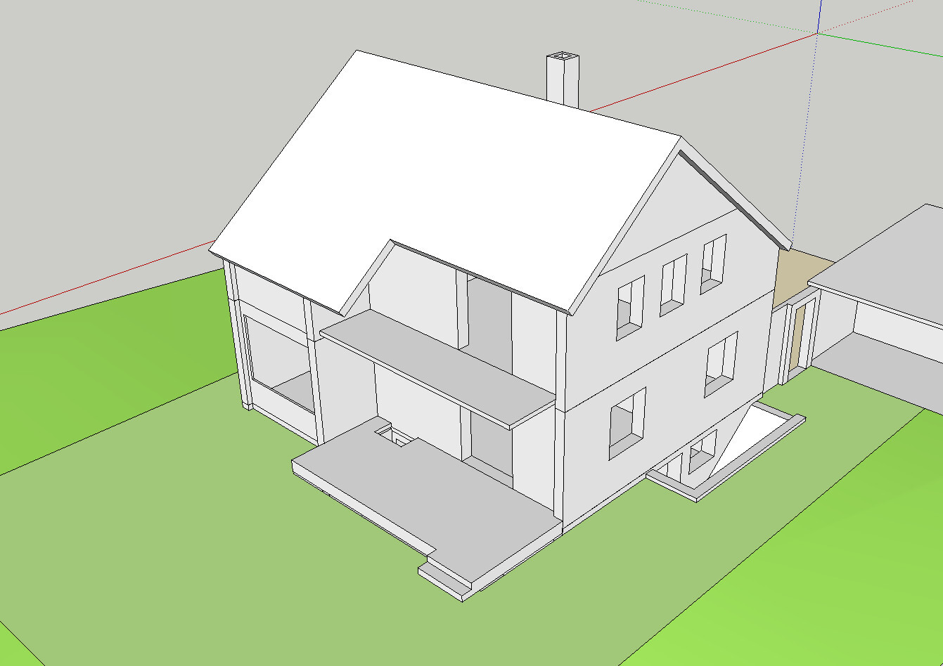

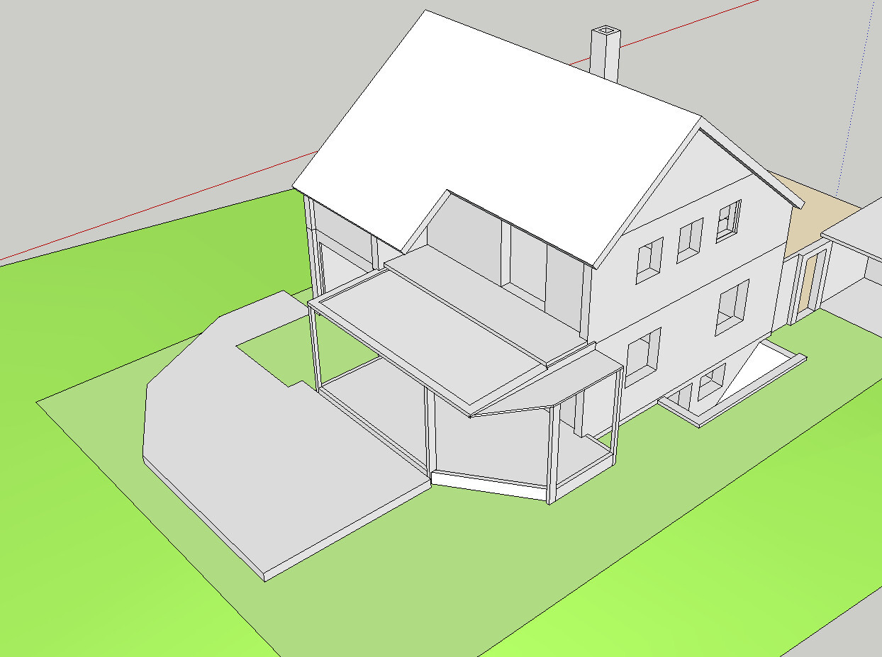

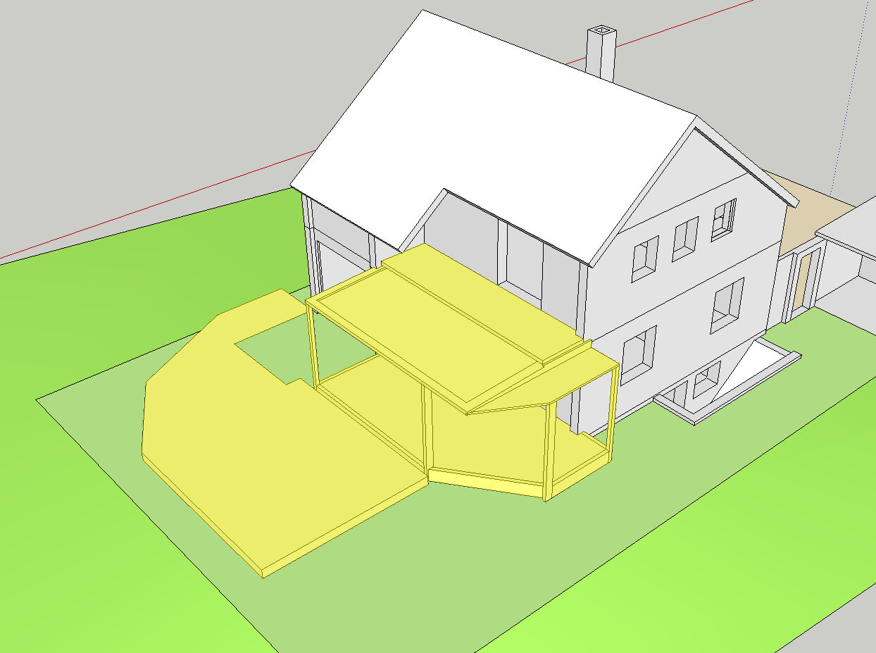

LordNibbler3 Dec 2019 11:41
I’d like to revive this thread and share the colorized images.
First, the existing condition: The conservatory and the balcony slab on the upper floor, as well as the current terrace, are marked in yellow. All these elements are in poor condition, darken the living room, and are therefore planned to be replaced.
3D house model with yellow terrace structure in the front garden
The idea is to build a fully basement-equipped extension in the same location. The question is whether it should be one or two stories and how it should be designed.

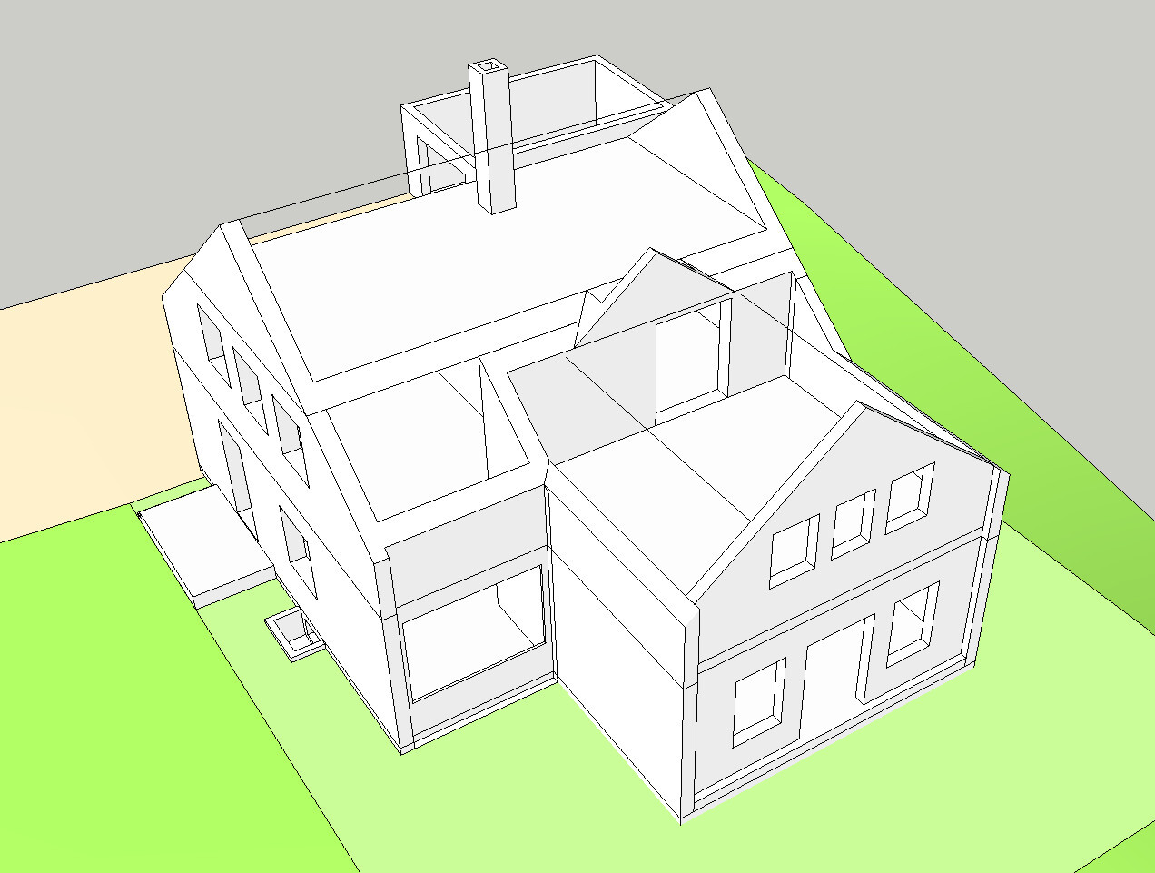

The first option is a "standard" extension, which requires a larger intervention on the roof:
3D architectural model of a semi-detached house with red front section and gray back section on green plot

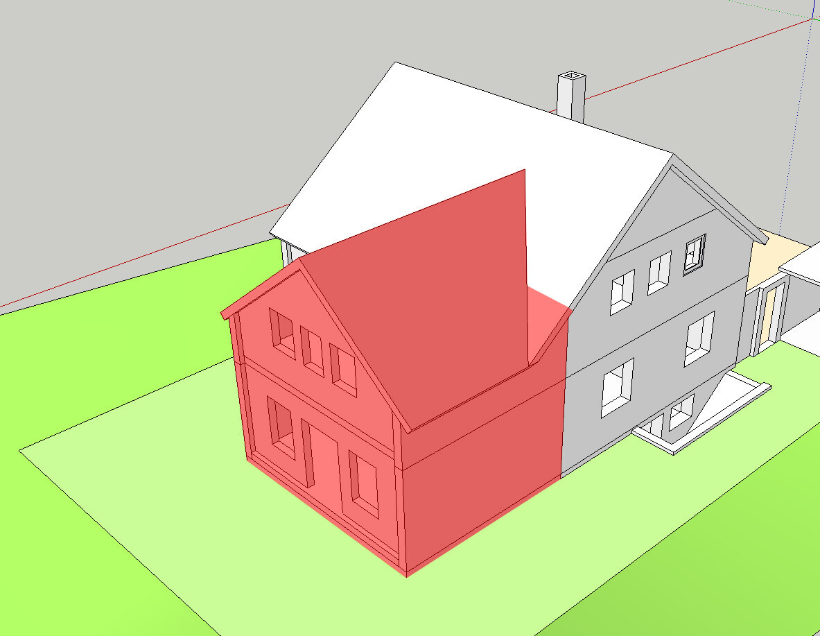

The third option involves continuing the roof plane and adding a gallery window from the bedroom into the new space.
3D house model: gray two-story house with red entrance extension in a green garden.
The second and third options are limited in size due to dependencies on other existing elements (roof, windows). The first option offers the most flexibility. Below are some floor plan ideas for the first option.

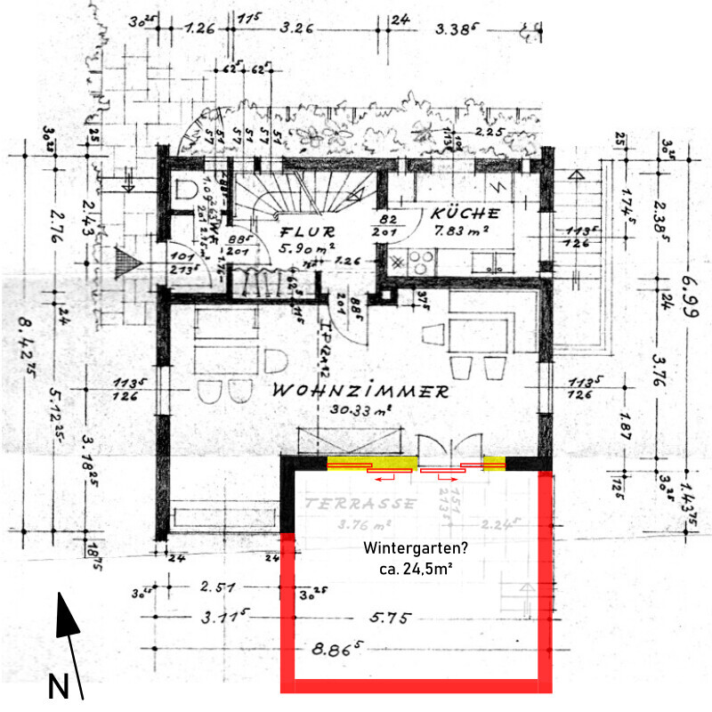

The idea would be to enlarge the living room on the ground floor through the extension. Currently, the living area is on the west side, and the dining area is on the east side. Enlarging the doorway to the current conservatory could bring more light to the east side. However, I’m unsure about the layout and furniture arrangement. Even now, it has been challenging to position the sofa in a meaningful way in relation to the TV.
Alternatively, the opening could be made even larger, creating a separate room on the east side, while the west side could be separated by a wall approximately at the beam level.
Floor plan with living room, kitchen, hallway; red conservatory extension approx. 24.5 m² (263 sq ft)

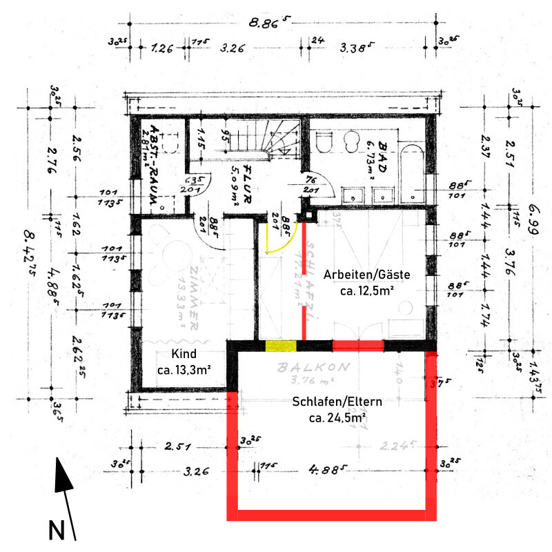

On the upper floor, the question is about long-term use. If the new room is only added to the current bedroom, it would become a walk-through room, making it unusable for a guest or child. Therefore, the idea is to separate part of it as a hallway. The question is whether this can be done effectively given the ceiling height and roof slope at the side of the extension.
Apartment floor plan with bedroom/parents, child, study/guest room, and balcony; red walls.

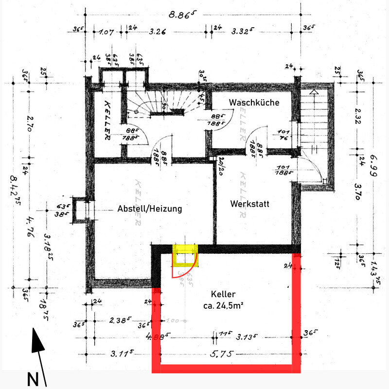

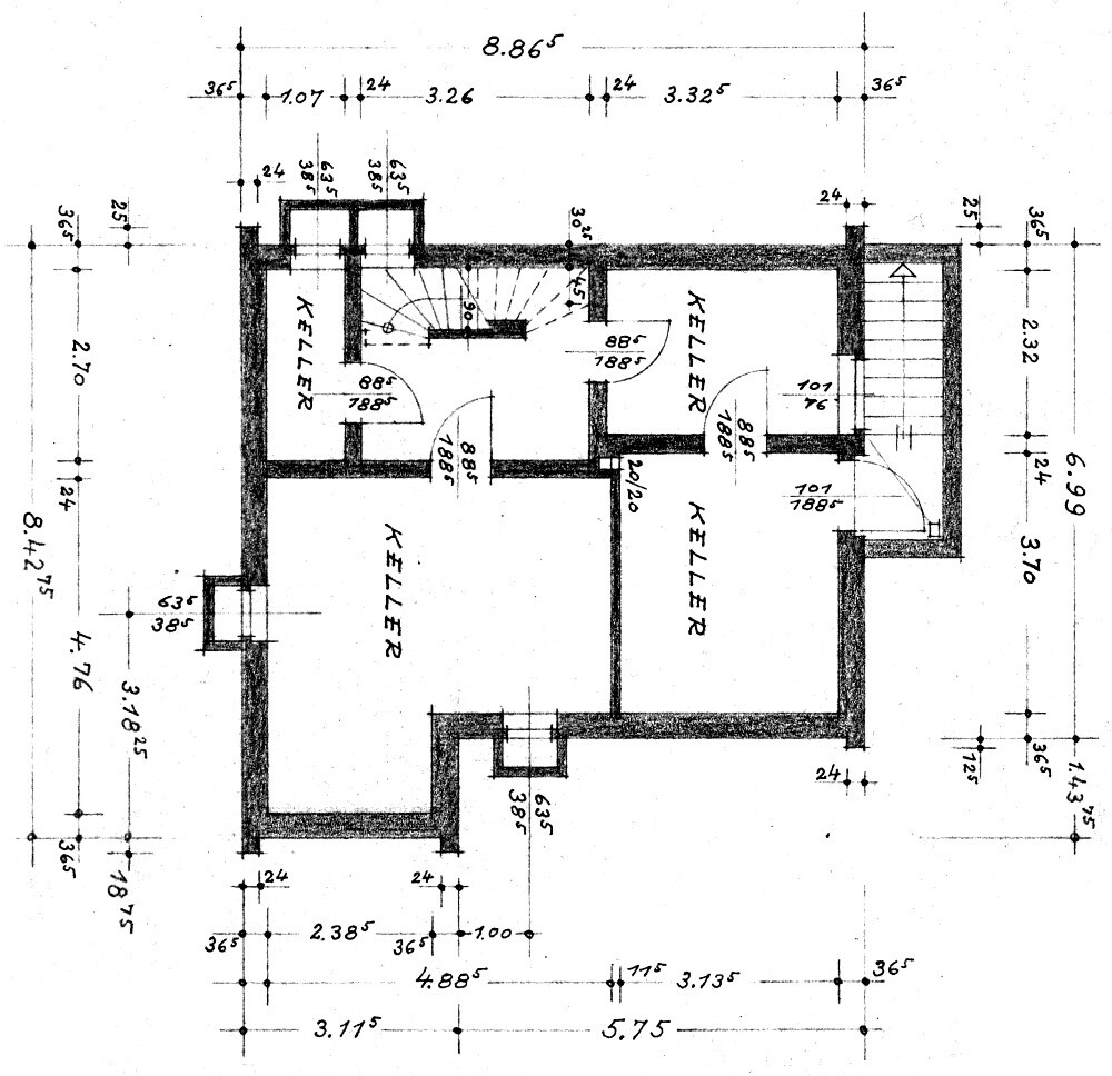

Nothing unusual happens in the basement. To access the drainage system (which anyway needs to be replaced and is currently inaccessible under the conservatory), the extension will also have a basement.
Basement floor plan with storage/heating, workshop, laundry room; red outline for basement, yellow door.

LordNibbler3 Dec 2019 11:52
As an additional note:

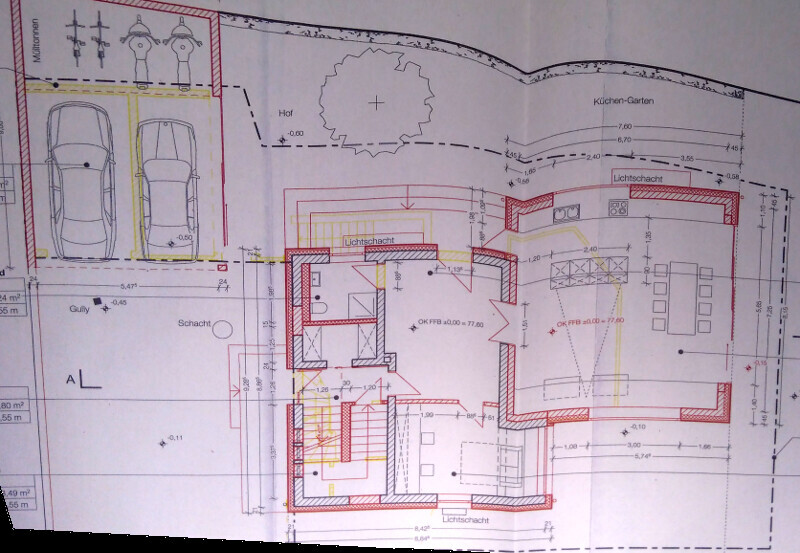

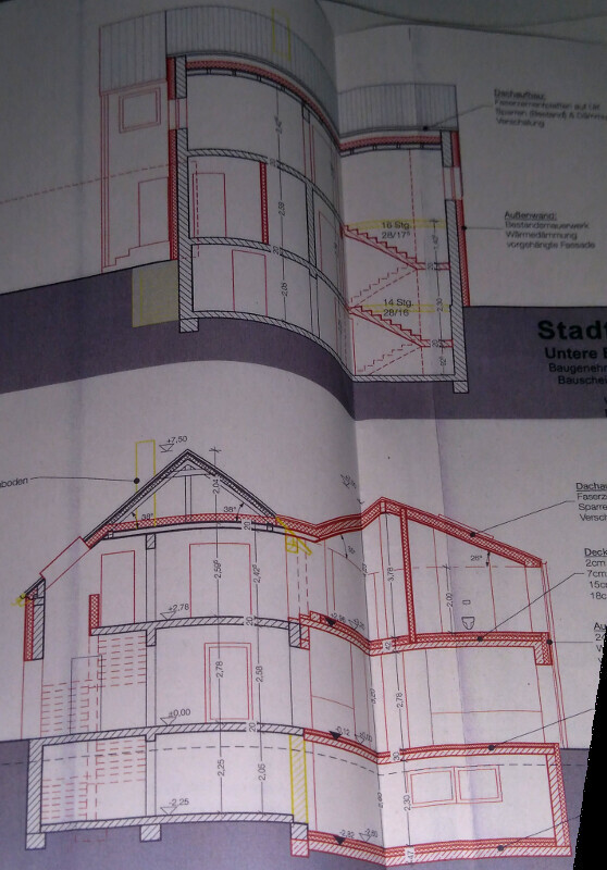

The previous owners had also planned an extension. However, it was somewhat larger in scale and involved major renovations to the existing structure. I found the approved plan in the building file, but in the end, they decided to build a completely new house instead:
Grundriss eines Hauses mit Garage für zwei Autos, Innenräumen, Treppen und Maßen.
Architektur-Schnitt eines mehrstöckigen Hauses mit Dachstuhl, Treppen und roter Linienzeichnung.
