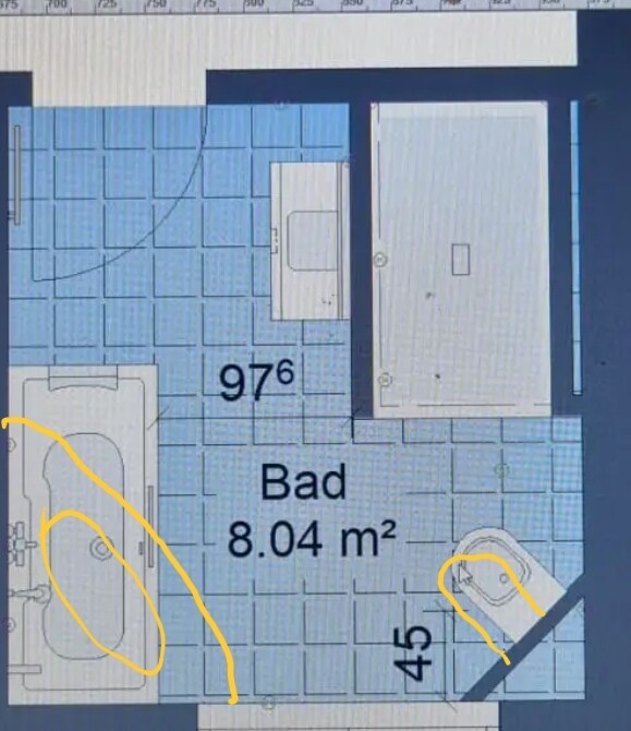

I’m in a bit of a rush again. It’s a long story, so I’ll get straight to the point. I need to plan my bathroom layout by tomorrow evening, deciding where and how I want everything. How would you arrange the sanitary fixtures?
I’ve uploaded the floor plan with the bathroom measurements. The layout also shows how our architect (not great) would do it. But I don’t like it.
Upper floor plan with bathroom, hallway and stairs, dimensions
The bathroom is about a bit more than 8m² (86 sq ft). You can find the dimensions in the plan. I want a bathtub, a sink, and a standard-size toilet. The shower should be 90 by 140cm (35 by 55 inches).
The only thing I really want is to have the sink closer to the door. It bothers me that it’s all in a row and feels cramped between the toilet and shower. I’ve already looked at several pictures but can’t move forward.

Here are a few other ideas,...
The first picture with the toilet not in the corner but along the side wall is my favorite... however, on the construction site it felt very tight and awkward... on the plan, I like it.

Our bathroom has a very similar layout. We have the toilet and sink mirrored on the side below the door. The shower and bathtub form a "front," separated by built-in protrusions that provide storage space.
I would actually keep it that way. The other designs feel very cramped and partly dark, and sometimes there isn’t enough space to move around comfortably.
As already mentioned, with 140cm (55 inches) you need a door on the shower anyway. I would let that desire (which I understand) go, in favor of a bright, more spacious-feeling bathroom.

Yes, the problem is that since I'm bringing up this change request too late, it will mean that I have to sign off on the screed possibly cracking in this configuration. Otherwise, they would relocate the toilet drain above ground so that I would have a built-in wall along the window at the bottom... I don’t want a built-in wall, even if it is shallow—I think it looks ugly... and I can’t really judge how it will turn out if I sign off on the risk of the screed cracking... that’s my concern.
Then I find the shower positioned awkwardly apart from the bathtub... but I’ve considered using a square shower to make the corner a bit more rounded...
So the main issue is the toilet—I can’t weigh the risks that I’m agreeing to by signing this.

I wouldn’t take that risk either. The sink isn’t far from the door anyway. Besides, in your current plan, there’s still space for a tall cabinet between the shower and the sink. I don’t have that because of the continuous bathtub-shower wall, and I really miss it. Maybe the design isn’t so bad after all? I think it feels very spacious, especially for 8 m² (86 sq ft).

I would probably do it like this:
Corner bathtub and toilet in the center of the pre-wall.
Floor plan of a bathroom with bathtub on the left, shower in the middle, toilet on the right, 8.04 m² (86.5 sq ft).

I believe that if you draw it to scale, the corner bathtub extends much further into the room, and then it could get tight with the corner of the shower screen.
