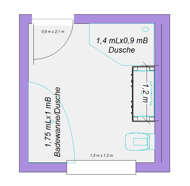

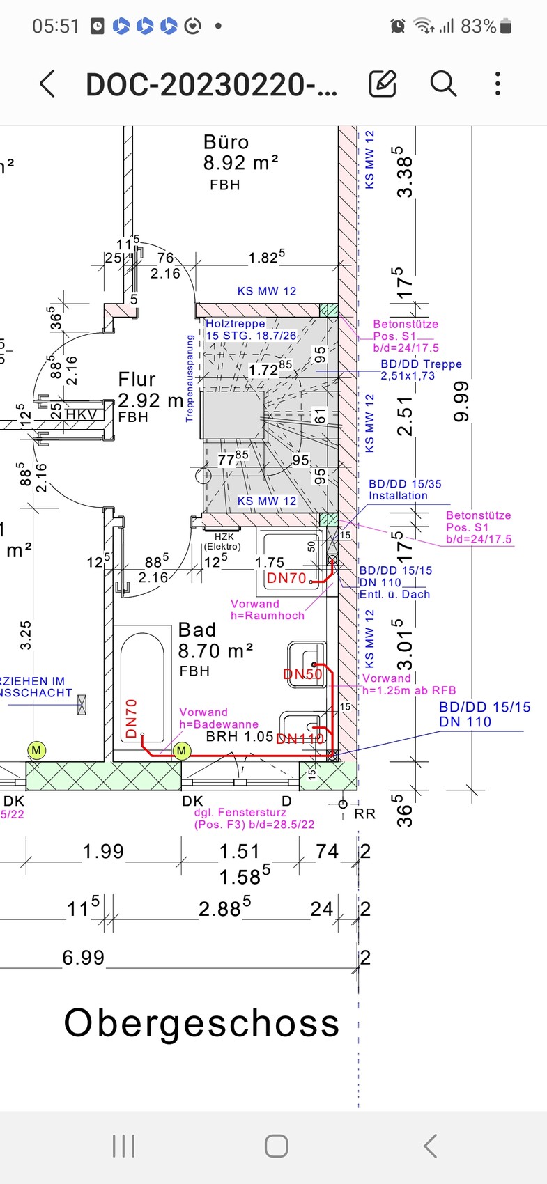

I’m in a bit of a rush again. It’s a long story, so I’ll get straight to the point. I need to plan my bathroom layout by tomorrow evening, deciding where and how I want everything. How would you arrange the sanitary fixtures?
I’ve uploaded the floor plan with the bathroom measurements. The layout also shows how our architect (not great) would do it. But I don’t like it.
The bathroom is about a bit more than 8m² (86 sq ft). You can find the dimensions in the plan. I want a bathtub, a sink, and a standard-size toilet. The shower should be 90 by 140cm (35 by 55 inches).
The only thing I really want is to have the sink closer to the door. It bothers me that it’s all in a row and feels cramped between the toilet and shower. I’ve already looked at several pictures but can’t move forward.
Our requirements:
Shower at least 140 by 90cm (55 by 35 inches)
Sink 80cm (32 inches), 60cm (24 inches) would also work in a pinch
A drywall partition in the bathroom is not necessary but could be considered
Sink closer to the door
Would anyone be willing to suggest ideas? As I said, I’m still designing and need help. I need a plan to submit tomorrow.

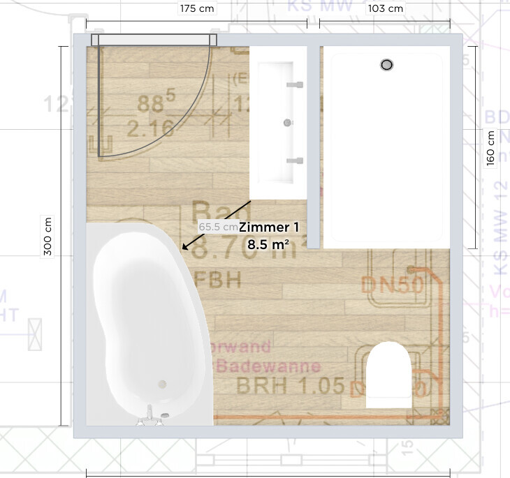

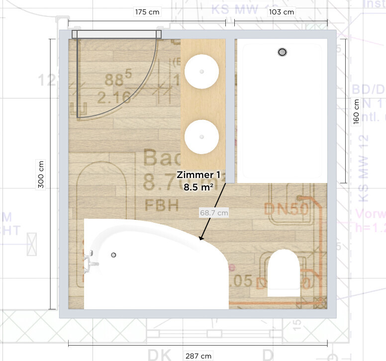

motorradsilke31 May 2023 19:18Jurassic135 schrieb:
I think if you draw it to scale, the corner bathtub extends much further into the room, and then the corner of the shower screen might become tight.You would have to try it. If necessary, make the shower a bit shorter.I took up Silke’s idea.
A 160 x 100 cm (63 x 39 inches) tub won’t work, but a 135 x 135 cm (53 x 53 inches) corner bathtub does.
What bothers me personally is standing in front of the door – it’s uncomfortable both for the person getting ready and for anyone who wants to enter. Also, I think the space is too small to separate off. A glass partition is harder to clean, but it makes the bathroom feel more spacious.
