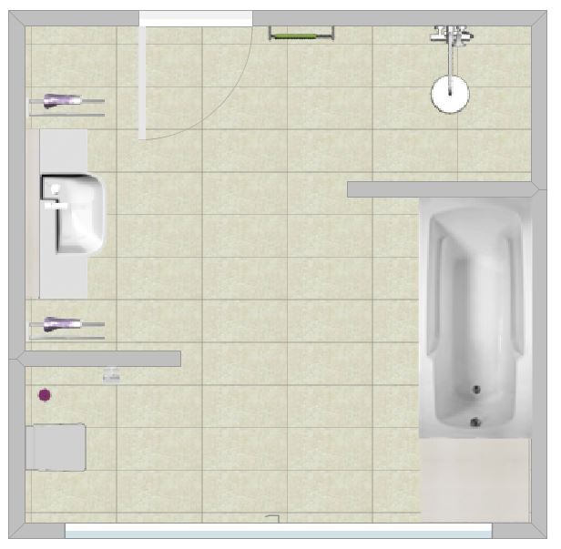

Strahleman26 Aug 2019 14:44Okay, I’ll rephrase my statement. Of course, there are reasons we have considered. It seems more open and practical to us because:
- after entering the bathroom, you wouldn’t “immediately” run straight into the sink
- we would have enough space for two people at the sink area
- we gain a bit more storage since we can easily place three tall cabinets along the wall next to the shower (which would be independent of which side you enter the shower from)
- the entire window front would remain visible. The wall in front of the toilet would be planned as a half-height privacy wall, as you also suggested
- the bathtub could be chosen wider without reducing the passage space between the sink and the bathtub to less than 80cm (31.5 inches)
I was unfortunately unable to draw the drywall partitions at the sink and toilet in Roomsketcher, so they are missing. However, we are aware that these will still be added. We are planning for 10-15cm (4-6 inches) of shelf space at the sink. Around the bathtub, a bit more shelf space is planned to comfortably place a glass or a bottle of water.
We initially included the bathtub because its dimensions roughly correspond to the built-in bathtub from the T-bathroom and even offer slightly more space. But tonight I’ll insert a different bathtub and take a closer look.
Why would you rotate the shower access? Just because of the bathtub or is there another reason as well? Our thought was that this would move the “wet area” slightly away from the door and also prevent a bath mat from constantly being in front of the door. Or are we worrying too much about that?

j.bautsch26 Aug 2019 14:55There is definitely room for improvement in the kitchen design. There is a dedicated, excellent forum specifically for kitchens that I would highly recommend checking out.
Strahleman schrieb:
Why would you change the shower entrance? Just because of the bathtub or is there another reason? Our thought was that this way the "wet area" is a bit further from the door and there’s no shower mat lying around by the entrance all the time. Or are we worrying too much about this? Because of the bathtub and the window.
The shower mat is definitely a reason; in our case, it always gets moved with whoever is showering into a basket... but I’m also not a fan of positioning sanitary fixtures individually if you can achieve a good "wall-to-wall combination."
Besides, I have a preference for built-in bathtubs without any awkward edges or window frames—otherwise it looks unplanned and accidental. However, everything will work, and let’s just accept it as it is: with a semi-detached house you have to take the dimensions as they are.
If I were you, I would simply pay close attention to how the window affects privacy and visibility.

Strahleman27 Aug 2019 09:07Tastes can vary so much. At the moment, we have the shower and bathtub arranged in a row as a built-in block from wall to wall, but we would find a corner bathtub much more attractive, as freestanding. I have now also built your suggestion to see if I understood it correctly. As mentioned, the bath mat would constantly end up somewhere in front of the door, and unfortunately, with this version, the options to include one or two tall bathroom cabinets disappear.
The kitchen has not been ordered yet; we have only been thinking about the layout and considering where to place the oven or the refrigerator.

Strahleman29 Aug 2019 11:06ypg schrieb:
Another idea: have the door hinge reversed. On the open door leaf, add the shower screen in addition to the shower screen from #16, but shorten it a bit. Place the shower head on the other wall.
Corner bathtub in front of the window, with the toilet in between. Did I understand you correctly? That shower would be really spacious. But with the short wall only about 1m (3.3 ft) long, wouldn’t water splash out when showering? Still, it’s definitely a good idea. I should take time this evening to work out a proper design with my partner.
