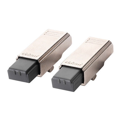

Hello Ikea fans,
I’m wondering if these UTRUSTA door dampers fit on the FYNDIG kitchen cabinet hinges. Does anyone know? 😕
Here are the door dampers:
Two electrical connectors with metal housing and gray plastic plug
UTRUSTA
Door damper for hinge
They come in two sizes. If they fit at all, probably only the smaller ones would work.

Hello, the dampers don’t fit. It’s best to replace the hinges entirely with soft-close ones.
