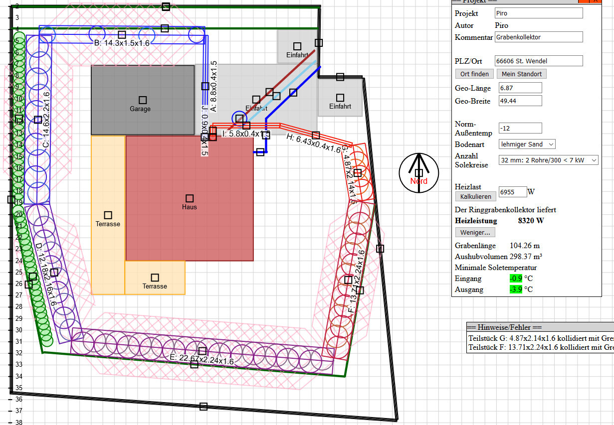

Yes, drilling costs have decreased somewhat due to the new subsidy, but I believe they will rise again soon as more people opt for drilling. That’s why I’m considering the ring trench collector, especially since I will already have the excavator on site to carry out the earthworks.
The plot is large enough. I have planned it at the edge, see the drawing. I still need to perform the heating load calculation, but I think 7 kW is realistic.
