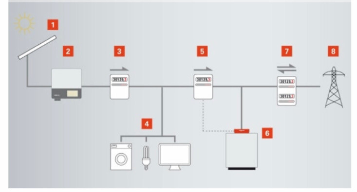

Now, my question is: What makes the most sense? Should everything run through a single meter? Two separate meters? Or like shown in the pictures attached?

Chris_Colt22 Mar 2020 13:10What are your basic specifications? And maybe you can share some information regarding your consumption/production?
So, do you have a two-way meter for everything and nothing else?
Photovoltaic system with 9.3 kWp, air-to-water heat pump, and controlled residential ventilation. I cannot comment on consumption yet, as we have only recently moved into the house. Roughly estimated, it should be between 6500-7000 kWh.
We have a bi-directional meter installed.
Chris_Colt22 Mar 2020 20:58So, you only have a two-way meter for everything, nothing more, correct? That would also be my preferred option. During the day, when the sun is shining, feed everything into the air-to-water heat pump and the consumers, and if there is still surplus available, then feed it back into the grid.
