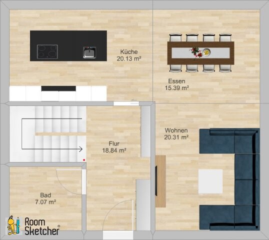

So, not being able to create a functional room layout with those exterior dimensions and just a few rooms is quite an achievement, in my opinion.
I kept the exterior dimensions but used a different staircase, and suddenly there are no more awkward, twisted rooms. This way, you can save a significant amount of floor space. I left out the windows.
When I plan for myself, I fit two more rooms on each floor within the same area (and we’re planning without a basement): technical room and office downstairs, laundry room and a second bathroom upstairs. With such a large kitchen, a pantry is probably unnecessary since the tall cabinets should hold enough supplies.
In my case, north is at the bottom (sorry for the rotation).
Grundriss eines Apartments mit Küche, Essen, Wohnen, Flur, Bad und Treppenaufgang
Grundriss der Etage: zwei Kinderzimmer, Elternzimmer, Flur, Bad, Ankleide, Treppenhaus.

Please discard the plan. It is flawed and not worth debating. New staircase, new luck.
