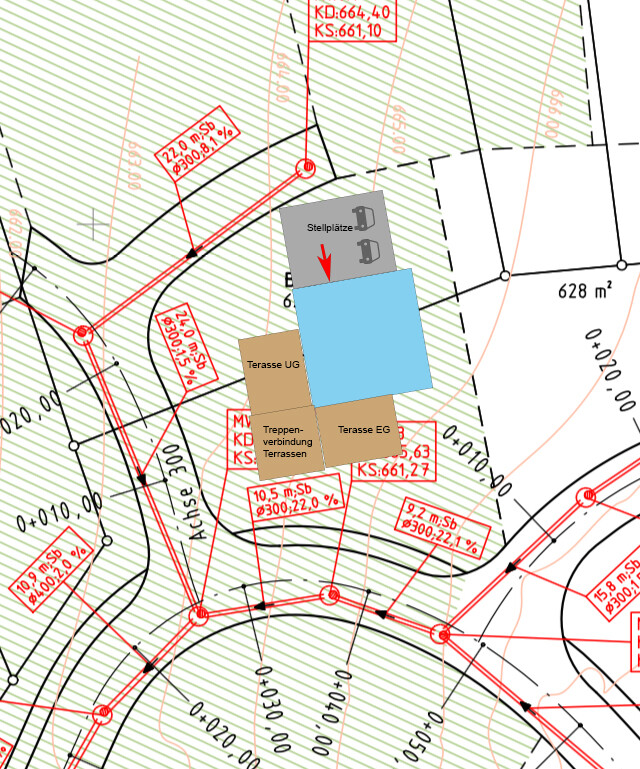

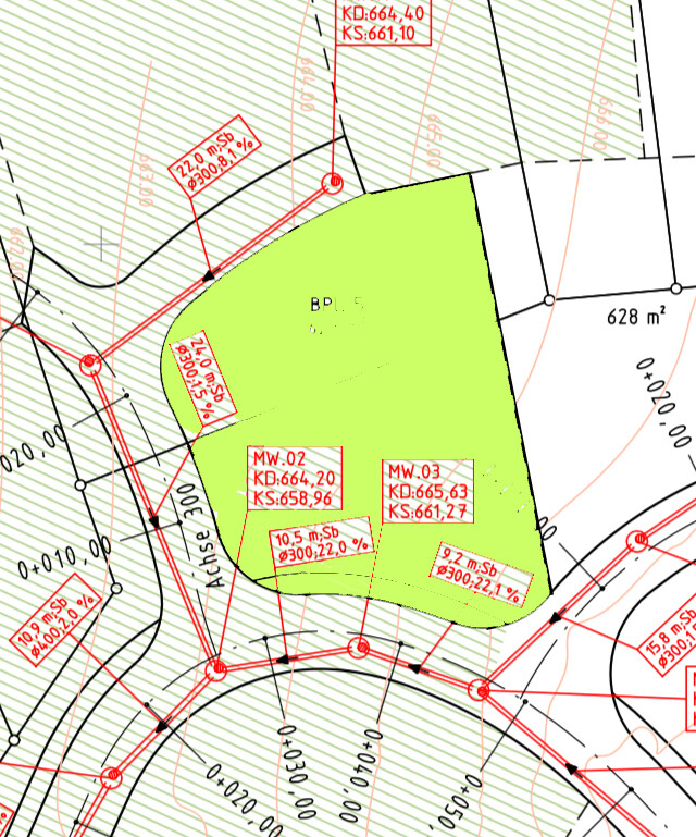

How about placing your house on your plot first? That would have avoided a lot of confusion.
I would still recommend planning parking spaces only on the north side. Needing to park with a slight turn around the corner seems less problematic to me than the hundreds of thousands you’d have to spend on an unwanted basement with a garage under the house.
I would rather invest that money in an elegant multi-level terrace that connects the ground floor and basement with stairs.
The idea of having a garage in the basement was suggested because it supposedly doesn’t cost significantly more than leaving out the basement, building an additional garage, and having to level the terrain. However, I have no idea if this is really true.
I find the idea of a roof terrace on the garage interesting. Is something like this easy to implement, or does it cost significantly more than if it were fully integrated into the building?
