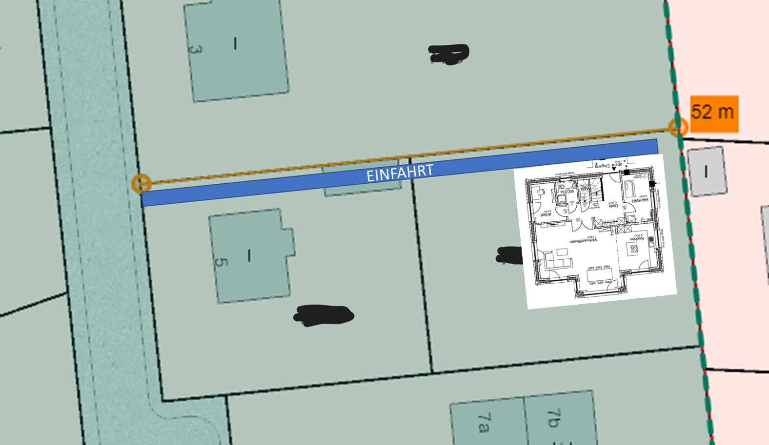

Schnubbihh
23 Oct 2023 10:44
hanghaus2023 schrieb:
It’s hard to say much without any information about the plot.
Where is north?
Why does everyone include a bay window?
I have attached a site plan with orientation.
The bay windows face south, and the front door faces north.
The bay window is always included to create space for the third children’s bedroom upstairs.
In the worst case, we would turn it into a small gable if the budget gets tight. However, we also see it as a nice feature on the ground floor for the dining room and would prefer not to give it up. The house’s footprint is already fully maximized according to the building permit / planning permission.

hanghaus2023
23 Oct 2023 10:54
Why place the utility room (HAR) so far from the street? The supply lines should be as short as possible.
Where will the parking spaces be located? Where should the rerouting take place?
Have you already purchased the plot?
Could you share some information about the budget for the house?
Are there any dimensions available for the house and the plot?

Schnubbihh
23 Oct 2023 12:31
I just noticed that the images have been renamed, which unfortunately makes matching numbers 1-3 no longer possible. Annoying!
The question regarding the heat recovery ventilation system (HRV) is definitely very relevant and something we have already considered. It might make sense to position the house more towards the west and mirror the floor plans. That way, we would have a southeast-facing garden instead of a southwest-facing one. However, we would still like the kitchen to be on the east side, so we would need to check if mirroring is possible without any issues. Another question is how much more expensive the connection costs would be if the HRV is located at the farthest corner of the property.
Plot dimensions: approximately 26x21m (85x69 ft)
House dimensions: approximately 11.25x9.25m (37x30 ft)
House budget: around 450,000 euros (for approximately 155 square meters (1,668 square feet))
Parking space has not been clearly defined yet.
