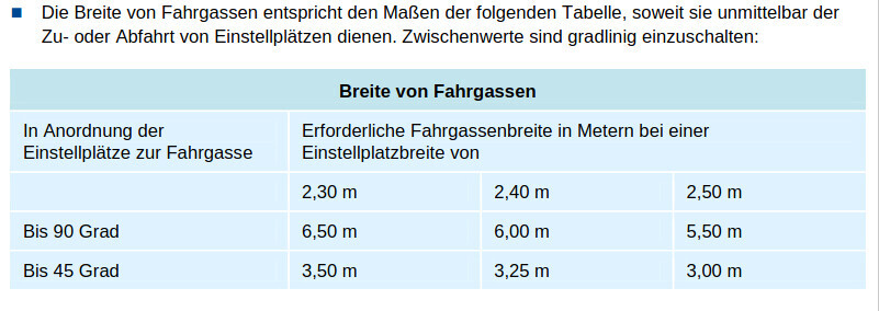

Schnubbihh schrieb:
Are there any tips on how to best plan something like this, specifically how much space a car needs for parking and unparking?
There are some recommendations, for example the following
Table showing aisle widths based on angle (90°/45°) and parking space width 2.30–2.50 m.
With a 4 m (13 ft) carport, you can probably go below 5 m (16 ft), but 2.50 m (8 ft) width won’t be enough. Don’t forget the posts of the carport, as well as any entrance steps or the gravel strip around the house in your planning. Otherwise, any architect should be able to draw the turning radius of a car.
I would plan the turning area so that it can also be used as a guest parking spot. I assume you only need to prove one parking space? Also, where do you plan to store bicycles?
