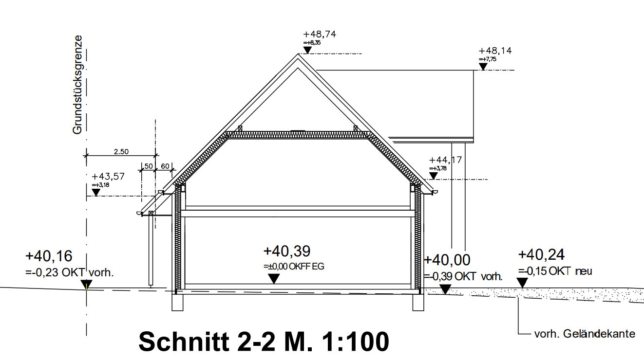

I am currently reading in the thread about the soil survey that you are significantly raising the ground level. 80cm (31.5 inches) of fill, 20cm (7.9 inches) foundation slab, 15cm (5.9 inches) screed build-up... I don’t see this taken into account here at all.
Schnubbihh
4 Jan 2024 09:41
WilderSueden schrieb:
I’m currently reading in the thread about the soil survey that you are raising the ground significantly. 80cm (31.5 inches) of fill, 20cm (7.9 inches) concrete slab, 15cm (5.9 inches) screed build-up... I definitely don’t see that taken into account here.
I’m not sure exactly what you mean by "not taken into account," but I think there might be some misunderstanding. We will not be adding 80cm (31.5 inches) of fill.
WilderSueden
4 Jan 2024 09:58
Your soil report suggests that you will be 80cm (31.5 inches) above the original ground level. I haven’t seen any mention in the thread about excavating the clay layer underneath. Please clarify this confusion. Normally, I prefer having one thread per topic, but I have to agree with 11ant that the information here is quite scattered.
https://www.hausbau-forum.de/threads/interpretation-des-bodengutachtens.46594/#lg=post-650147&slide=1
You need to take this into account when connecting to the existing driveway as well as everywhere the house and garden meet.
Schnubbihh
4 Jan 2024 10:26
Your soil report suggests that the finished ground level will be 80cm (31.5 inches) above the original terrain.
However, this is only the soil expert’s assumption before the architect’s planning was carried out. The final design states that the current finished floor level can be used as is.
Fill material would only be necessary for the terrace or garden area in this case.
