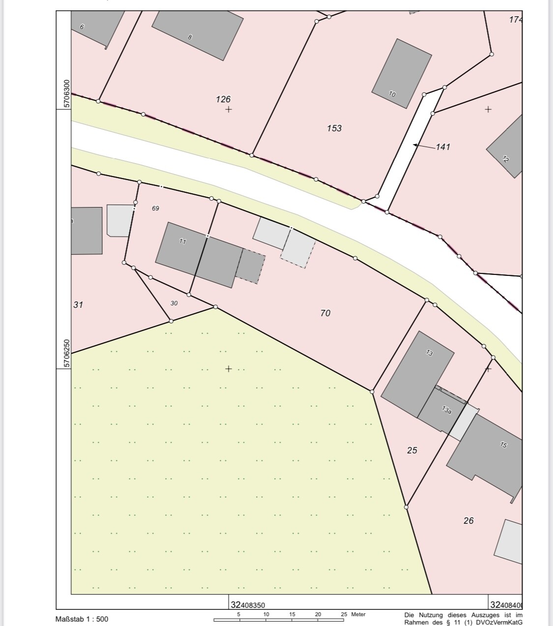

We would, of course, like to build as close to the street as possible to avoid wasting garden space. However, the houses on both sides are set quite far back. (Attachment plot 70)
We will need to submit a building permit inquiry to find out where our house can be positioned.

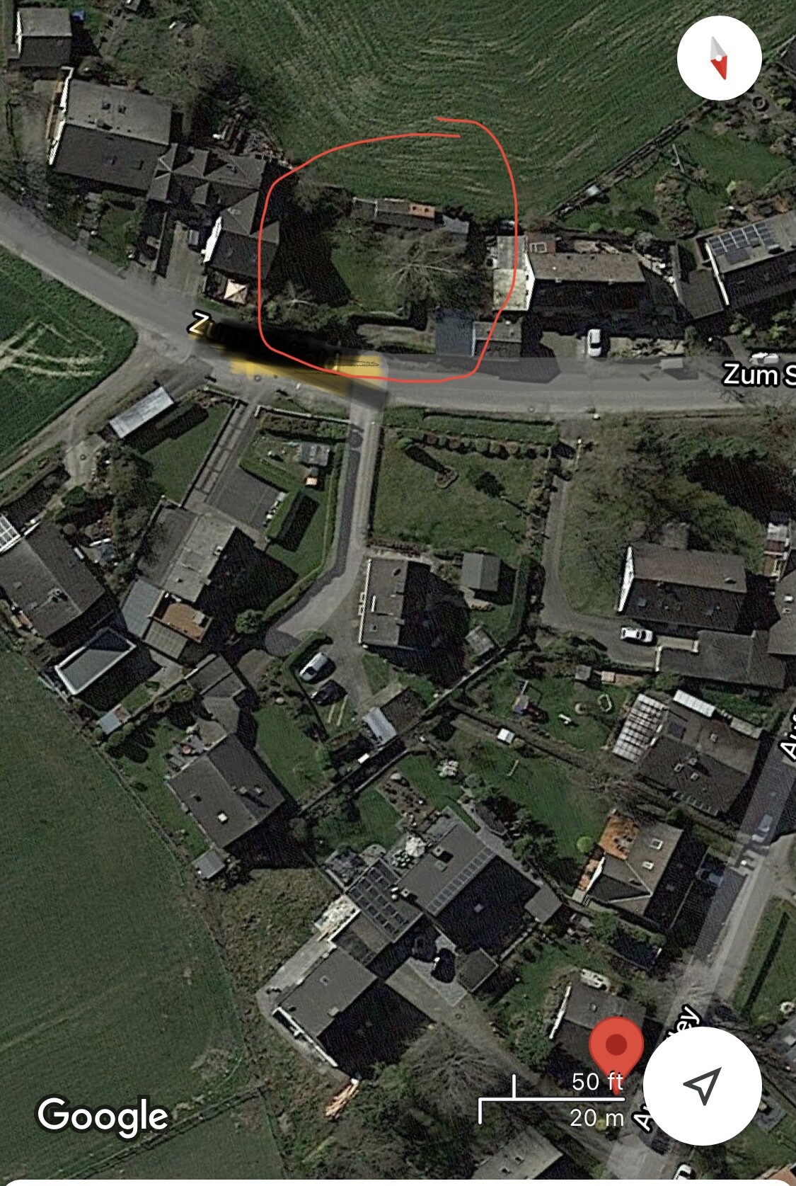

Can you give me your assessment and tips on how to proceed?Show a not too small plot map excerpt, along with an aerial photo.https://www.instagram.com/11antgmxde/
GnortiNRW24 Jun 2021 22:4311ant schrieb:
Please show a larger cadastral section and also an aerial image.Sorry, I uploaded the wrong one. H
hanghaus200026 Jun 2021 08:23Have you already checked the land use plan to see if the plot is located in an outer development area? You might also want to check the geoportal of the federal state. Alternatively, please specify the exact location of the plot here.
