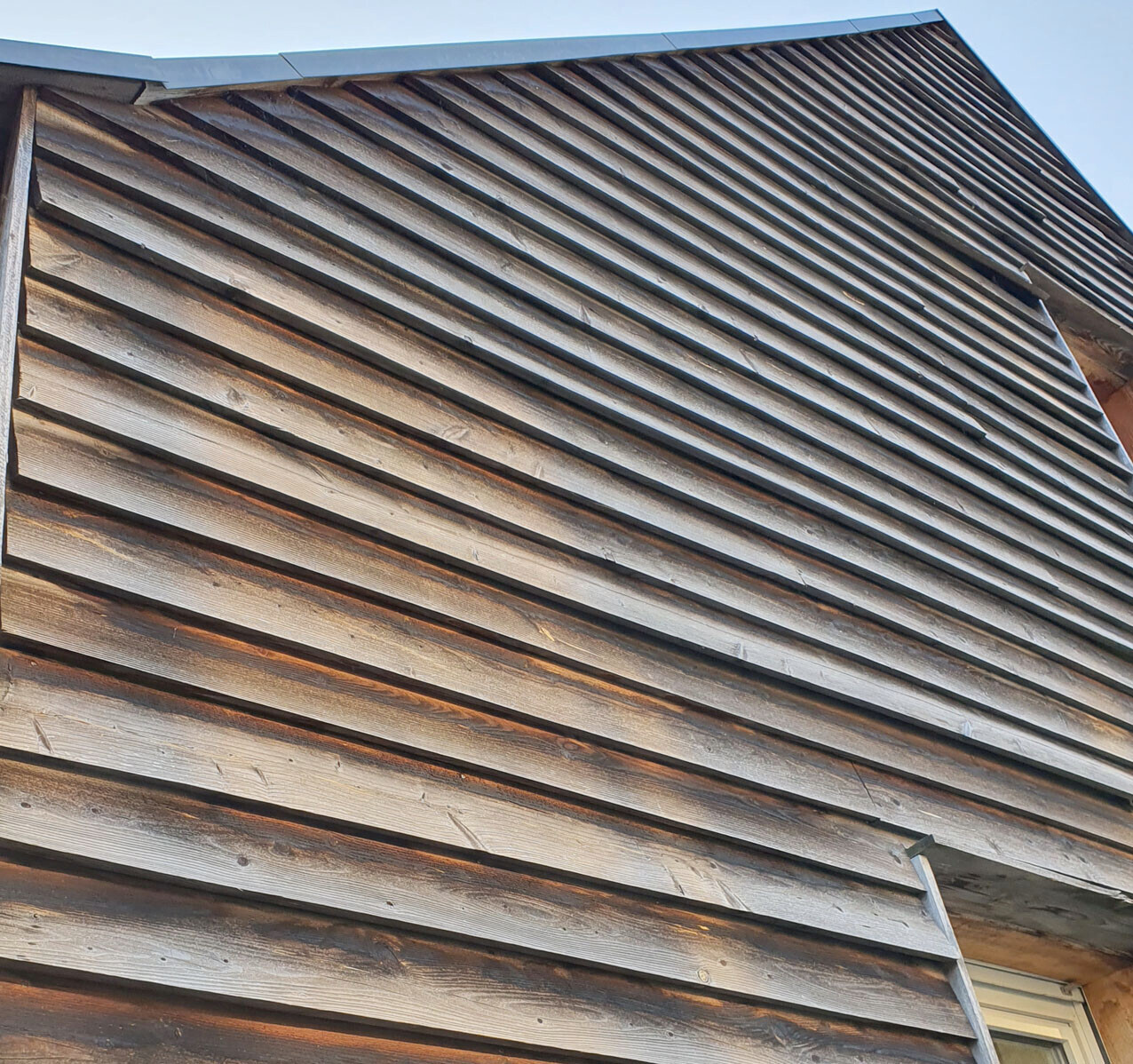

pagoni202010 Jun 2021 23:33Do you have a similar picture of your project?
I prefer rough-sawn boards; you should paint the battens the same way as the membrane behind them, at least on the open joints, I think.
Our plan is similar, with open, gray cladding. But so far, it’s only a rough idea in my mind.
