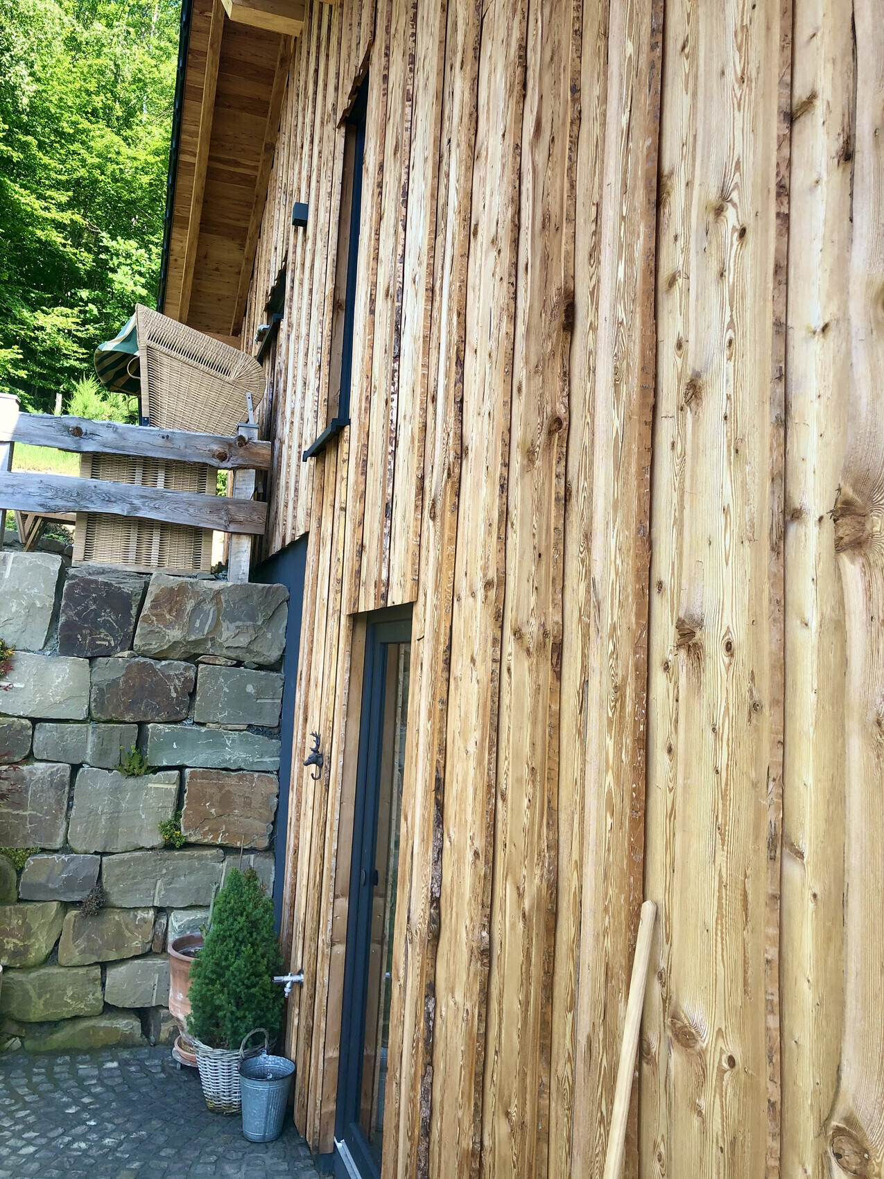

borderpuschl11 Jun 2021 08:09I would definitely apply a filler behind it (this is mainly important in case the knots fall out during drying and you end up with a hole). We used silver fir because Siberian larch was not available knot-free in 5 meters (16 feet).

hanghaus200011 Jun 2021 11:26The idea is that you can see the underlay membrane through the 1cm (0.4 inch) gap. Therefore, I would also paint the battens where they are visible.
