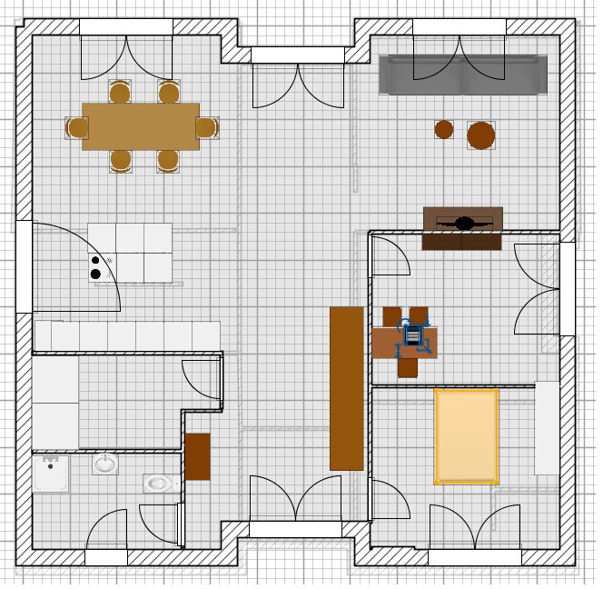

Hi, we are building a house with a very well-known prefab house company, and this is the preliminary floor plan.
Site Plan/Restrictions
Plot size: 1100 sqm (11,840 sq ft)
No site development plan/land use restrictions
Style, roof type, building type – urban villa with hipped roof
Basement, floors – no basement, 2 full stories
Number of people, ages – mom, dad, 2 boys, and grandparents
Office: will be used as a naturopathic practice
Guest sleepers per year: many!
Open kitchen
Number of dining seats: 6
Garage, carport: possibly carport
Wishes/Particulars/Daily routine: shared use of the practice by the client and grandma, who lives in the extension. Possibly a third child (hence a room on the ground floor with a shower).
Who designed it:
- Modified standard plan from a large prefab house company
- Gallery + open ground floor, large floor-to-ceiling double windows
What do you dislike? Why?
- Possibly the living room is too small
Estimated price according to architect/designer:
- approx. 475,000 € (only the house, without land)
Personal price limit for house including fittings: 500,000 €
Preferred heating system: gas boiler and underfloor heating
If you had to give up anything, which details/extensions
- Could give up: possibly different window arrangement, possibly 2 bathrooms upstairs
- Cannot give up: 3rd children’s room and the practice
Why is the design like it is now? e.g.
See above: practice, possibly 3 children, multigenerational house

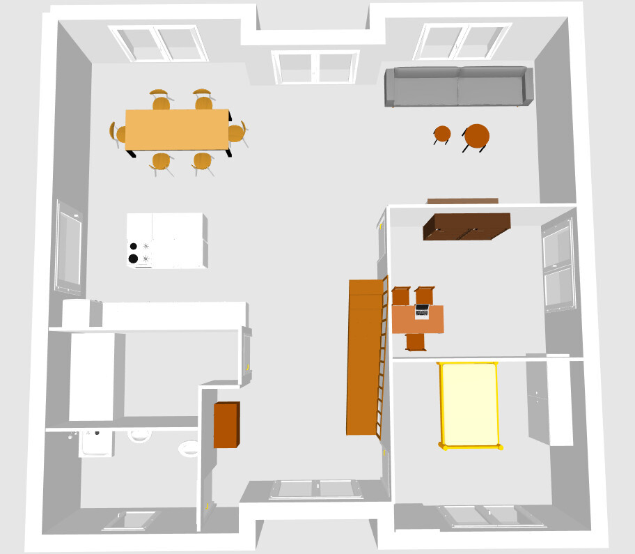

We searched a long time for the ideal house for us and my parents and finally found it. Before signing next week and starting construction, we want a last check. Any improvement suggestions? Maybe how to enlarge the living room? Thanks in advance. PS: we want to remove the windows marked in yellow. All windows in the house are floor-to-ceiling.

I have now requested a utility room in the hallway area between rooms, and it is currently under review and being cost-calculated. Let's see if it will be feasible. Don’t forget to ask whether the pipes can be built over, as I already doubted in #118.
Grantlhaua schrieb:
What exactly is the objection to placing the technical room at the end of this corridor again? I’m afraid it’s a straightforward mental rigidity issue: the homeowners are combining the main house from a one-part design with an extension from a two-part different model – now trying to also relocate the technical room into this extension intellectually (and financially) overwhelms the planners.

Please take a look. What do you think about this option for the main house?
I found out that a door could fit under the staircase.
This way, there would be a larger practice room, a smaller (but still adequate) guest room, a bigger guest bathroom, a cloakroom, and the utility/storage room right next to the kitchen. I think this could be the solution, right?
