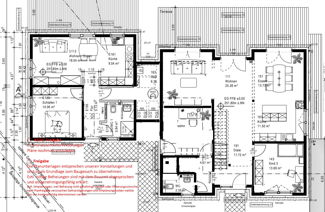

Hi, we are building a house with a very well-known prefab house company, and this is the preliminary floor plan.
Site Plan/Restrictions
Plot size: 1100 sqm (11,840 sq ft)
No site development plan/land use restrictions
Style, roof type, building type – urban villa with hipped roof
Basement, floors – no basement, 2 full stories
Number of people, ages – mom, dad, 2 boys, and grandparents
Office: will be used as a naturopathic practice
Guest sleepers per year: many!
Open kitchen
Number of dining seats: 6
Garage, carport: possibly carport
Wishes/Particulars/Daily routine: shared use of the practice by the client and grandma, who lives in the extension. Possibly a third child (hence a room on the ground floor with a shower).
Who designed it:
- Modified standard plan from a large prefab house company
- Gallery + open ground floor, large floor-to-ceiling double windows
What do you dislike? Why?
- Possibly the living room is too small
Estimated price according to architect/designer:
- approx. 475,000 € (only the house, without land)
Personal price limit for house including fittings: 500,000 €
Preferred heating system: gas boiler and underfloor heating
If you had to give up anything, which details/extensions
- Could give up: possibly different window arrangement, possibly 2 bathrooms upstairs
- Cannot give up: 3rd children’s room and the practice
Why is the design like it is now? e.g.
See above: practice, possibly 3 children, multigenerational house
We searched a long time for the ideal house for us and my parents and finally found it. Before signing next week and starting construction, we want a last check. Any improvement suggestions? Maybe how to enlarge the living room? Thanks in advance. PS: we want to remove the windows marked in yellow. All windows in the house are floor-to-ceiling.

Laufi92 schrieb:
Do you mean further away from the wall?I meant the bedrooms in the extension still need to be moved so that the wardrobe can be placed behind them.kaho674 schrieb:
I meant that in the extension, the bedrooms still need to be shifted so that the closet can fit behind them.I’m just concerned that the space around the bed might become too tight.

Laufi92 schrieb:
I just have concerns that the space around the bed might become too tight No.kaho674 schrieb:

??? That’s exactly what I thought too haha. But apparently, it stands for "Controlled ventilation system."
I just had another idea. The utility room would be accessible from the granny flat. So the semi-detached house could also use it as an extra storage room. Now the challenge is mainly with the layout. If you simply remove the wall between the small storage room and the utility room, you’d get a long corridor. You could also fit a lot of shelves there. Plus, we would save the third front door (to the utility room)!
Laufi92 schrieb:
That’s exactly what I was thinking too, haha. But it apparently stands for "controlled ventilation system."
