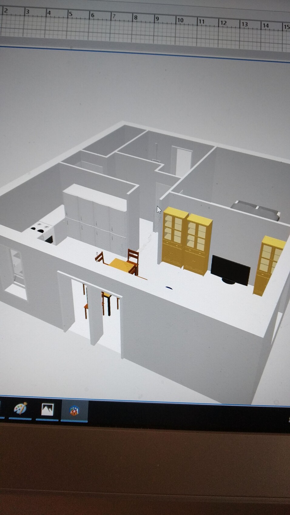

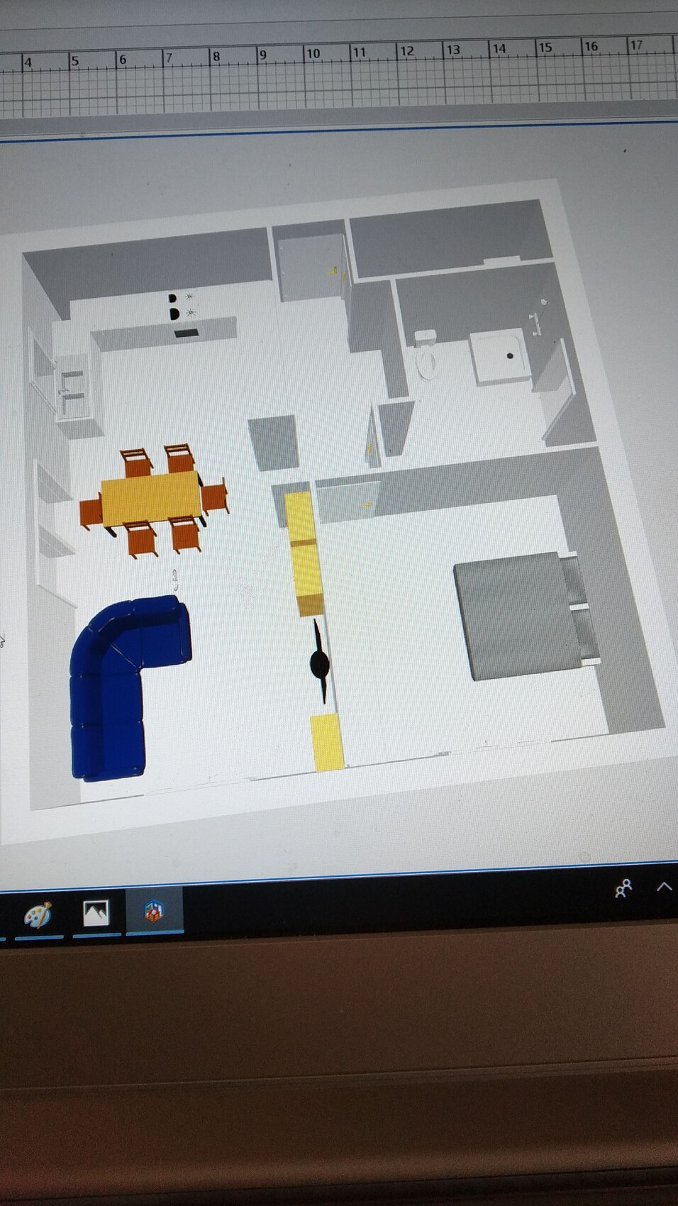

Well, there are quite a few concerns being raised here and there. Considering the size of the extension, I’m also unsure whether it will really be sufficient for the seniors.
One more technical point: I find it most practical to place the utilities in the space between the existing building and the extension. BUT: as shown in the last draft, the pipes would be covered over. I’m uncertain whether that is allowed or advisable. That’s why I am considering moving the entrance of the extension to the front:
This opens up the possibility for a small utility room. Also, the bedroom door can be shifted, allowing for a larger wardrobe space.
Looking closely at the bathroom: although it is adequately sized for such a small apartment, is it really suitable for the seniors? One could keep moving walls between the bedroom and hallway back and forth until reaching a supposed optimum everywhere. But compared to the parents’ ‘paradise’ next door, this really feels quite cramped.
The question is also how flexible the prefab house manufacturers are? (Who exactly are they, can someone please hint at a name?) Furthermore, in my opinion, you should urgently discuss the technical aspects with a professional (e.g., a construction manager or similar) before falling in love with any potential options.
