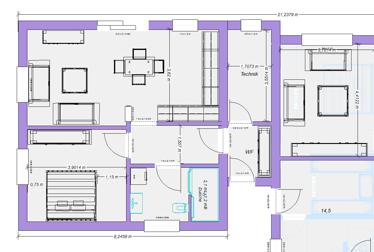

Hi, we are building a house with a very well-known prefab house company, and this is the preliminary floor plan.
Site Plan/Restrictions
Plot size: 1100 sqm (11,840 sq ft)
No site development plan/land use restrictions
Style, roof type, building type – urban villa with hipped roof
Basement, floors – no basement, 2 full stories
Number of people, ages – mom, dad, 2 boys, and grandparents
Office: will be used as a naturopathic practice
Guest sleepers per year: many!
Open kitchen
Number of dining seats: 6
Garage, carport: possibly carport
Wishes/Particulars/Daily routine: shared use of the practice by the client and grandma, who lives in the extension. Possibly a third child (hence a room on the ground floor with a shower).
Who designed it:
- Modified standard plan from a large prefab house company
- Gallery + open ground floor, large floor-to-ceiling double windows
What do you dislike? Why?
- Possibly the living room is too small
Estimated price according to architect/designer:
- approx. 475,000 € (only the house, without land)
Personal price limit for house including fittings: 500,000 €
Preferred heating system: gas boiler and underfloor heating
If you had to give up anything, which details/extensions
- Could give up: possibly different window arrangement, possibly 2 bathrooms upstairs
- Cannot give up: 3rd children’s room and the practice
Why is the design like it is now? e.g.
See above: practice, possibly 3 children, multigenerational house
We searched a long time for the ideal house for us and my parents and finally found it. Before signing next week and starting construction, we want a last check. Any improvement suggestions? Maybe how to enlarge the living room? Thanks in advance. PS: we want to remove the windows marked in yellow. All windows in the house are floor-to-ceiling.

@kaho674
90 cm (35 inches) is not enough if you need aids or assistance. 120 cm (47 inches) is already tight.
For a bed that is 100 cm (39 inches) wide or a 200 cm (79 inches) double bed, you can remove the normal slatted frame and install the mechanism from a hospital bed. A side effect is that it still looks like a bedroom and not like a hospital room.
Since grandma is already in a fragile state, I wouldn't plan based on "it somehow works for now."
haydee schrieb:
90 cm (35 inches) is not enough if you rely on aids or assistance. 120 cm (47 inches) is already tight.
For a bed with a width of 100 cm (39 inches) or a 200 cm (79 inches) double bed, you can remove the standard slatted frame and install the inner components of a hospital bed. The side effect is that it still looks like a bedroom and not a hospital room.
Since grandma is already in a fragile state, I wouldn’t plan with "she’ll manage somehow for now."Wow, I didn’t know that. Our houses with disabled people are all larger, and we never had to measure that.You could still shift the bathroom a little and gain some width. Bed is now 2 m (6 ft 7 in) wide again:
Moving things much more would affect the kitchen and bathroom again.
kaho674 schrieb:
Wow, I didn’t know that. Our houses designed for people with disabilities are all larger, so we never had to double-check measurements.
You could slightly move the bathroom to gain some width. The bed is now 2m (6 ft 7 in) wide again:
Any further adjustments would affect the kitchen and bathroom again. A bungalow works with a walker, and assistance is possible.
A wheelchair won’t fit and isn’t necessary.
Six years ago, I was shocked at how quickly large rooms become tight. There are many gradations between being able-bodied and using a wheelchair.
I think the huge bathroom is beautiful for the parents’ suite – although it's a bit of a shame that it’s used exclusively for the parents, isn’t it? I would also give it up for a third bedroom upstairs if the third child was already here. But if that doesn’t work out, the dream bathroom is gone along with the third child’s room.
Tough decision.
