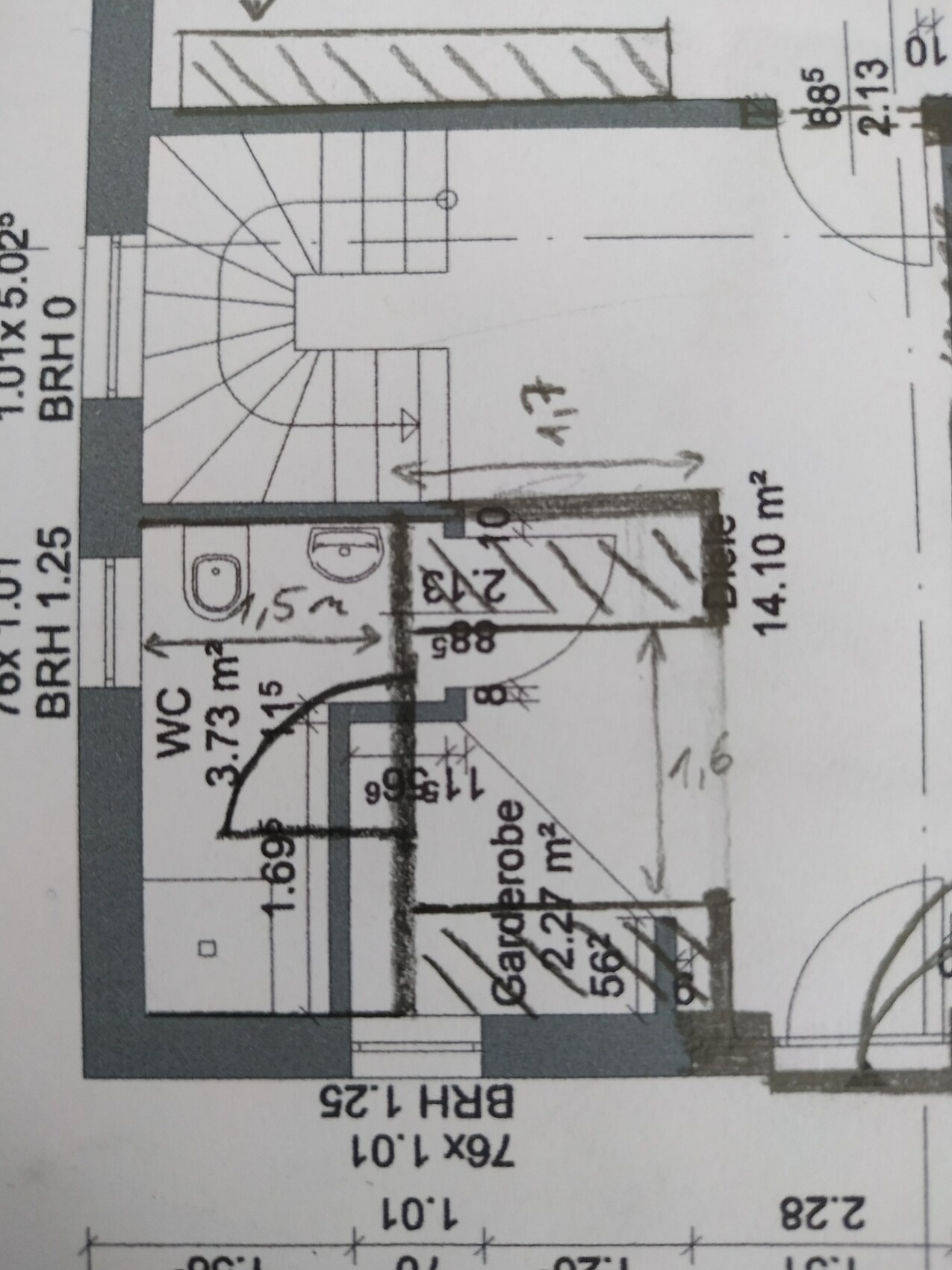

Bauherrin9219 Mar 2019 15:36Thanks @ypg, @haydee
I’m currently furnishing, and some things don’t quite fit, like the coat rack area. The bedroom is too narrow, you’re right about that. I’ve found a solution for the coat rack-guest WC issue and will share it when I get the chance.
But I don’t understand why the pantry is considered too narrow. The shelves for the pantry are all a maximum of 40cm (16 inches) wide. That still leaves over a meter (over 3 feet) of space. I know pantries that work perfectly well with 1.20m (4 feet) width.
I’ve also seen wardrobes that are 1.40m (55 inches) wide. That works fine if it’s intended purely as a “closet room.”
Place your freezer in the pantry and draw it with the door open.
Cupboards with doors are about 65 to 70 cm (26 to 28 inches) deep. That leaves around 75 cm (30 inches) for opening the doors, getting dressed, and carrying in a laundry basket. Without a wall, this tight space would still be comfortable.
Bauherrin9219 Mar 2019 16:08haydee schrieb:
Try placing your freezer in the pantry and draw it with the door open.
Cupboards with doors are about 65 to 70cm (26 to 28 inches) deep. That leaves you around 75cm (30 inches) for opening doors, dressing, and carrying laundry baskets. Without a wall, that would be a comfortable amount of space.There won’t be cupboards with doors in either the pantry or the dressing room, but open shelves instead (essentially a walk-in wardrobe). Sorry, I should have explained that from the start.
Can you make out anything from the picture? There would be space for 2 wardrobes about 1.70m (5 ft 7 in) wide each, with 1.60m (5 ft 3 in) of space between them. The toilet looks "normal" again now. I realize the window as shown won’t work. I’m considering either leaving out the window or moving it further to the right, and placing a bench with storage underneath for everyday shoes.
Edit: To achieve the 1.7m (5 ft 7 in) width, I’ve slightly shifted the front door. I’m not sure whether that’s possible, but if not, the width would still be around 1.40m (4 ft 7 in).
Maybe you should just design the whole thing yourself. I think your latest sketch is better than any draft from the general contractor.
This way, the podium will work as well. Your windows are still all a bit off—I would leave the one in the cloakroom as is and just place a shoe cabinet under the windowsill there. You can adjust the other windows later.
Just make the pantry a bit deeper. It won’t harm the kitchen and will give you a lot more space there. Maybe you don’t want a refrigerator in the pantry right now, but wait 10 years. Then you might change your mind and regret it.
