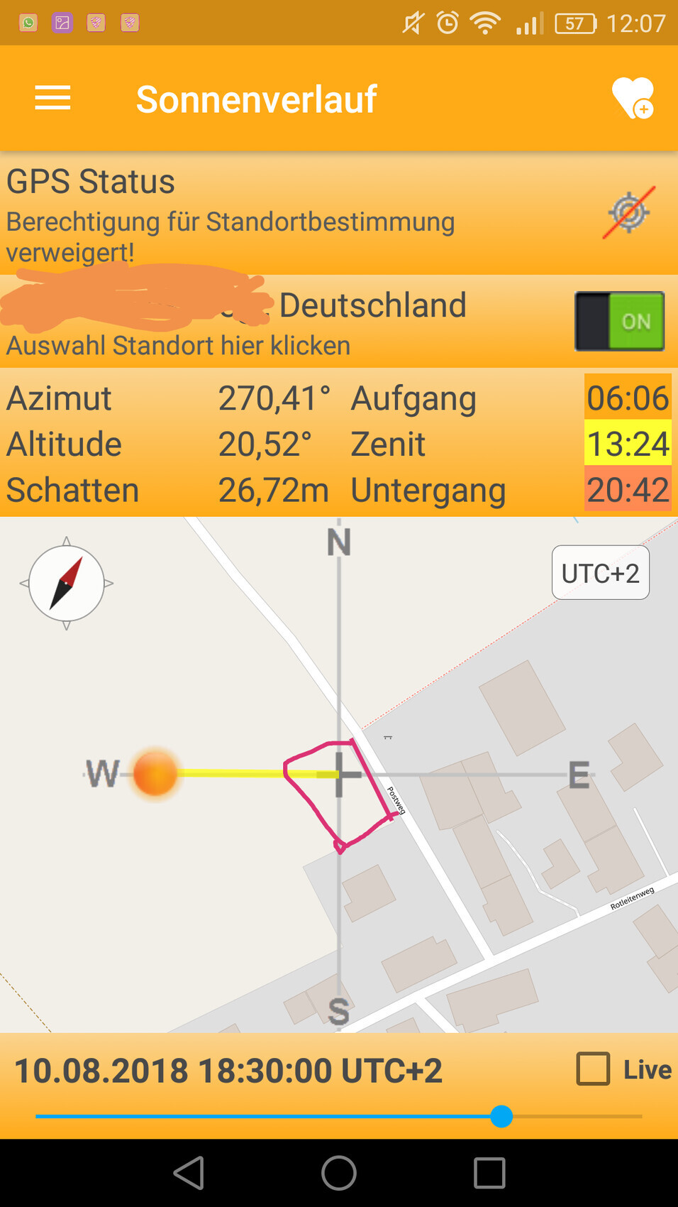

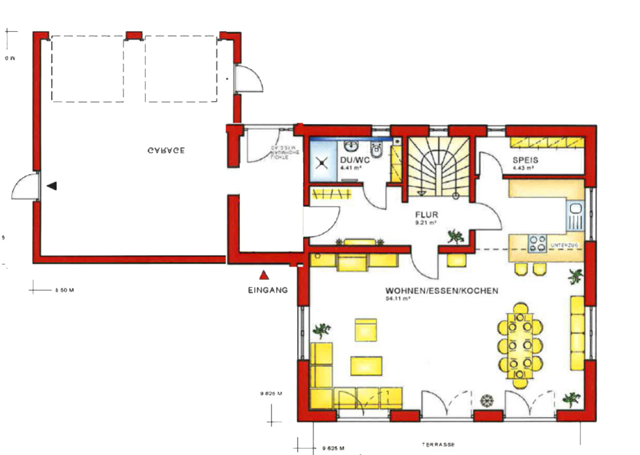

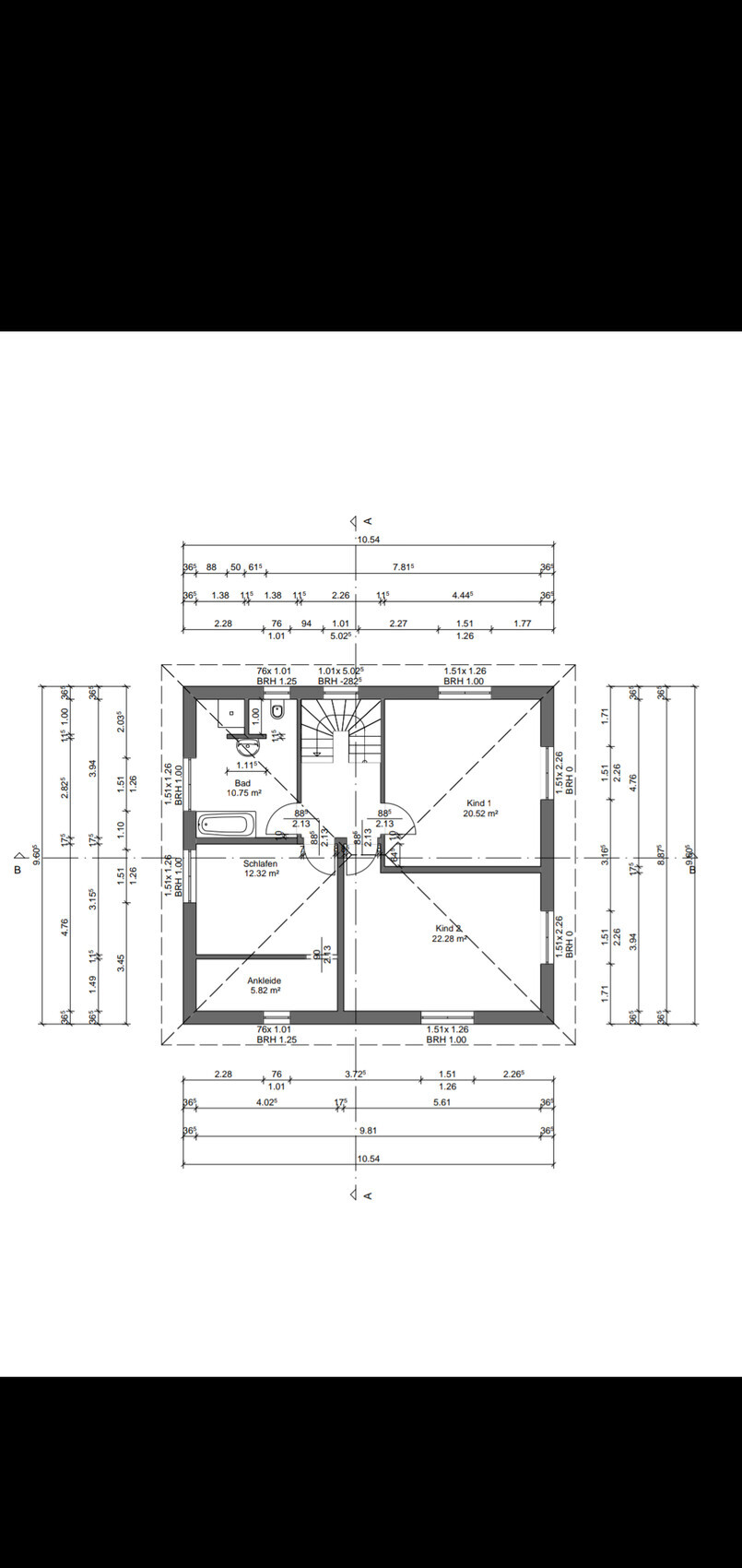

we are planning to build an urban villa with 160 sqm (1720 sq ft) plus a basement in rural Bavaria. Since we are now in the crucial phase of floor plan design, we would really appreciate your opinions and suggestions for improvements.
The following issues concern us the most:
1. Arrangement of the house and garage on the plot: The garage has been deliberately placed on the west side to create distance from the neighbor. To catch the evening sun, the house has been set back. However, I wonder if this looks "good," as I have never seen such an arrangement before. We are also undecided whether the garage should be detached or attached to the house (possibly with access through the pantry?). On the plans, the garage is at the neighbor’s boundary. There is currently no house there.
2. The cloakroom and dressing room seem too small to comfortably place proper wardrobes and move around freely.
3. In general, I feel the overall design could still be improved, including the arrangement of windows.

Who made the plan: planner from a construction company
- Basement: fine as is
- Ground floor: large pantry, L-shaped kitchen/living/dining area
- Upper floor: large children’s rooms
What don’t you like? Why?
- Ground floor: layout of toilet and cloakroom
- Upper floor: dressing room and bathroom possibly too small
- detached garage

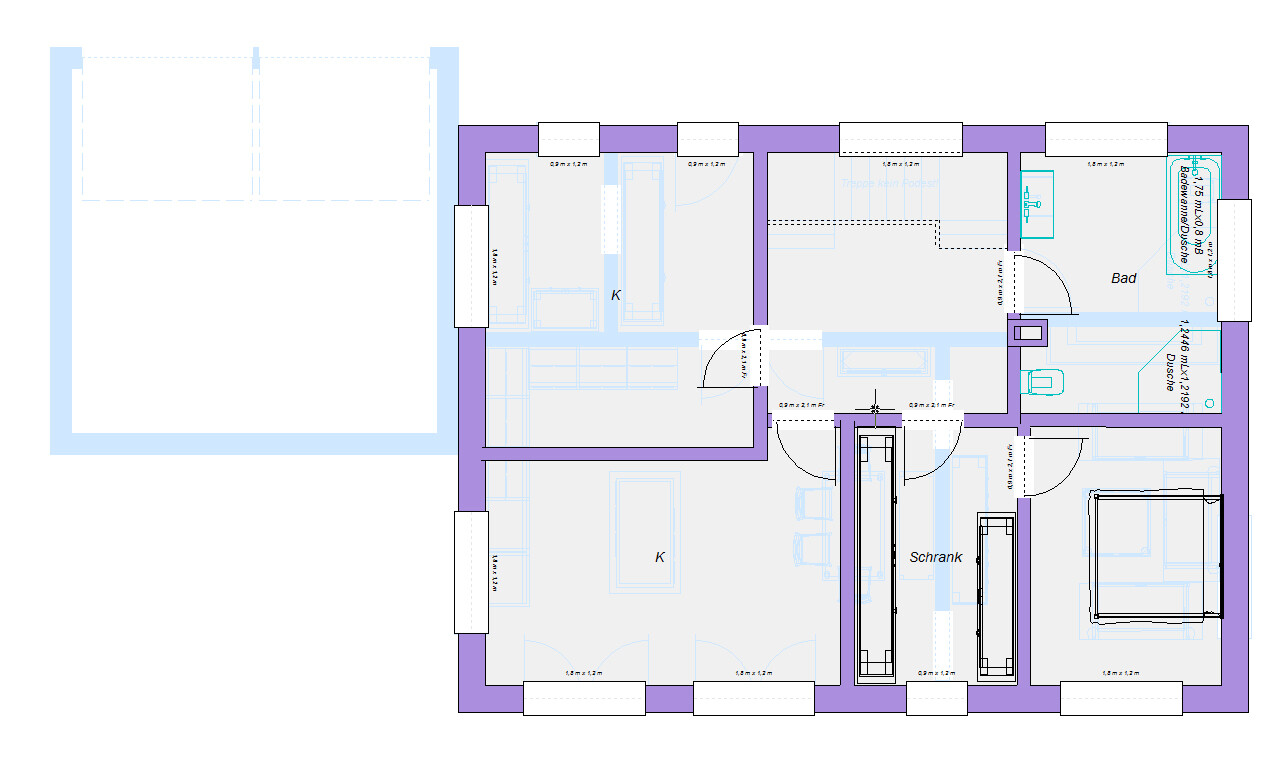

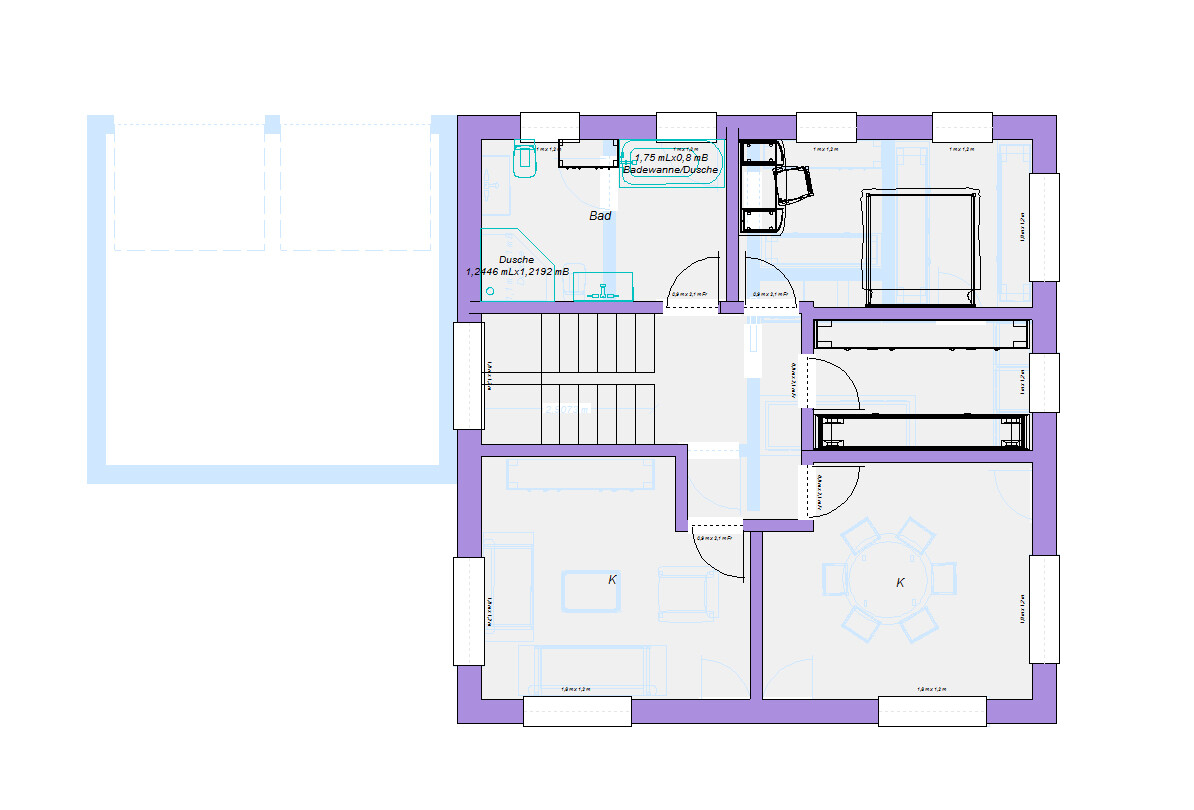

The bathroom had to give way to make room for the cabinets.
It has to come from somewhere.

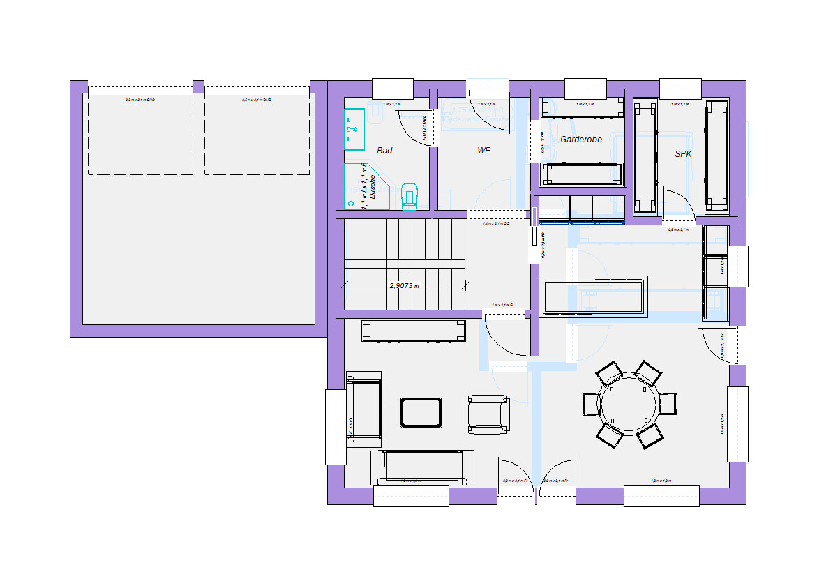

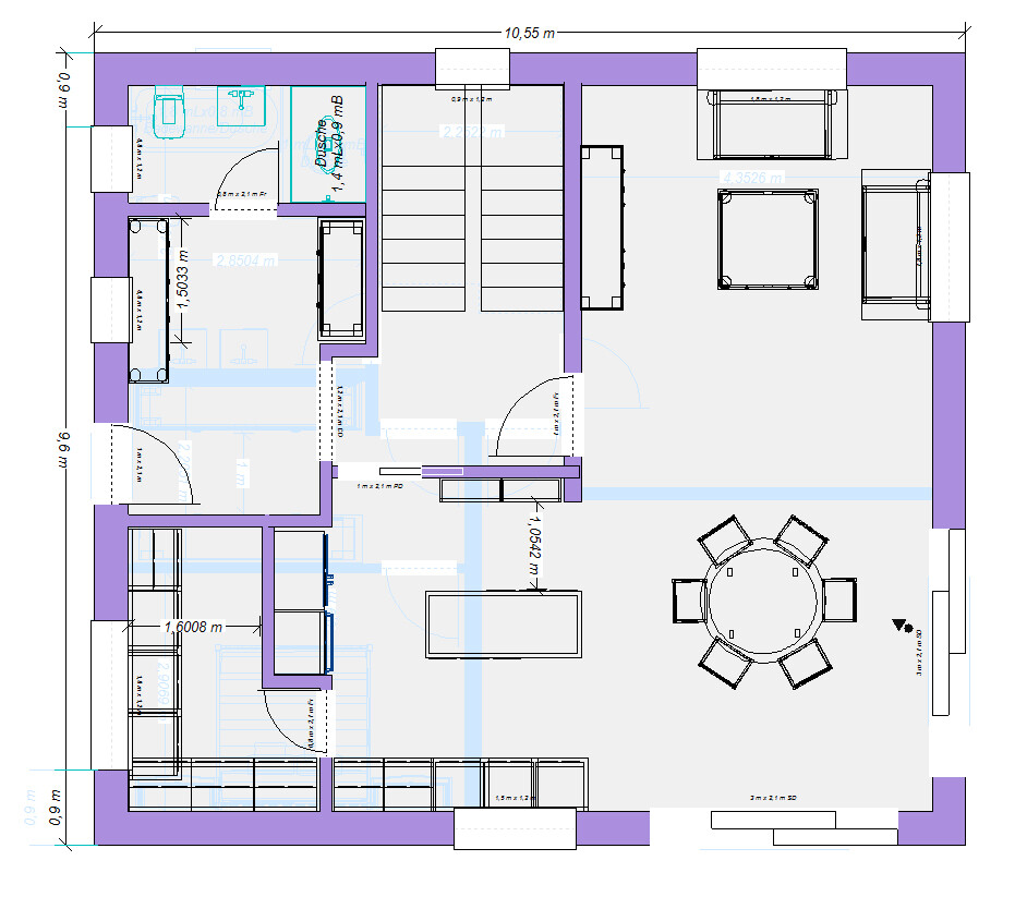

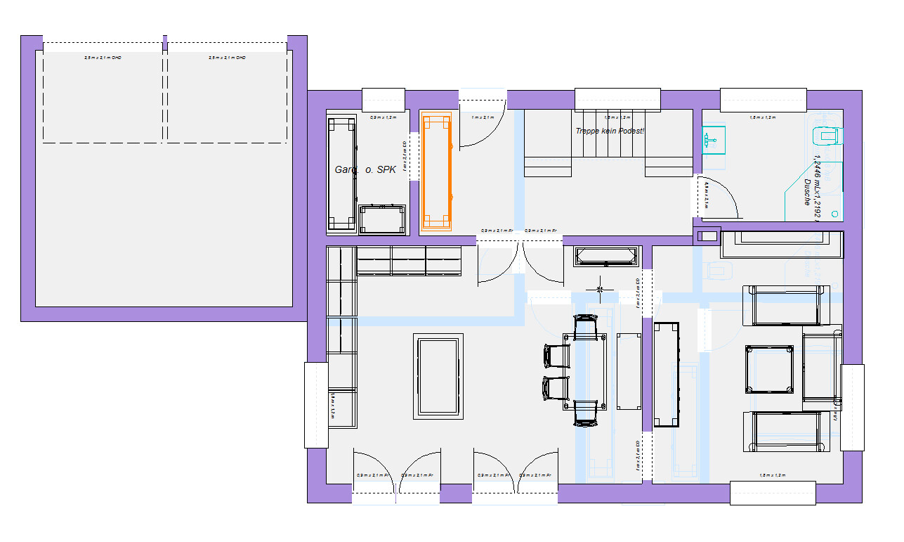

On the ground floor, maybe something more like this:
However, there won’t be space for a chest of drawers in the hallway—just some small shelves in the kitchen instead.

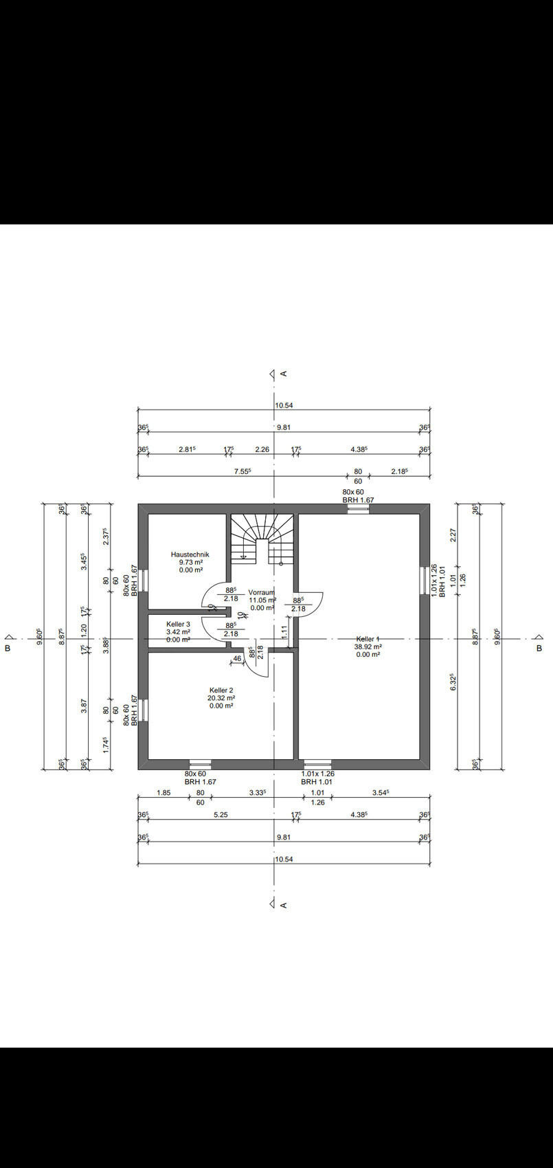

I think you once said the slope on the building site was negligible. What exactly are we talking about here?
If I were you, I would take a closer look at the whole elevation issue. This way, you can see what options remain for the expensive large basement (which we definitely need to review thoroughly). It might also be helpful to look at the soil survey and check how well your ground absorbs water.

Bauherrin9221 Mar 2019 09:24@kaho674 thanks for the great floor plan!
I spoke with the general contractor, and he said we will receive the plans WITH the changes (stairs, windows) today. I’m looking forward to seeing them.
I will then incorporate the points mentioned here along with my sketches and post them here.

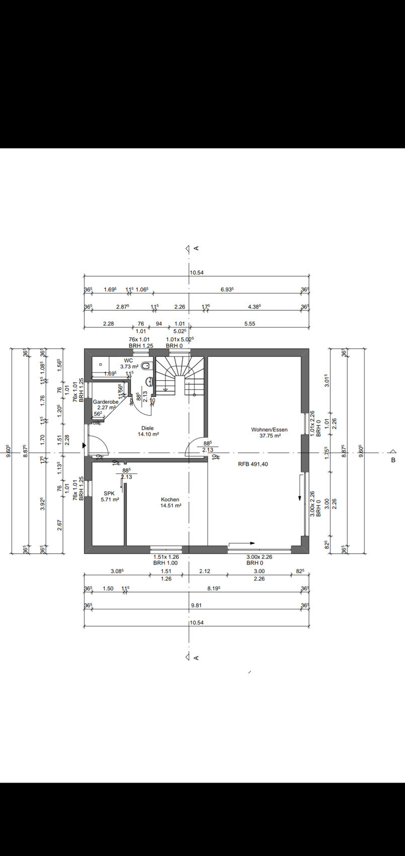

Bauherrin9229 Mar 2019 08:05kbt09 schrieb:

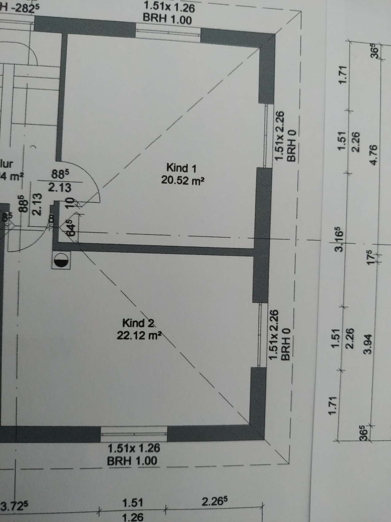

@Bauherrin92 .. so, are the new plans ready or has the order been given to proceed again based on kaho’s plans?My husband doesn’t like kaho’s plans. So, the only changes will be the guest toilet/wardrobe and the windows. To implement the stair landing, the doors to Child 2’s room and the bedroom had to be moved slightly backward. We are now waiting for the (hopefully) final plans.
However, another issue concerns me… the chimney. I think its position is very inconvenient, especially for Child 2’s room. As an alternative, the chimney or fireplace could be placed on the ground floor to the left of the sliding patio door, directly on the exterior wall. Then, it would be located in the upstairs corner (exterior wall) in Child 1’s room.
Are there required clearance distances between the chimney and furniture or curtains?
