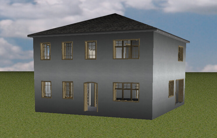

Here is the front view with optimized windows.
Two-story gray house with many windows and an open front door standing on green grass.
Do you really want 3m (10 feet) sliding doors in the living room? I’m not very familiar with this, but when we built our house, it was said that doors that large often cause problems. Has that changed?
