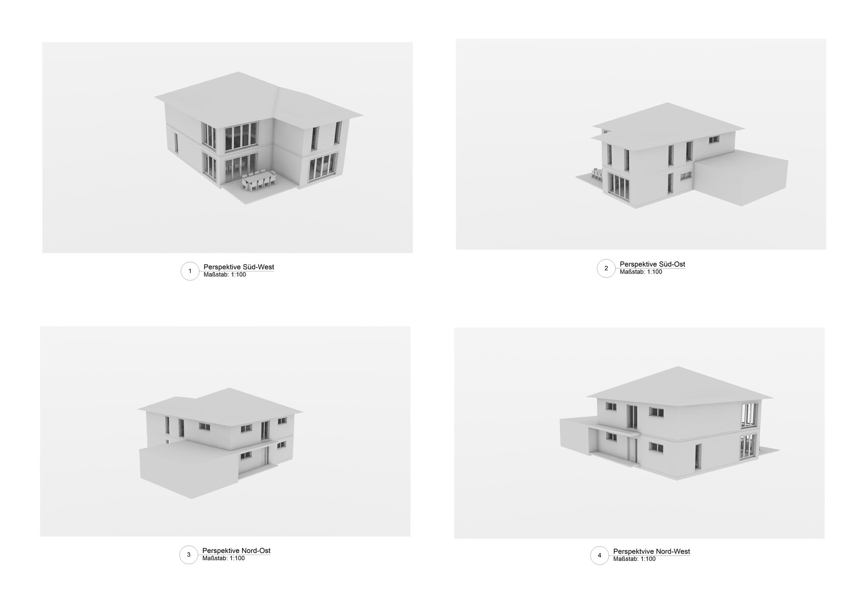

I would also like to use the knowledge and ideas from this forum to optimize my design. I appreciate honest feedback and criticism on my self-created draft :-)

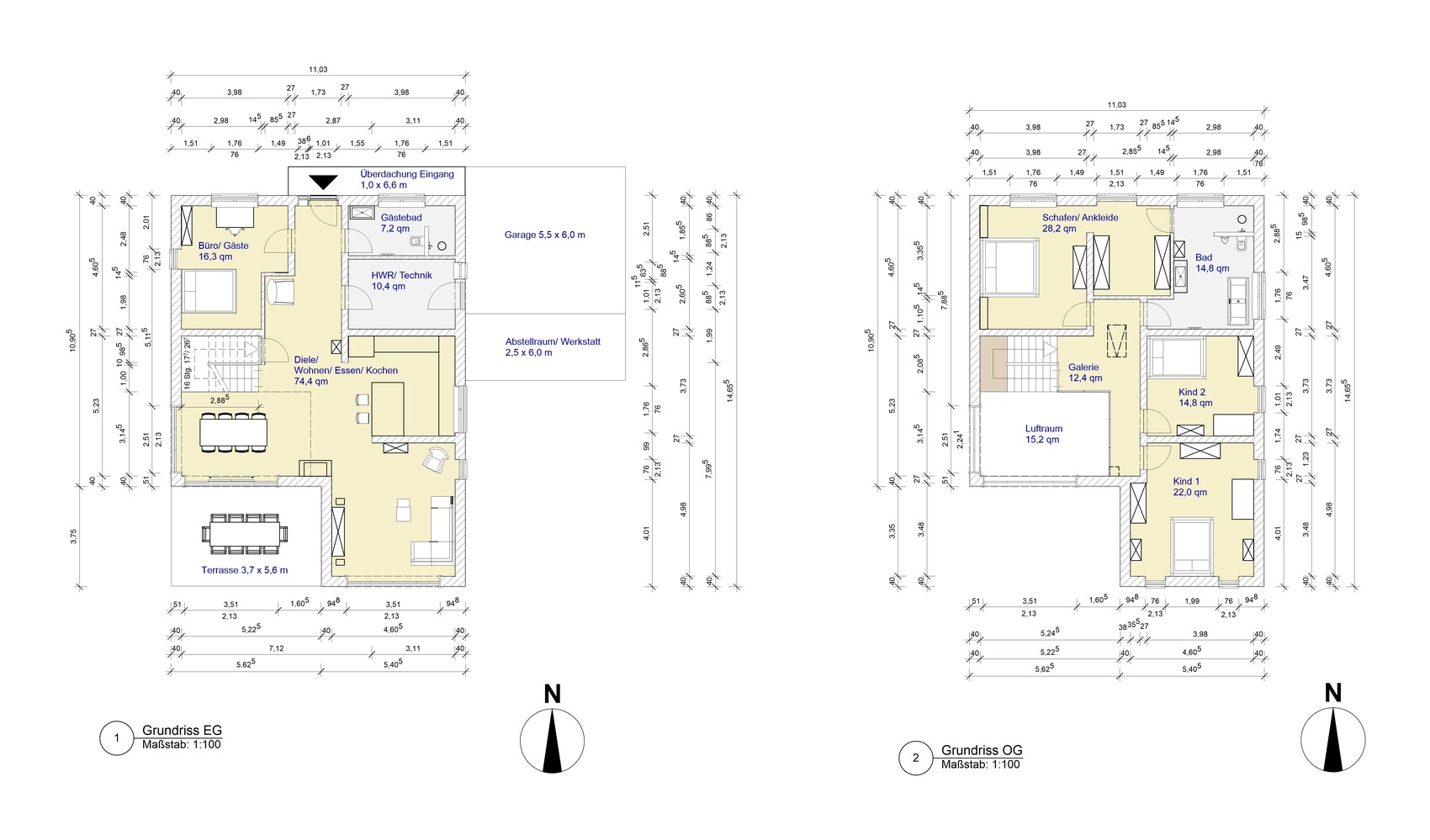

hampshire1 Jan 2021 21:10The design includes many elements whose appeal I can well understand. However, much of this makes a target price of €2000 per square meter (approximately $186 per square foot) very unlikely. It’s better to add about 20% to that estimate. I fully agree with the points made by @haydee.
Who is supposed to clean all of this – especially the windows? 😱
haydee schrieb:
The budget should be too tight even for Lower Saxony. Which district is it? And near which city?
Louisa324 schrieb:
For the budget, I initially estimated 2000 €/sqm (approximately $185/sqft). That would be 400,000 plus additional costs and contingency. For a straightforward, practical design, that should be about right. Not here: there are hardly any load-bearing walls in the living area. Then a complex roof, lots of window surfaces, fireplace, angled sections...
Is it supposed to be only 200 sqm (2150 sqft)?
Regarding the design itself: the kids’ rooms are at a very noisy corner, they will hear everything live from below.
The kitchen seems too small for the size of the open-plan area and feels cramped.
The dining area is narrow, storage space for four people is insufficient, and none upstairs.
The cloakroom for four people doesn’t fit under the stairs and would be an obstacle in the hallway.
Walk-in closet: adding a door to the hallway and extending the walls would gain about 50% more storage space.
The shower in the main bathroom is quite short.
I would estimate the staircase length to be at least 3 meters (10 feet). If the ground floor ceiling height increases, then naturally even longer.

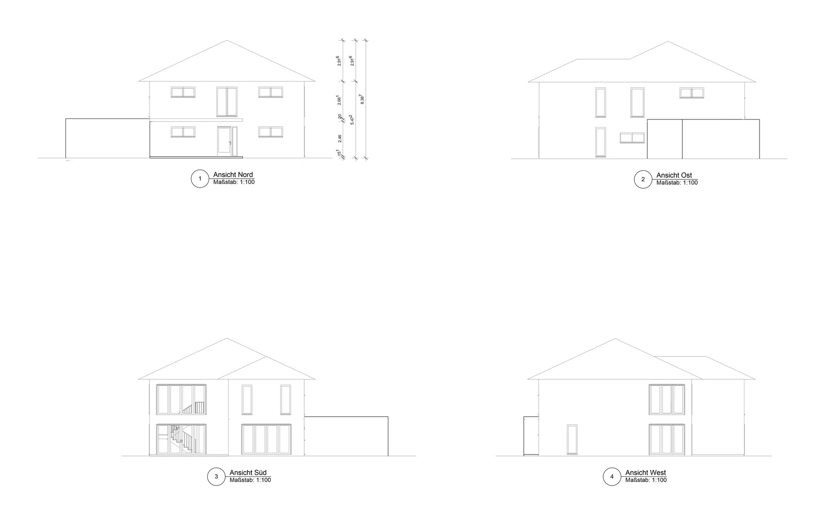

In my opinion, the window front does not fit there. It looks too bulky and does not match in shape and components. And the 76 mm (3 inch) windows are generally very narrow. They let in hardly any light, and if they do, only a rather narrow strip.

I am also still undecided about the windows. At first, I planned all 76mm (3 inches) windows at 1 meter (3.3 feet) wide. I will change that back again.

The previous responses were quite politely phrased—I hope they have already conveyed the necessary points. Just in case they haven’t:
here is the unvarnished version:
You are not planning 200 sqm (2,150 sq ft), which would already be generous for a family with unborn children, you are planning 214 sqm (2,302 sq ft) PLUS a 48 sqm (516 sq ft) garage/workshop! And still, with this nominal spaciousness, a children’s room of only 14 sqm (150 sq ft)… it’s good that this raises doubts for you… 😉
So:
really consider the gallery; as beautiful as it may be, it is a major source of wasted square meters.
The single bedroom is too small, as already pointed out, mainly because the staircase is on the wrong side. Try moving the staircase to the east instead of facing the “chocolate west.” The projection (which I personally like because it creates a very nice terrace situation) must be better utilized upstairs than by an oversized children’s room. A possible solution: a recessed area with a terrace on the projection and a partial overbuild of the ground floor terrace by a second child’s room.
Ground floor: It might be worth swapping the dining and enlarged living areas... but there are many options here.
Upper floor: There are nice, clear floor plans with 5 x 17 sqm (2 x children’s rooms, master bedroom, one bathroom plus one dressing room/hall), which would already save 20 sqm (215 sq ft) just upstairs...
these usually have a slightly elongated shape.
