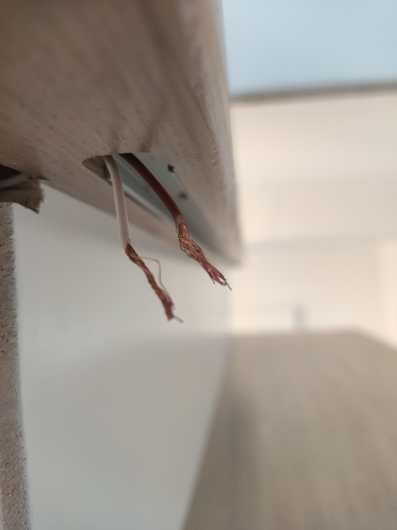

I want to install lighting for stair treads.
The stair builder has already recessed an aluminum profile for the LED strip into each tread.
A two-core cable runs to each stair tread.
Now, I would prefer not to solder the cable directly to the pads of the LED strips.
Is there a neat and simple way, such as crimping, to connect the cable to the strip?

Google "led strip connector," first result (or any other in the list). There are many options available, often including tool-free solutions.
The classic clamp connector does not fit into the aluminum profile, or if it does, the frosted glass cover no longer fits into the profile.
I would prefer a plug-in solution that I can prepare in the workshop and only need to insert into the stair tread. Furthermore, this would make it easier to replace the profiles in the future if one is damaged.
