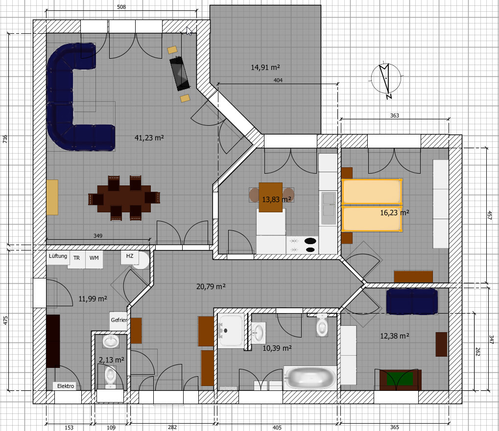

Hello, we now have our first "professional" floor plan.
It was created by a construction company, based on our wishes and a "standard" bungalow from another builder. We will also receive a detailed plan with the same layout from them. What do you think about it? The requirements were:
- Entrance on the side where the carport will be located (east)
- Laundry/utility room access toward the carport
- Living room and kitchen with access to the terrace, which faces south
- Guest toilet is a must
- Space for a staircase (as a reserve) in the hallway, but not too large...
All criteria are clearly met, but we welcome any tips or advice.
Thank you

melodyman schrieb:
I just signed up because my floor plan looks similar. I think the current layout is quite good.
Maybe space for a larger utility room could be created by reducing the size of the entrance area.
Does the bedroom really have to be on the south side?
I also don’t like the angles in the living room. Is the space for the TV just symbolic? Yes, the bedroom should face south, and it has a floor-to-ceiling window for that.
The TV will go on the wall facing the covered terrace, and the dining area is at the front of the living room. From there, with the sliding door open, you can look into the kitchen.
The angle in the living room was also in the builder’s example and, as mentioned, it brings some light into the dining area.

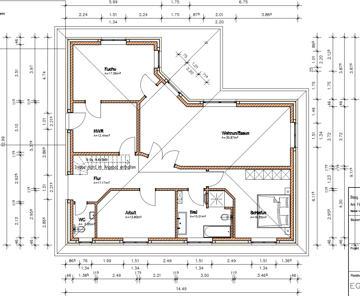

melodyman25 Sep 2016 10:46Hello again. Did you use the most recently submitted floor plan, or did you make any changes? I would really appreciate it if you could upload your final floor plan. Many thanks!
melodyman26 Sep 2016 16:03Thank you! It looks good.
