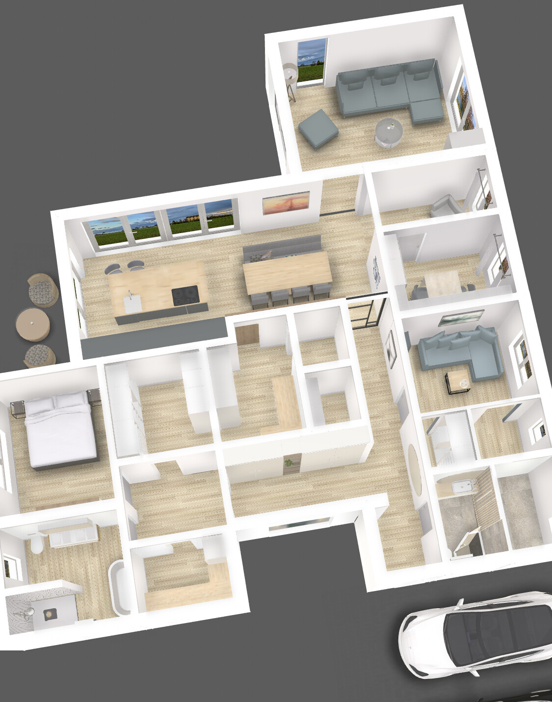

I’ll show you your "entrance area" from the front door
[ATTACH alt="Screenshot 2022-12-28 at 18.53.27.png"]77237[/ATTACH]
It looks terrible. Thanks! The app presents it more nicely. Thanks for that

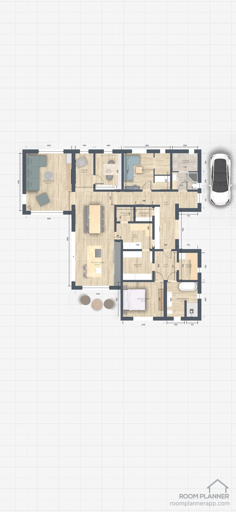

28 Dec 2022 19:07
I hope the dimensions are clearer here. But you’re right, I’d better consult a professional.

You can’t even get to the front door because the car is parked right in front of it.
The front door is actually next to it, by the porch (if you want to call it that).
3D floor plan of house with kitchen, dining area, living room, bedroom, bathroom; car in front of house
mayglow28 Dec 2022 21:23
I’m not very good at creating floor plans either, but there are several things here that don’t seem right to me. The reading nook feels narrow and uncomfortable. The many small rooms in the center, mostly intended for storage, but where no closets really fit? (Am I seeing this correctly that the utility room has four doors? I’m not sure about the layout. Sliding doors and one door through a closet?) I don’t understand the walls in the children’s room. Why not remove all that and place a closet against the wall, leaving space to play? (Am I oversimplifying?) Does a proper wardrobe even fit there? If this “only” concerns the parents’ area, I find it odd that the laundry area has a window but the walk-in closet doesn’t. Also, if I’m interpreting the drawing correctly, the utility room has a passage to the other side, so I’d skip the passage to the walk-in closet and instead take more storage space in both the closet and the utility room... but honestly, I don’t like this whole layout at all, so, um. Depending on the view, the shower can also seem hard to enter, but I’m not sure if it really works dimension-wise....
My overall feeling is: throw it away and start from scratch.
