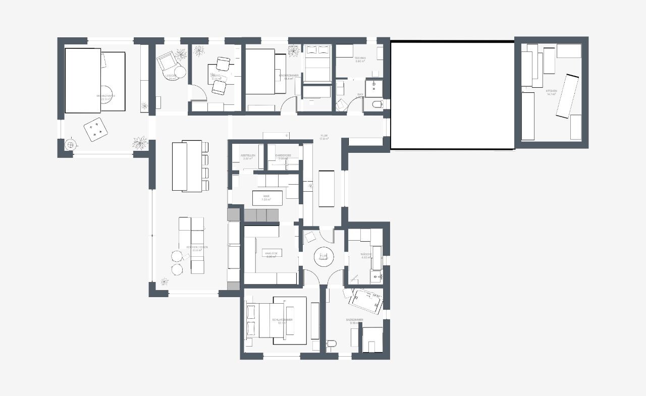

Z
Zweithaus27 Dec 2022 17:34Zweithaus schrieb:
Here is the complete design.

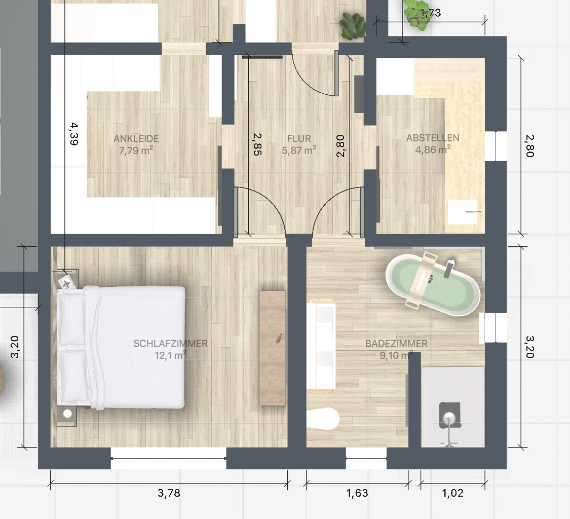

I am looking for a solution to better arrange the rooms in the master suite area to eliminate or better integrate the entrance hall. Wow, without dimensions, one wonders if this is a house plan or modern art.
Before we repeat ourselves... you should:
- add dimensions
- remove rugs, frills, and decorations, allowing only basic furniture
- give clear, legible room labels (because none of this is readable) and please use contrasting colors
All this out of respect for those viewing it so the plan doesn’t become indistinct — in other words: for the forum.
So we are ultimately still talking about https://www.hausbau-forum.de/threads/grundriss-bungalow-meinungen.38376/ – continued in https://www.hausbau-forum.de/threads/bungalow-grundrissplanung-optimierung.38475/ – continued in https://www.hausbau-forum.de/threads/bungalow-grundriss-3-personen-130qm-bitte-meinungen.39827/?

Z
Zweithaus27 Dec 2022 18:20ypg schrieb:
Oh, without dimensions, one wonders whether this is a house design or modern art.
Before we start repeating ourselves,... you should:
- add dimensions
- remove rugs, fancy decorations, and ornamental items, and only include basic furniture
- provide clear and readable room labels (because none of that is readable) and please use high contrast
All this out of respect for those who are viewing it, so everything doesn’t blur together, that is, the forum. Better like this? I know I won’t get applause for the floor plan, but to me it’s functional. Only the master area is too complicated. Once again… for me.
SoL schrieb:
Back to square one and starting over; you don’t need to think about details at this stage of the design. No, thank you – “back to square one” is exactly the path where the original poster keeps getting stuck endlessly.
Zweithaus schrieb:
Since it is a mixed-use area, we are free from restrictions.
A bungalow, because the plot allows it and it’s well suited for old age. It’s also practical with children to have everything on one level.
