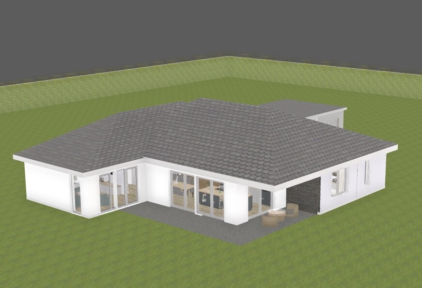

Only the master area is too complexThe only part that is not complex is the bedroom. Everything else would be called complex, if you can tell. It looks like you just attached rooms all around the old design with the huge corridor.What I'm really curious about is the actual exterior dimensions of this bungalow and what the roofing solution will look like. The placement on the plot would also still be interesting. Then, where the entrance is located, what features are planned for the hallway in front of the master area, and how the child's privacy will be maintained 😉.

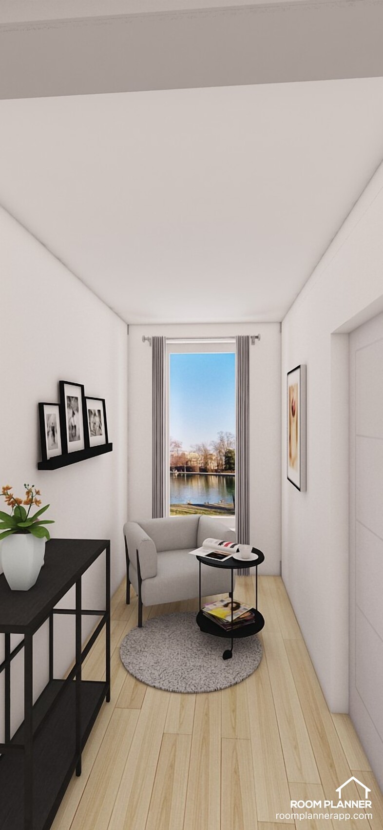

The child’s room is far from the parents’. The reading area is too small to fit a bookshelf. An office space is placed between the children’s room, dining area, and living room—so you can supposedly keep track of everything?

I’m really curious about the actual exterior dimensions of this bungalow and what the roof design will look like. It would also be interesting to know the placement on the plot. Then, where the entrance is located, what is planned for the hallway in front of the master area, and how the child’s privacy is maintained 😉.The entrance is on the east side, facing the street. A light switch is planned in the walk-in closet.
The books for the reading corner are kept in the office, which is used during the day when no one else is home.

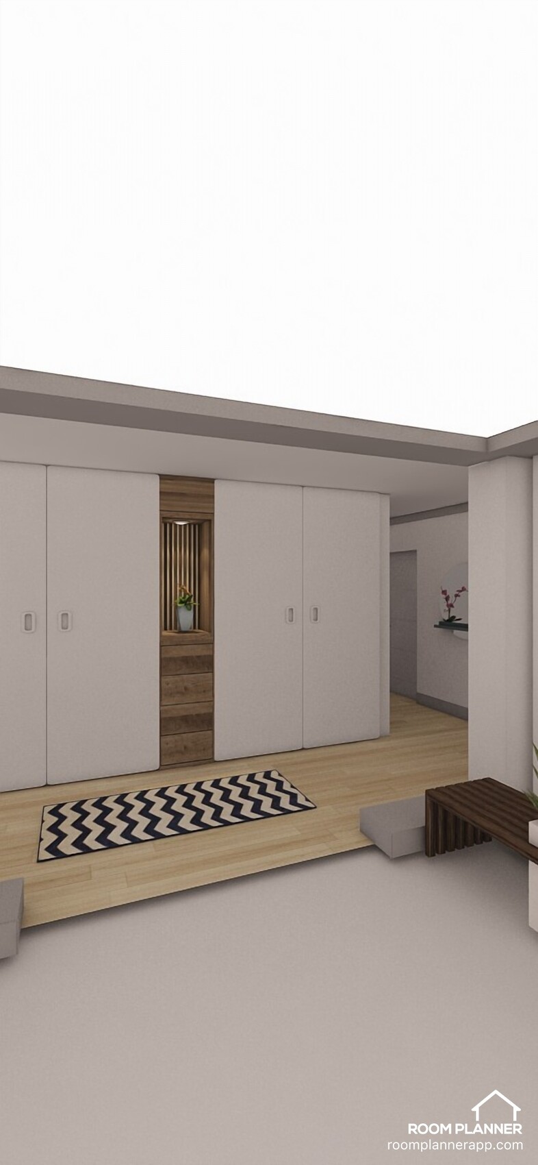

Why is there space for a wardrobe about 4 m (13 feet) wide at the entrance, and then such a tiny cloakroom behind it?
The reading area... who is supposed to read there? You have a separate living room, a kids’ room, and an office... who would sit in the hallway to read?
