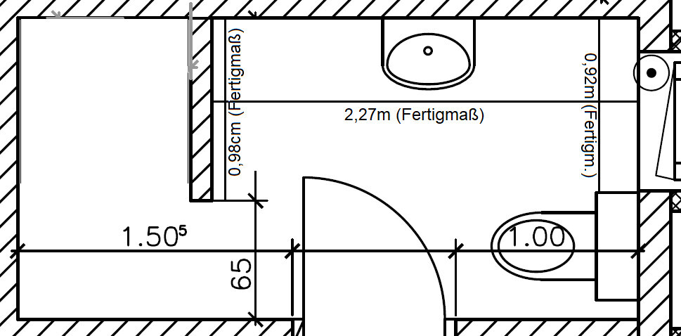

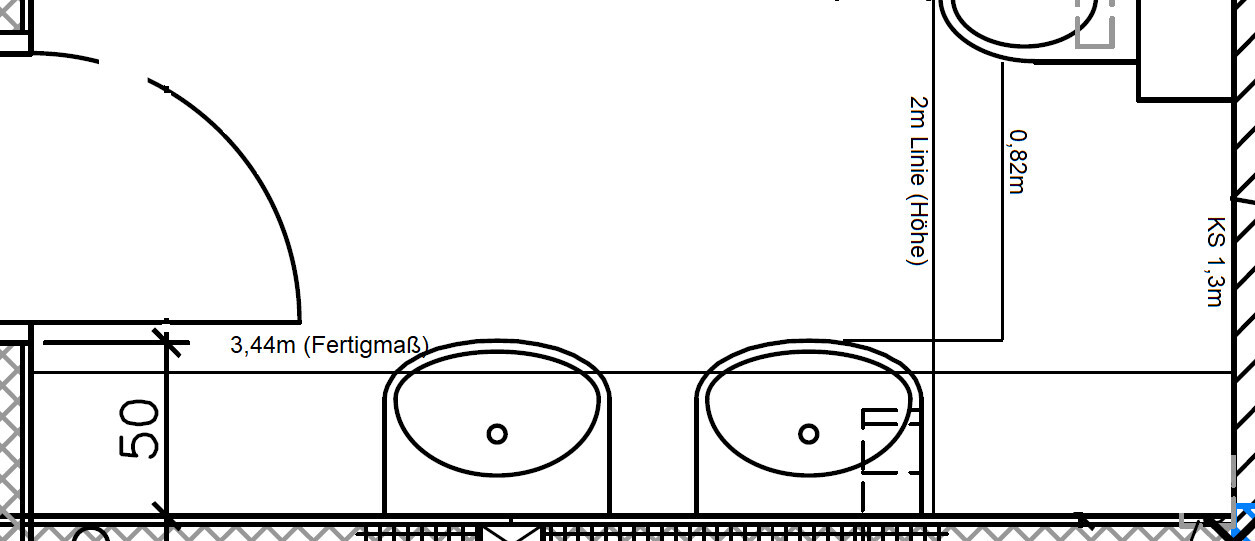

I have attached floor plan sections with measurements. We will have countertop sinks with a depth of about 46cm (18 inches). These will also be anchored to the wall.

we are currently looking for suitable furniture for our bathrooms, especially for the walls with the sinks, and hope for your tips and experiences 🙂
