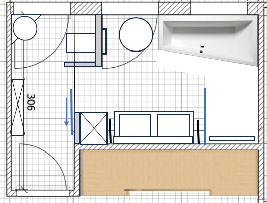

we are currently gutting our new apartment and would like to start planning the bathroom. We are facing some challenges in how to best divide the space and would appreciate your support.
I am attaching the floor plans of the apartment. Our goal is to include a guest toilet if possible and practical given the limited space. There is an option to enlarge the bathroom by about 25 cm (10 inches), moving the wall further into the kitchen.
The main requirements for the bathroom are:
  • Toilet (ideally also a urinal, if feasible)
  • Large washbasin with mirror cabinet
  • Walk-in shower (at least 1 x 1 m (3 ft 3 in x 3 ft 3 in), preferably larger)
  • Bathtub
  • Heated towel rail
  • Niches, for example in the shower, for storage
  • Enough space for a shelf and a laundry basket
The window height in the bathroom is approximately 95 cm (37 inches) from the finished floor level, so installing a toilet at this location is generally possible. Additionally, there is a 10 cm (4 inches) thick wall panel running along the entire wall. Inside the bathroom wall, there are 2 x DN110 HT pipes in the corners on the window side. Thanks to the raised floor and suspended ceiling in the bathroom below, the pipes can be routed almost anywhere.
The bathroom entrance can be modified to create a rectangular room if this looks better aesthetically.
If you have any creative ideas for space-saving or especially functional layouts, we would be very grateful! We are open to suggestions and look forward to hearing about your experiences.
Thank you in advance!

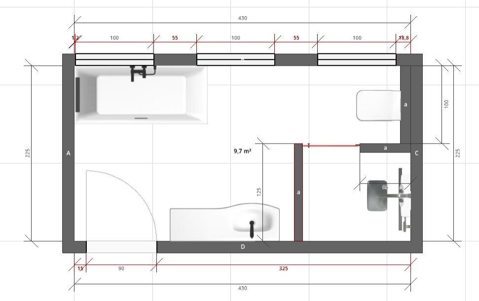

fisherman12 schrieb:
That’s clear.
We are planning with a separate WC for now.
We would reduce the size of the washbasin a bit, as well as the bathtub.
Make the shower slightly larger, with a recessed niche in the wall.
And have the bathroom door open inward, if that still works with the sliding door.
OK, I understand.
How big is the washbasin? But with a vanity cabinet underneath?
A shower of 1.4 x 1.14 meters (4 ft 7 in x 3 ft 9 in) is already quite large.
The 1.6-meter (5 ft 3 in) bathtub is a sitting tub. You probably don’t really want that.
Here is the version without the separate WC.
Floor plan of a bathroom: bathtub on the left, washbasin at the bottom, WC on the right, door bottom left.
Or should I continue with the version including the separate WC?
Unfortunately, I cannot save two versions.

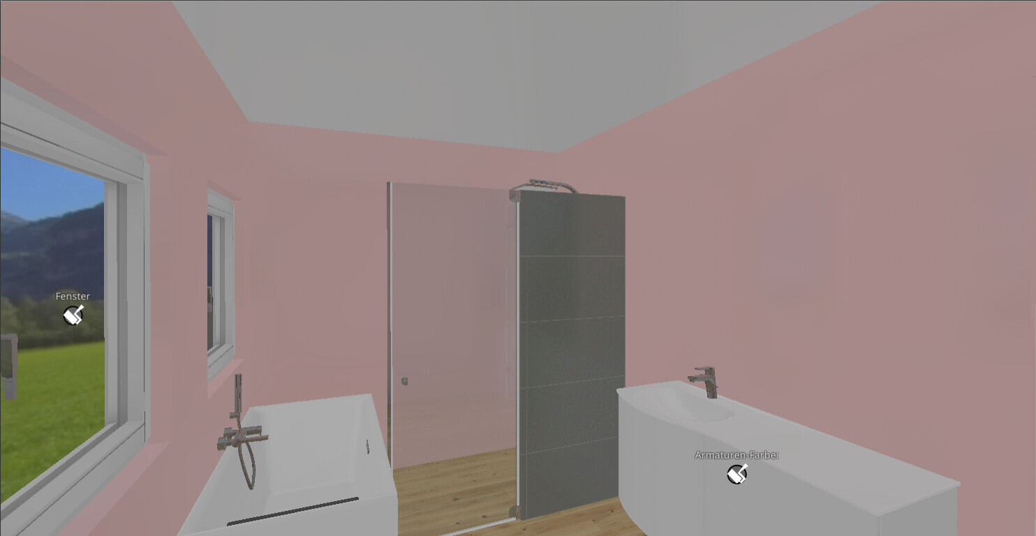

A fully lockable door is not possible in this case.
Bathroom with pink walls, bathtub, sink, shower, and window with a view of greenery.
Bathroom with pink walls, bathtub on the left, gray cabinet, shower enclosure, window with a view.
A simple and practical solution is a quarter-circle shower curtain. This way, you don’t have to constantly clean glass panels, and the curtain can be washed once a week in the washing machine.

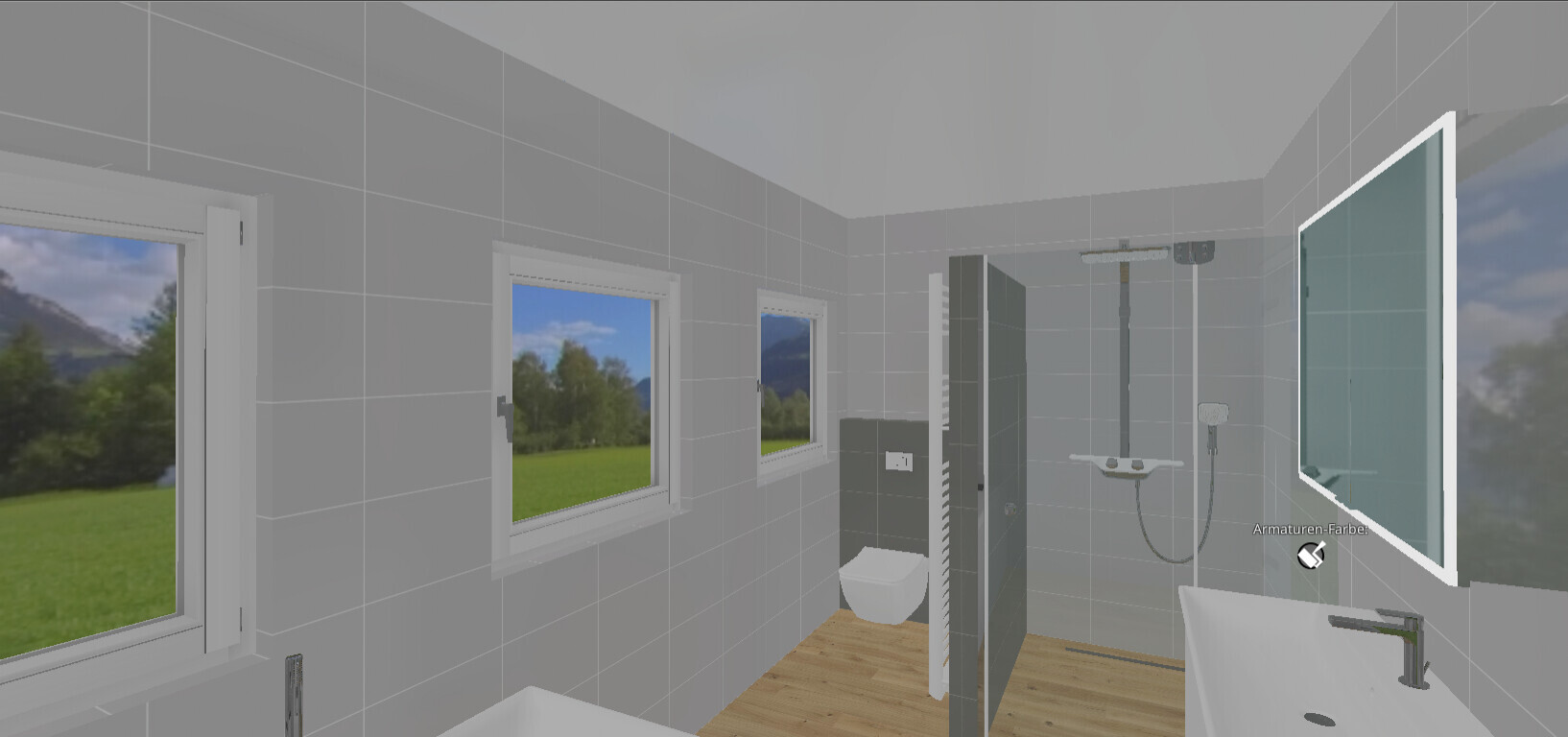

Here is a warning example fully tiled. Honestly, I prefer to tile only where necessary. However, this is difficult to do in the bathroom design software.
Modern bathroom with gray tiles, two windows, toilet, shower enclosure, and sink.
