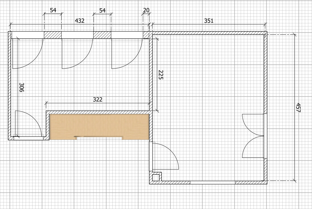

we are currently gutting our new apartment and would like to start planning the bathroom. We are facing some challenges in how to best divide the space and would appreciate your support.
I am attaching the floor plans of the apartment. Our goal is to include a guest toilet if possible and practical given the limited space. There is an option to enlarge the bathroom by about 25 cm (10 inches), moving the wall further into the kitchen.
The main requirements for the bathroom are:
The bathroom entrance can be modified to create a rectangular room if this looks better aesthetically.
If you have any creative ideas for space-saving or especially functional layouts, we would be very grateful! We are open to suggestions and look forward to hearing about your experiences.
Thank you in advance!
- Toilet (ideally also a urinal, if feasible)
- Large washbasin with mirror cabinet
- Walk-in shower (at least 1 x 1 m (3 ft 3 in x 3 ft 3 in), preferably larger)
- Bathtub
- Heated towel rail
- Niches, for example in the shower, for storage
- Enough space for a shelf and a laundry basket

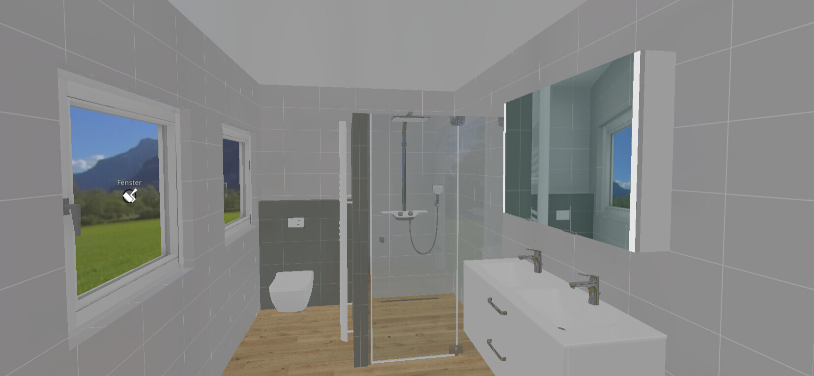

hanghaus202327 Nov 2024 13:08The shower partition is built with drywall construction, which also allows for installing a niche.
F
fisherman1227 Nov 2024 18:23hanghaus2023 schrieb:
Here is an example with a double washbasin 120cm (47 inches) wide and a mirror cabinet. A liquid soap dispenser will be mounted on the wall.
Also a very nice option. The decision will be difficult. 😀

[IMG alt="gut2.png"]https://www.hausbau-forum.de/data/attachments/88/88402-fa69023244daf8c70c66aea6c8c1715d.jpg[/IMG]
The door stays as it is and does not shift inward.
The room is enlarged by 25cm (10 inches) (the wall by the shower moves 25cm (10 inches) towards the kitchen).
Rotate/mirror the area of the bathtub and laundry basket?
The built-up wall in front of the toilet (outer wall) could be omitted since the drainage can be moved into the drywall partition.
It would also work if only the built-up wall at the bathtub is installed, for the faucet plus a niche for storage.
Are there options to hide the hot water meter well? Maybe install it in the toilet above?
hanghaus202327 Nov 2024 23:39The hot water meter needs to be placed where the hot water enters before it is distributed within the apartment.
I don’t quite understand what changes you would like.
Why move the wall toward the kitchen? The bathroom is sufficiently large.
Which option do you prefer? After looking at the visualization, I still don’t find the separated toilet appealing.
Please mark your changes on the corresponding draft. It’s enough to draw them in with a pen.
