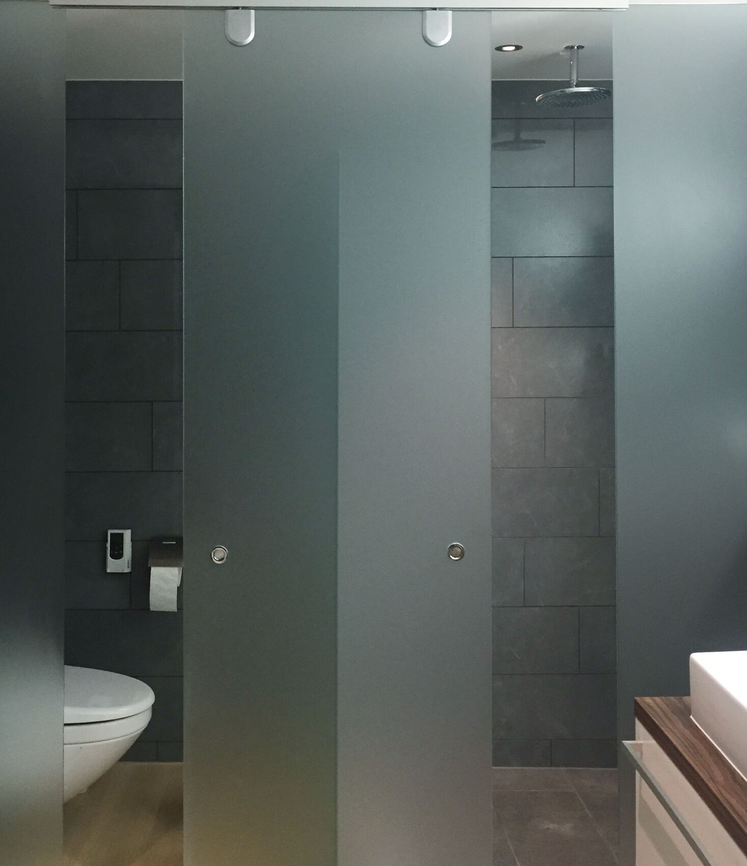

The door to the toilet just barely opens. Please imagine or check at home how you enter and then close the door behind you. You have to be careful with your stomach and knees because it almost hits the toilet bowl. You could install a space-saving door, but that is also a compromise.Honestly, I’m not sure if it’s allowed to post a picture from the internet, but I don’t know how else to explain the idea — a sliding door for the shower and also for the toilet ... maybe an option for you?
The sliding door seems to me to be almost the most elegant solution. Otherwise, Climbee has already made many important points.

Martial.white11 Sep 2020 08:50The best solution is definitely the sliding door... but with my clumsiness, I would be most worried about my bare toes in the bathroom.
Secondly, no one would be able to shower while the shy partner is on the toilet, because then the door would be closed on the other side and the water would splash out.
If someone is in the shower, it doesn’t really matter if the toilet door is open, since you’re basically “separated.”
It becomes more relevant when the toilet door is closed while someone is at the washbasin, or when someone just needs to grab or bring something into the bathroom...
If you can close the toilet door, you don’t have to lock or “block” the entire bathroom...
That’s how I would put it...
