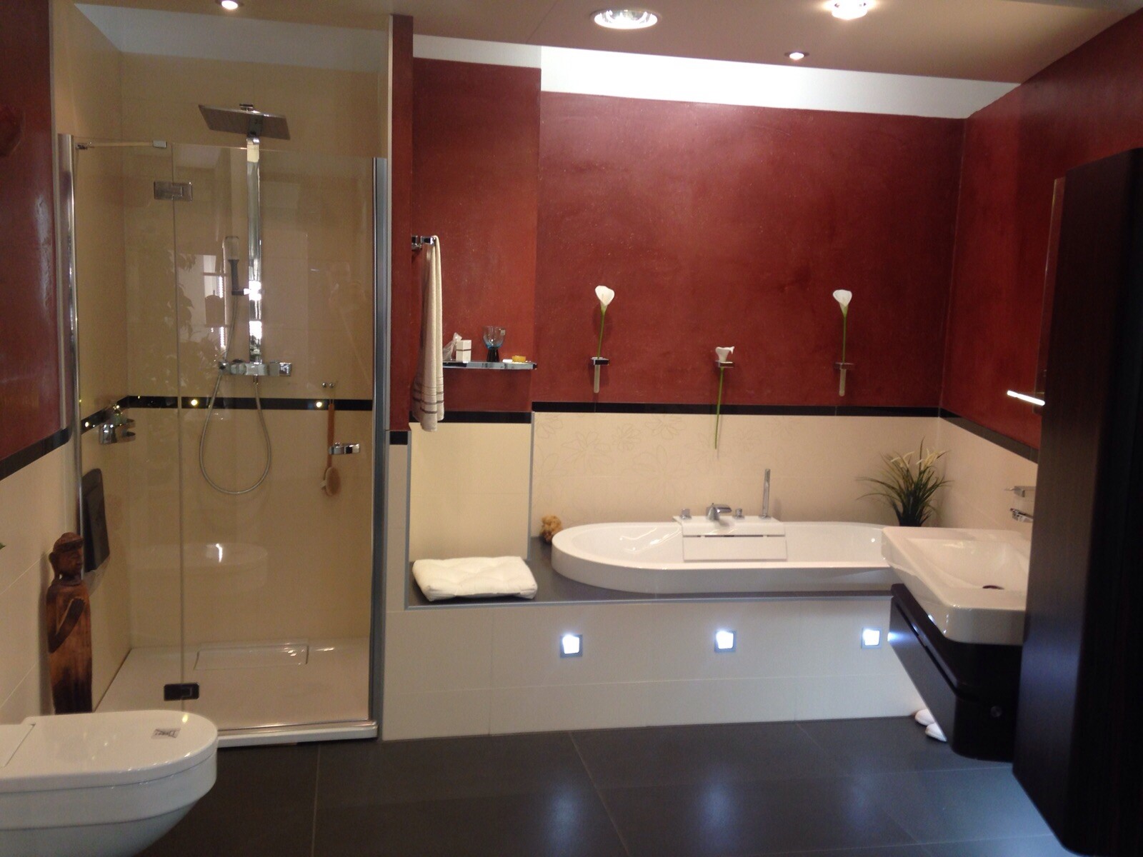

Originally, we liked this bathroom design; see the attachment. Our current layout is based on or inspired by that.
The problem is the corner I circled in black. Such a sharp corner on the shower wall wouldn’t be ideal. Therefore, there are two options for the wall design:
1) Build the angled section up to about 1.5 meters (5 feet) high to create a shelf. A cabinet and/or the towel radiator could be placed in front of the straight section.
2) Keep the wall completely straight so that it divides the space evenly between the hallway and the bathroom.
Overall, I find the angled wall very appealing from the hallway’s perspective.
