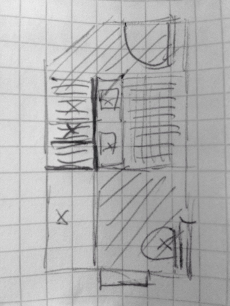

our house construction is progressing, and I wanted to share the current layout of the bathroom on the upper floor and ask for comments or suggestions for improvement.
The original idea was to have two separate washbasins/mirrors. The floor plan can no longer be changed, except the bathroom width can possibly be extended to 3 m (10 feet). There are no sloped ceilings.
Due to the narrow, elongated layout, I find it difficult to create space for two washbasins...
The long side is 5 m (16 feet), the narrow side is 2.76 m (9 feet).
Thank you very much for your feedback.

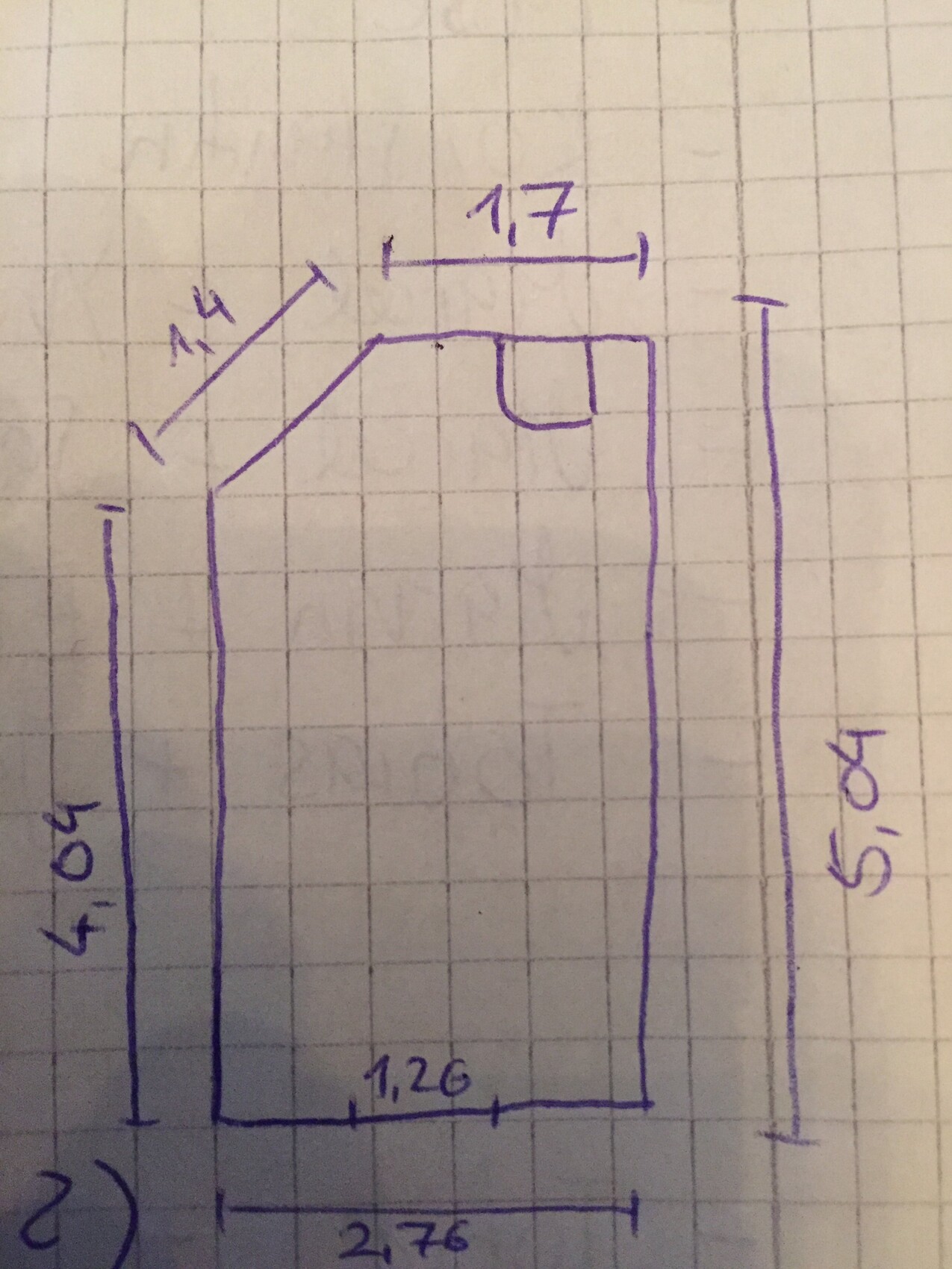

I didn’t respond earlier about the window because I thought you were asking about the window with the error message.
The window is 1.26 m (4 ft 2 in) wide, with an unfinished floor sill height of 1.0 m (3 ft 3 in). The floor build-up is 10 cm (4 inches).
The shell construction is complete, exactly. However, the walls of the restroom will be built with drywall. This means the wall opposite the staircase could still be moved to the right, but that would reduce the size of the child’s room.
Attached is a marked-up sketch.
And now that I think about it, a 1.8 m (6 ft) bathtub definitely won’t fit on the 1.4 m (4 ft 7 in) wall.

yes, with the washbasin on the right side of the plan, we are almost back to the original layout. So it can’t be that bad after all. Of course, the shower/bathtub are now closer to the wall.
I also don’t think the tile layout is bad. I can imagine doing the washbasin area floor and wall exactly the same and extending the wall upward.
Thanks for your support.
We will walk around the construction site again shortly and try to visualize the furniture in our minds. Let’s see if any new ideas come up. But the hexagonal bathtub has really caught my wife’s interest. We could also change the angle so it’s not positioned at 45° into the room...
