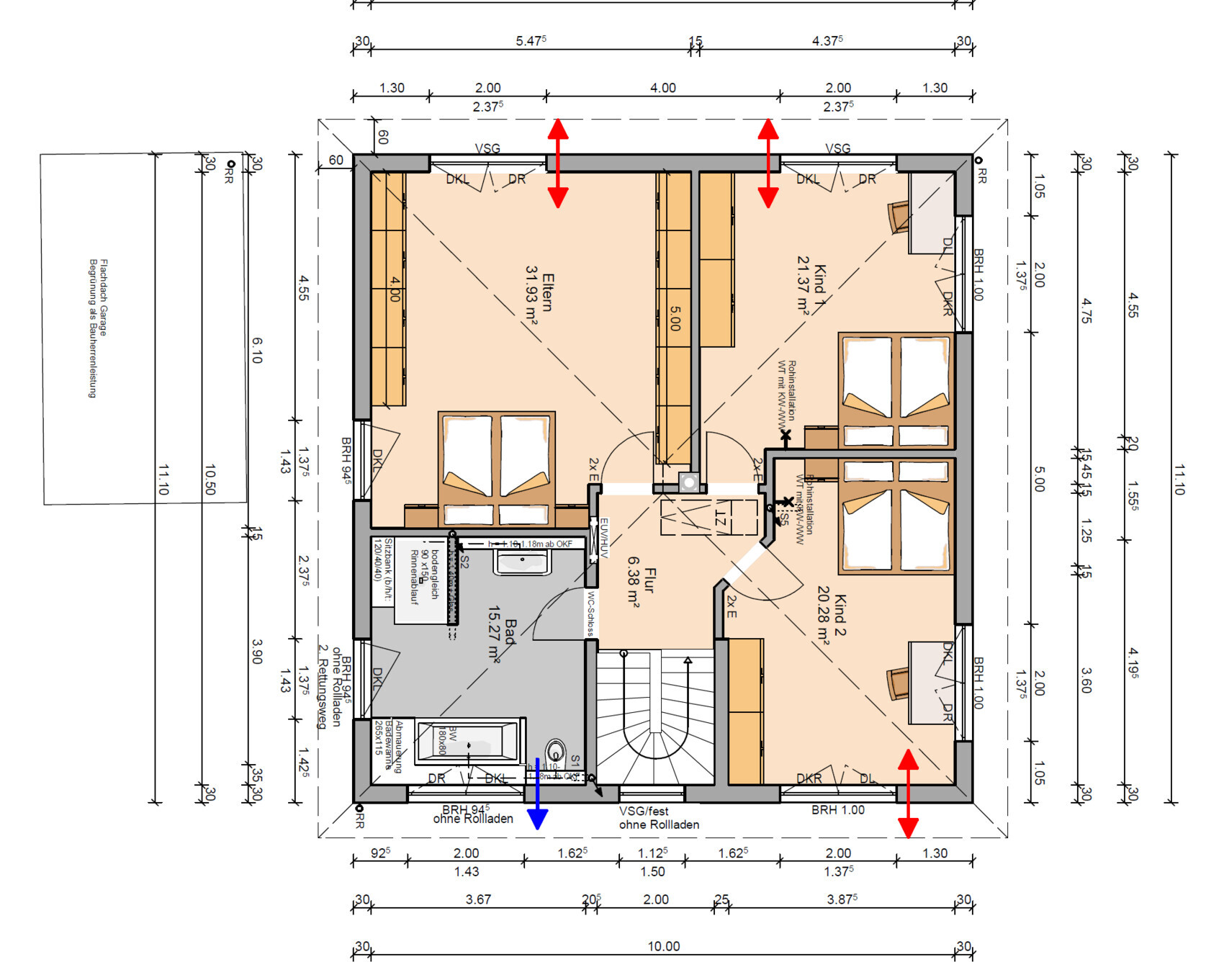

RotesDach19 Feb 2024 00:08I’m sharing the floor plan of our house to highlight the points we’re not satisfied with (north is to the left on the plan). Sorry for the delay in posting this, but with three little ones, I hadn’t found the time sooner, Yvonne:
- For the open-plan living area, in the next design I would prefer an L-shaped or C-shaped layout (somewhat like the plan by @kbt09) to create more separation for the living room. Our current one lacks coziness.
- On the plan, it looks like the entire north side and east side are filled with windows. At the time, I thought this was the most cost-effective way to achieve the panoramic window frontage I wanted. In daily life, however, the swing doors are a nuisance (when open, they extend 1m (3 ft) into the room; sliding doors would have been better) as well as the door frames. For example, I can’t easily roll the serving trolley from the kitchen onto the terrace. I had hoped for a barrier-free design here. The home architect advised us that this plan would strike a good Pareto balance between our desires (lots of glass and accessibility) and costs. Unfortunately, that’s not the case. With sliding doors, we could have had 2m (6 ft 6 in) wide glass panels rather than the structural supports appearing after just 1m (3 ft).
- I mistakenly matched the width of the open-plan area to the large kitchen line. Next time I would probably skip the big kitchen island and avoid such a long run of tall cabinets and countertops that made the entire open area in our current home grow in size. Instead, I might bring the dining table closer to the kitchen and opt for a C-shaped kitchen with a small breakfast bar. A 120x300cm (4x10 ft) island is too large. I do need the storage space, though; the cabinets would have to be integrated differently into the kitchen. But the kitchen design will only be part of the next house project. If it’s an architect, they should consider the kitchen planning from the start.
- In hindsight, we should have fully utilized the building envelope all the way to the north boundary. That way, the house would have a more elongated shape, and we would have more space on the west side. This would have allowed room for the desired double garage, which could be positioned closer to the street, and a parking space in front of the garage would have been adequately long. Looking at the plan now, I also see that the building envelope does not meet the 3m (10 ft) setback requirement on the side towards the right neighbor. This is because the plot was divided, and the old house that was demolished originally stood between our current home and the neighbor’s property. Therefore, we probably could have placed our house even closer to the eastern neighbor and gained more space on the west side. Of course, this all does not apply to any future plot, but it only dawned on us now, related to our current property.
- I would prefer the hallway to be less narrow and more spacious, more like a room (again, I like your suggestion, kbt09). It works as it is, but we have many wardrobe cabinets for five people. I would like fixed glazing on both sides of the front door. Due to the square floor plan, there was only space for one side. It’s important to me to have good views in all directions.
- The guest room (12sqm (130 sq ft)) is fine and can stay as is.
- The two offices (each about 8-10sqm (85-110 sq ft)) would probably be best located on the ground floor.
- Last but not least, the utility room is tight, yes, but we make decent use of the space with built-in cabinets. In the next design I would move laundry storage upstairs, as laundry is done there, and then the ground floor space will be adequate for everything else.
- We preferred a straight staircase. We were told a straight staircase wouldn’t fit in the layout, but hopefully that will be possible in a future, more elongated plan.
- The ground floor bathroom could be about 30cm (12 inches) longer or redesigned. When sitting on the toilet, it feels quite cramped.
- I find the upstairs bathroom layout illogical—there’s a lot of unused space in the center. I would have preferred a T-shaped layout. However, the home building company did not offer any internal bathroom consultations and were reluctant to allow us to consult an external expert.
- A children’s bathroom definitely makes sense with four kids. With two children we decided that they would each have a washbasin in their bedrooms, which eases the morning routine.
- It would be nice to integrate an attic conversion with the children’s rooms. I mean a kind of second level inside the children’s room, like a cozy retreat for reading. Roof slopes are fine but only starting at about 2m (6 ft 6 in) height to still allow space for cabinets. We had wanted two full storeys but also roof slopes above because they add coziness. Our house currently lacks that cozy feeling. Of the four children’s rooms, one should be about 16sqm (170 sq ft).
- A gallery was always my dream, but it probably won’t be possible due to cost.
- We are considering whether a communal room, like a second living room for the children, would be useful. I’m not sure yet where older kids hang out in the evening or when friends visit.
- An attic conversion could house this children’s living room, provide coziness, and function as a kind of gallery. Therefore, I wish for an attic extension.
- There should be space for a laundry room upstairs.
- Much has already been said about the master bedroom. Let’s please not discuss that here.

RotesDach schrieb:
On the plan, it looks like the entire north side and also the east side are filled with windows. At the time, I thought this was the most cost-effective way to achieve the panoramic window front I wanted. In daily life, however, the hinged doors bother me (when open, they always extend 1 m (3.3 ft) into the room; sliding doors would have been better) [...] With sliding doors, we would also have 2 m (6.6 ft) wide glass panels instead of having a mullion after just 1 m (3.3 ft). Sliding doors with a nominal width of 200 (2 m / 6.6 ft) don’t make sense due to the clear passage width, and I would have rejected them during manufacturing for warranty reasons. They are shown in the factory plan as a French door design, meaning without a center post.
RotesDach schrieb:
as well as the door frame. For example, I can’t slide the serving trolley from the kitchen to the terrace. I would have wanted this to be barrier-free. So you actually have them as floor-to-ceiling windows? (see also my post: "Barrier-free window doors thanks to low-profile thresholds").
