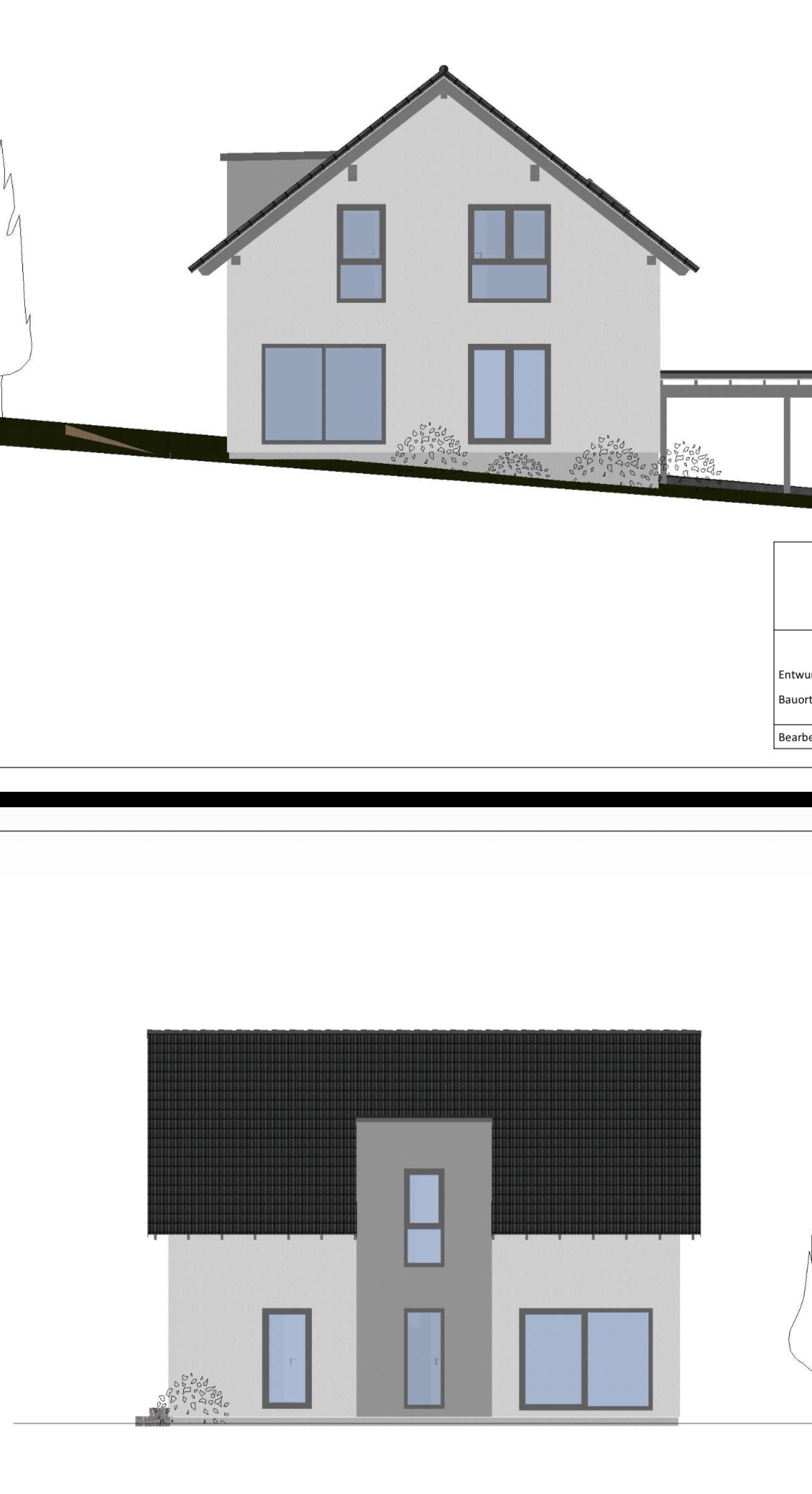

kronos21519 Mar 2026 13:01Here is the new design.
I’m a bit bothered by the rear view. Unfortunately, the dormer had to lose the wide window. Are there any alternatives visible here? We want to keep the mirrored staircase, but it didn’t make it into the design. We would probably move the kitchen island against the exterior wall and place another window next to the sofa on that same wall.
What is the general feedback on the current design? Would there be advantages if we swapped the living room and kitchen again? We are unsure which would feel more homely… Would the fireplace possibly fit back in after all? Next to or as an extension on the wall with the loft door..?
The windows have been made wider and the knee wall has been raised. The building authority has sent positive signals, but only the preliminary inquiry will confirm whether the slightly higher knee wall will be approved.

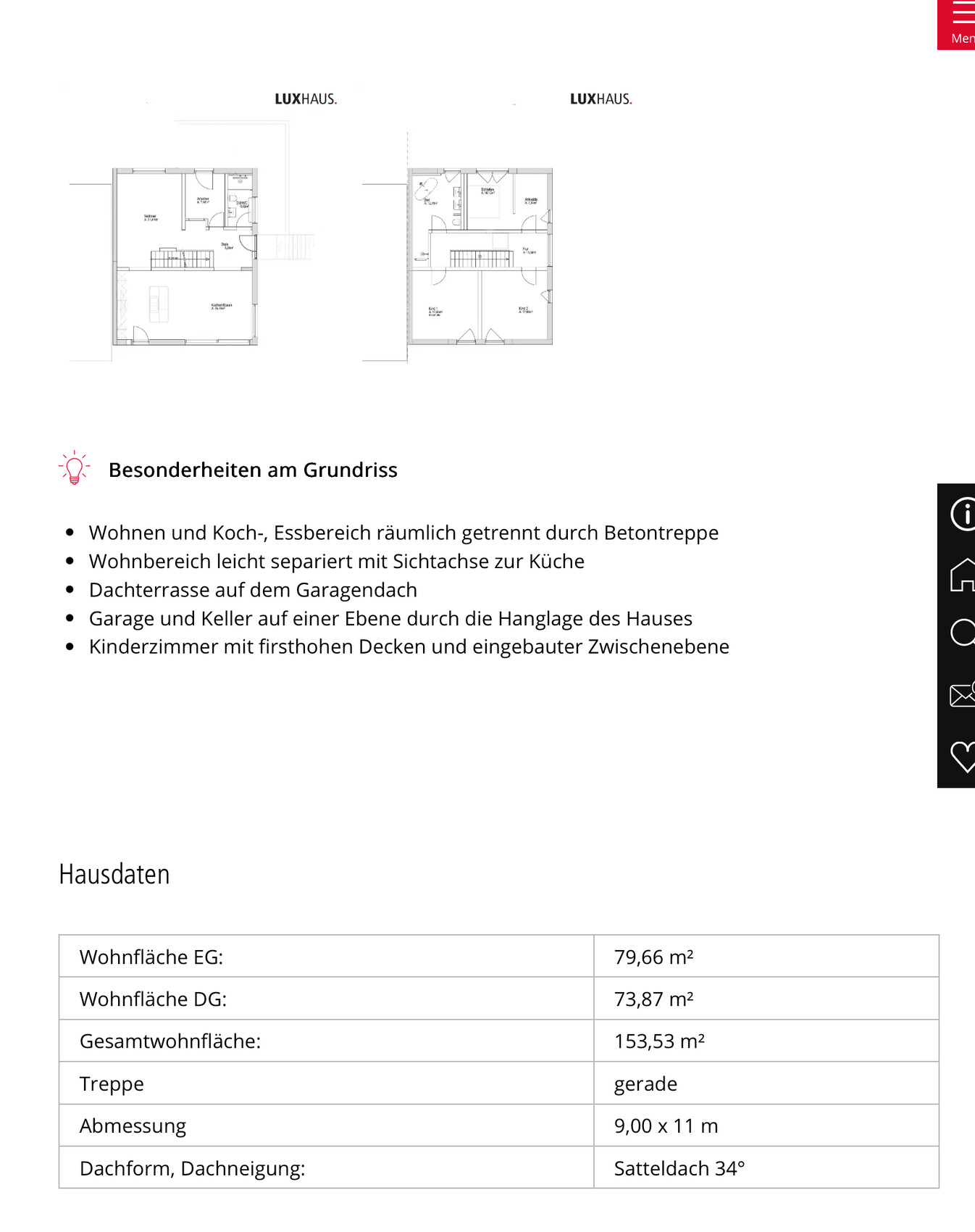

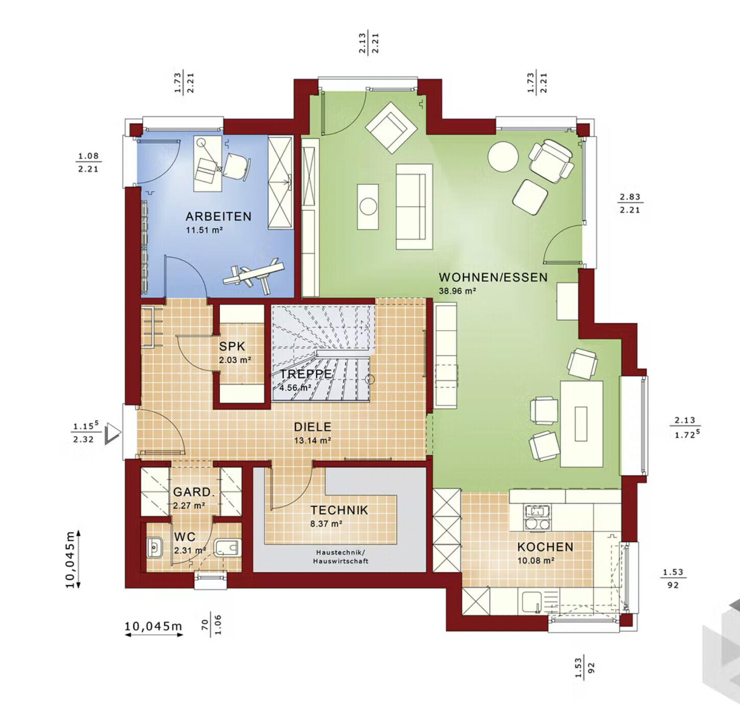

We are unsure what would feel more homey here… … for me personally, it’s very well optimized. Minor details are less noticeable. The bathroom has also improved.
Comparing it to #77 might be helpful for you. 😉
